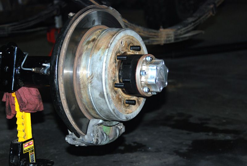

Didn't get the rear put together yesterday. Either the shafts are too long (what I'm thinking it is) or the drive slugs are made wrong, or a combination of both.
Here's a few pictures anyway.
Mocked up the rear axle last weekend, got everything lined up.
Just some welding
Housing painted:
Had the drive flange powder coated a gold color.
Problem with the outers:
Cap hits the end of the axle, wont seal to drive flange.
Munched the splines in the process of trying to get everything to seat.
Joy oh joy.

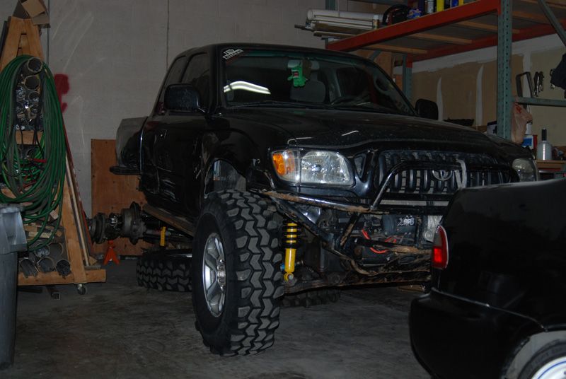

Worked through the shaft issue, came up with a fix. Not the most ideal fix, but it will work.
The rear completely assembled:
Under the truck:
Outer chunk:

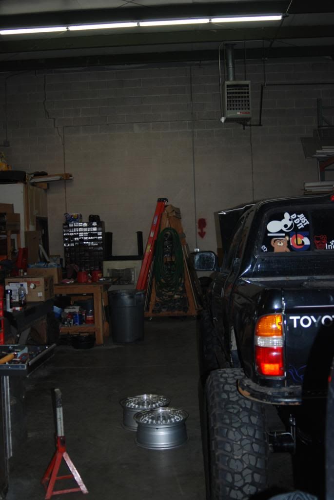

The next issue I ran into is the drive flange is actually built to a 4.220 outer diameter, where as the factory hub/spindle on the 80 rear is 4.180. This meant my OEM wheels would not fit over the drive flange, however Brian offered to bore out my opening to 4.25 to allow them to fit, which I plan to have him do since my TSL's are still 75% tread or so.
Solution -- even though they're 15's, and they were rubbing hard on the calipers, they went on, cleared the drive flange (aftermarket wheels are 4.25" center bore), and I was able to move the truck out of the shop to rearrange some things.
The tires are 35x12.5R15 KM2's, with 2" backspaced wheels. It's WIDE with this backspacing. Good thing I plan to run 4" or 4.75" backspaced racelines
And here is where the truck will sit to do the front end on it. Just need to get the frame leveled, and braced before I start cutting everything apart.

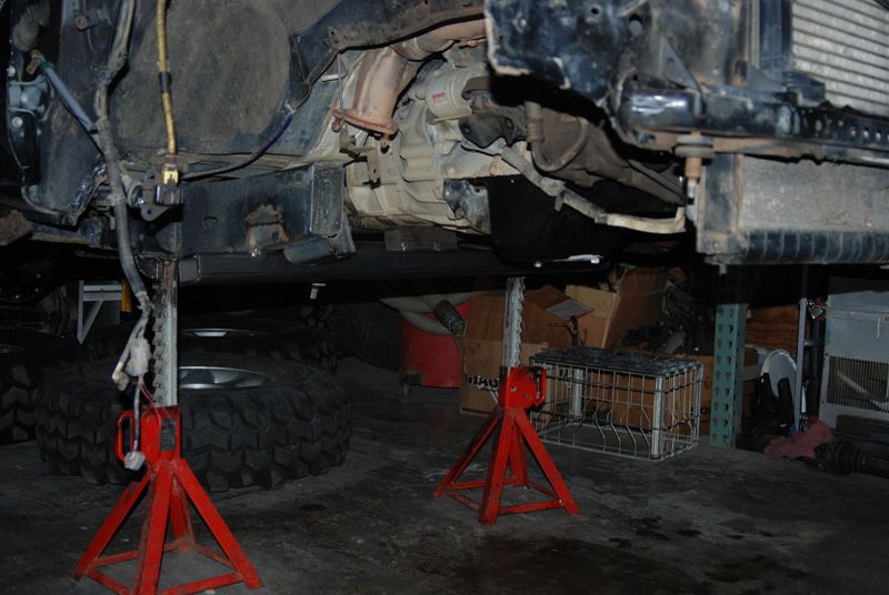

Making forward progress, unfortunately it's going to come to a hault. The cummins needs injectors, which is going to run me about 3grand. Has to be fixed too... dammit.
00regcab is offline
post #740 of 810 (permalink) Old 02-03-2013, 08:54 PM Thread Starter
00regcab's Avatar
Location: Brighton, Co
Posts: 7,910
Onto some progress pics, not much, but this is what I got done today with some free time I had. The unfortunate thing is the truck is at my friends shop about 20 miles from my house, so I burn up a lot of time driving back/forth.
Slow start to the day, finding motivation to get everything detached from the frame, get the motor supported, the 'cut mark' measured out, and squared, a few other odds and ends. But after a few hours of dicking around, i had this.
Afterwards I slapped the new pan, and pickup in. Now i feel like a :homer: for ordering the t100 dip stick, dip stick tube, etc. etc. because after cutting my original dipstick down to fit, it's cut just under the 'full' mark, so it would of still worked just fine. Oh well, live and learn.
Cant argue with free 3/16 plate .
This is what my winch will mount to, I still need to add 2 more 2x3 1/4 wall tubes to it front to back at each corner on the front piece. Then my bumper will be built off of this. I also plan to scab plate the corners, and top where it seams to the "base" of the frame.
Made the motor mounts up as well, turned out alright. Not the best, but I am happy with them.
Anyway, Sunday I picked up a friends welder and got it to the shop. Today a friend of mine got it all wired up (extension cord made), and we were ready to rock. So the only logical thing to do now, was get to welding
I got the whole front section of the frame welded, as well as both outer scab plates. I still have to do some work, and make inner scab plates, then I can get the motor mounts welded in and the front will be ready to start on locating the axle/links.
Well progress has been slow due to lack of time, and real life catching up with me. However, I manged to get a few things done this weekend. Nothing great, or even a huge step, but figured Id throw in a few more pictures. Everyone likes pictures right?
Got the body re centered and bolted back down to the frame after the body lift install, threw some panels back on the front to scope out how it would look, got my front rad support mounts made and 1 slider cut off/frame ground down so I can plate it.
Tuesday I will hopefully have time to get more work done on it.

post #744 of 810 (permalink) Old 02-07-2013, 06:28 PM Thread Starter
00regcab's Avatar
Posts: 7,910
Originally Posted by Mythica View Post
awesome!
What were you holding the motor up with?
The piece of 2x3 that was welded underneath the frame rails had the motor resting on it, until last night anyway.
Heres where I'm at now.
00regcab is offline
