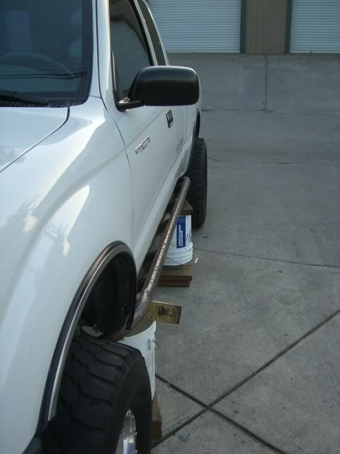

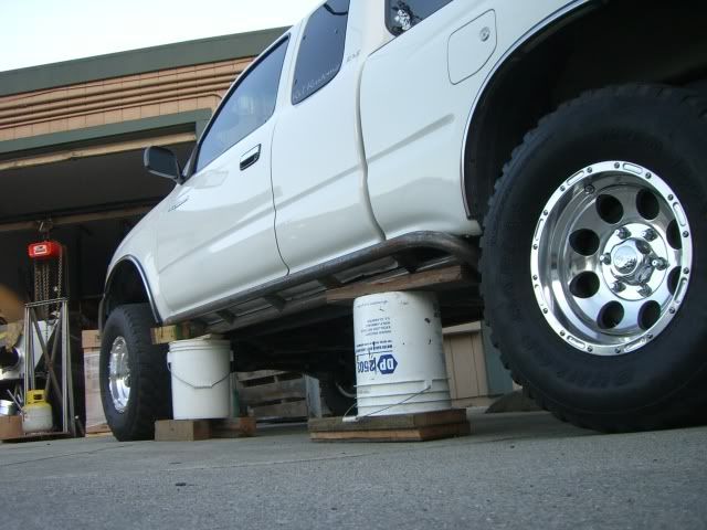

Update!
I ditched the square design and opted for some round tube sliders. Props to Anthony (Davis3000) for bending the pipe and nothcing it with me.
All the spacers had a notch on one side. I had to make a template, and copy it to the other side. Then I cut it out with a bandsaw, which then I grinded it with a angle grinder to get it to fit nice to the pipe. To do the template and all the notching, took 3 hours.
I tack welded the inner piece and left all the spacers free. All I have to do is bring up the Cad, measure out the distance on the spacers and tack weld those. I can then fully weld the sliders
Then I can drill the brackets that I ahve bent up and tack that to the legs. I can then tack the legs to the sliders and finish welding. Then Rattle can will do the rest of the job.
It turns out that the 1" body will not be nesecary since I cant weld the legs higher up on the frame (Bolts will be in the way). I will not install the 1" body lift with these sliders.

Lookin good. I'm wondering about the 1" BL though. Got any pics of the frame attacments?

It's enough step for my gf. It's much better than her sticking her leg in my cab and me practally having to pick her up to put her in the cab. I've actually had to do that a couple times when she was tired.
Dick, it's going to attach with your design. I had my brothers company bend up the brackets. It's 1/4" cold steel.
I may work on the other part of the notching today if I have time. If not, tomorrow I will, and I will also drill the brackets and weld those up. I'd work on it Sunday, but it's prom.
Sunday I will be working on them more for sure. Expect more pics, hehe. I'll take a shot of the clearance, but it clears just fine. The inner tube just has to be sticking out more form the pinch weld. It's offset .875" (The edge of the bar is with the edge of the pinch weld)
Dick, I think your design had 79" or so for the legnth. I originally was going to do 81, but the bender put it at 84" OD. This is the perfect legnth.

Then you shouldn't need a body lift because mine doesn't have one. The length was so as not to crowd the sheetmetal and I think it had to do with the cut schedule for the standard length stock I was using.
I'm a cheap bastard that way. Sometimes I'll spend an hour just planning all the cuts for a sheet of plywood so as to leave nothing but sawdust and usable pieces.

They look awful tight to the body. Do they stick out far enough to protect the widest part of the truck?

They aren't attached as yet. Those are just pics of a work in progress.
