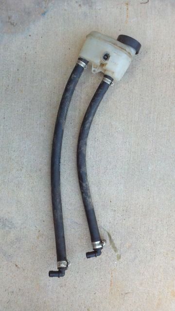

First, let's start with the brakes. So during king of the hammers I hucked my truck and landed with the brakes on (DO NOT DO THIS). This caused my truck to bottom out even harder. The only apparent damage was my radiator was moved in a bit and my coilover to resi fitting broke. I was still able to drive it home but as I'm driving it starts to feel like my brakes are getting worse and worse. By the time I get home I barely have any brakes at all. I take a look at the brakes and this is what I find
My UCA had put a dent in the brake booster. I've heard this isn't a problem but I didn't see any other reason why my brakes would be bad. I try replacing the master cylinder first because replacing my booster involves me cutting out my bypass mount but that didn't fix the problem. I sacked up and cut out the bypass mount and it barely squeezed out
I get everything back together and test it out and FML they still don't work. I'm stumped. There are no leaks anywhere and all the calipers are getting fluid when I bleed. I adjust my proportioning valve to make it full open so my rear has max brakes and I can lock those up so I eliminate the rear being a problem. My next guess is that by landing with the brakes on I messed up the front calipers somehow. I decided to switch calipers with a buddy to check that. As I jack up the truck I notice that the passenger wheel seems kind of loose. I rock it back and forth and notice it is loose at the wheel bearing. BINGO. If the wheel bearing is loose than the wheel will wobble as it drives so when I try and brake the disc pushes the caliper pads in and out giving the feeling of no brakes. I pull the hub cover off and the nut is partially backed out up until the cotter pin caught it. If there was no cotter pin it most likely would have back all the way out and been really bad. I retightened the wheel bearing and took it for a drive and my brakes go back to normal! It only took 3 days of work and 300+ in parts. hopefully some one will read this and not make the same mistake. Once I saw the dent in the booster I got tunnel vision and had my mind set on that being the problem

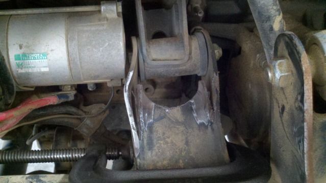

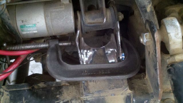

I had to fix my motor mount. not sure why but the welds completely failed causing the mount to split
I was able to C-clamp it to close the gap a little then I welded back up

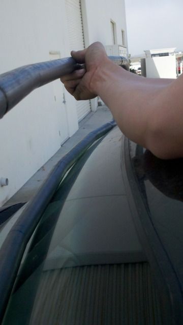

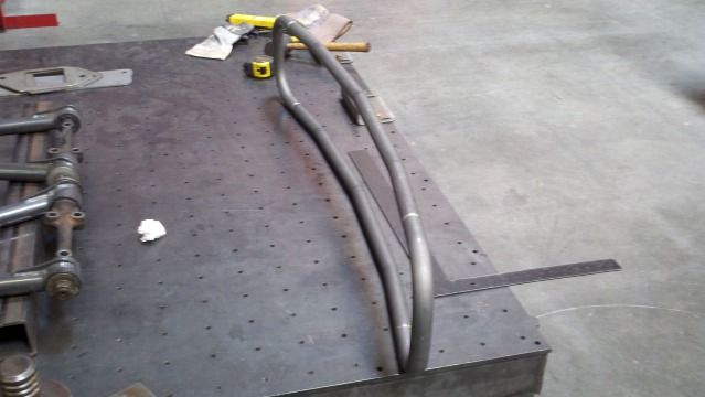

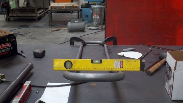

Since I don't have a bed I want to make a roof rack for gear. The plan is to have really low profile rails and then make a dettachable rack. I only got the rails done this weekend
The rails land on the roll cage at the A&C pillar junctions
Lastly, I bought 4 new red ring 55 watt HIDs (2 spot, 2 flood) so I can put them in a light rack that goes just above the windshield. Heres what I drew up and was aiming for
I wasn't so lucky and the die I wanted had the wrong radius (3.5" instead of 4.5") so I had to put a 2" gap between the 90 degree bends but it still came out good. I still need to add the verticals
making sure it wasn't warped
It matches the windshield perfect
I orginally planned to have it attached to the roof rack but it's too far away so I'm not sure how to attach it anymore
The truck is basically ready to go again. I just need to do a prep and enclose the fuse box.

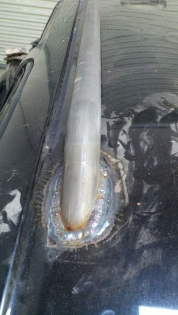

This is how I mounted rack to the cage
I added the vertical bars to the rack and blended the weld between the sections before I mounted it. I need to redo the the piece that goes from the rack to the cage attachement and redo the center adjusting link. I had to bend it to clear the antenna mount. When I redo it I will mount it a little lower
