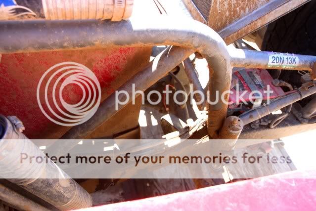

I think that's why you didn't break the truck and it rolled across the finish line. If you had all the money you wanted to race you would pull a Robby Gordon and snap something so bad you would DNF.
I can see the dirt scooper in your picture right in the center of the front skidplate.

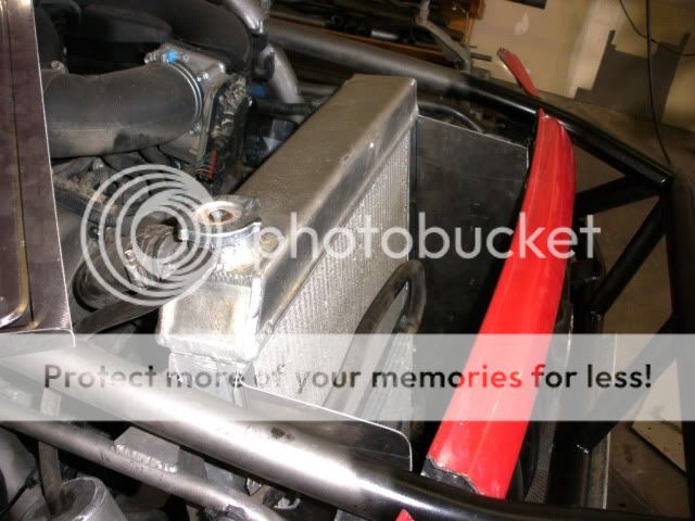

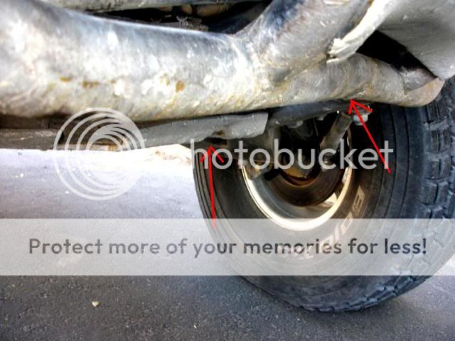

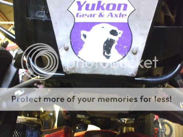

Well got started on the truck after hours. This first pic is the bumper after the last race. I should prob get a better pic to show how bad it looks in person, but its hard to see through pics. The red arrows point to a gash in the lower tube and the crossmember. The lower tube was sleeved to be 3/8in thick. The rock face we hit pushed the bumper back about an inch and put a 1/2in dent in the tube. The crossemember has a 1/4in thick aluminum skid plate and the rock went through it and into the steel crossmember about 1/8-3/16". Doesnt sound to amazing, but it looks gnarly.

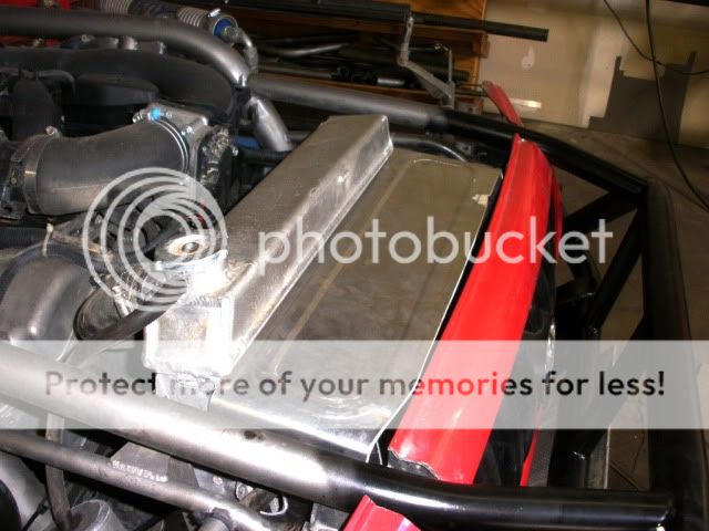

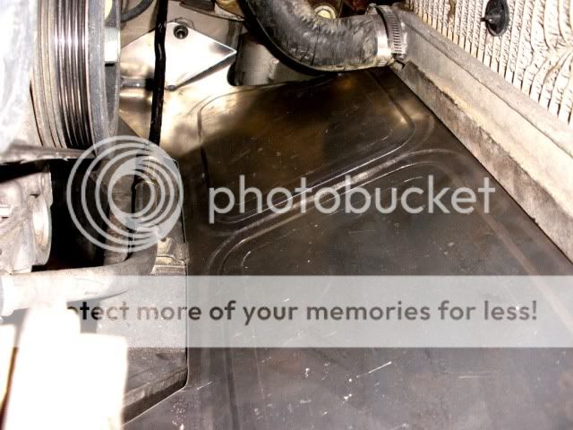

One of the biggest issues weve been having with the new frontend is that the belts on the engine keep jumping off the pulleys and its a pain in the ass to put them back on during a race especially with the engine being so damn hot. Its been suggested, and ive finally agreed, that its the front bumper scooping gravel up into the pulleys and causing the belt to jump. We cant re design the bumper because its tucked as tight as it can go while still protecting the steering. So Im going to make a new skidplate that wraps all the way under the bumper to try to stop gravel from getting through. Ive also made a new rock guard that will be a secondary block that is between the front steering and the front of the engine.
Top view
And last race we also overheated when the fan went out (destroyed all the motor brushes). We had to go at least 30mph to get the rad to cool (which is hard in the rough sections of barstow). So ive decided to add a scoop or ram to force air through the rad so hopefully we dont need to be moving very fast to get the cooling.

You would benefit more from having a shroud around the fan on the inside, Toyota motors are a pull system, which means they need to suck the air in. Without a shroud your loosing alot of your cooling capability.

I think you looked at an old pic of the mechanical fan on the 3.4L. The 4.0 we have in now doesn't have a fan. We were using a Ford Taurus electric fan and it does have a shroud. We are going to try a different fan though because this is the second Taurus fan that we've broken the brushes inside the electric motor. When our fan went out on the 4th lap, it really hurt the free airflow through the rad. So with a scoop on the front, even if our fan goes out again, it will help force air through and keep us cooler. After the race we pulled the fan off the back and ran the truck all day Sunday hard and we didn't have any overheating issues.
yea i didnt even see that, i saw the current pics and thought you still had the 3.4..
have you looked into SPAL fans?

Just looked at spal fans and if they hold up well, we will prob go with the 16" straight blade that pulls 2300cfm.
We really wanted to get a brushless fan, but all the aftermarket ones ive found are in the $300+ range. Which is too damn expensive especially with our history of breaking stuff haha

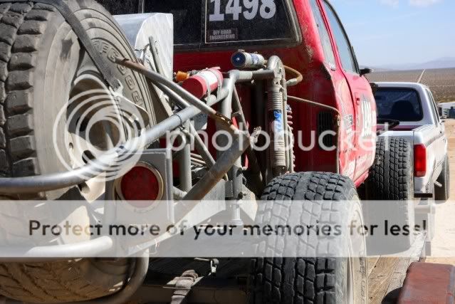

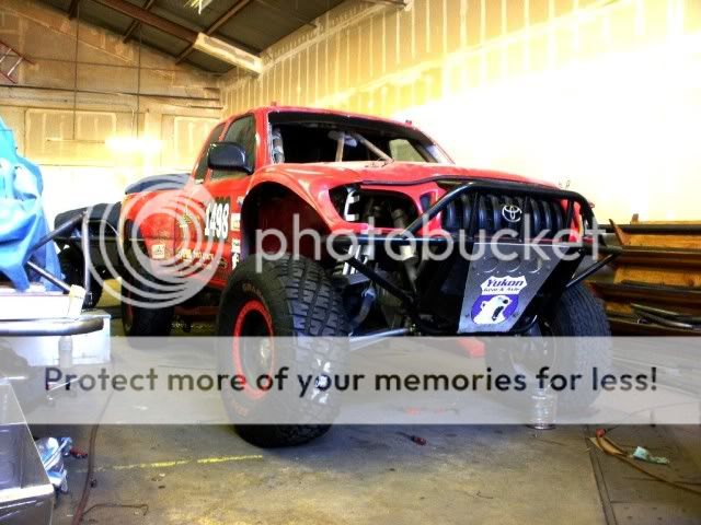

The truck is almost prepped but i dont think this truck will ever be loaded up on the trailer fully prepped. It will always be finished up on the trailer or in the des before the race haha. We are gonna try running a bmw fan with a bosch motor. A buddy is a bmw mechanic and the low speed module went out on on a fan so he gave it to us. He told us to just wire it direct for high speed and says itll last forever, so were gonna give it a shot.
Last race the truck was way smoother on valving but there was a little more that could be done. We were surprised though that even when we would run the truck for hours and then through some rough terrain at race speed (on sunday) and then instantly check the top cap temp with a laser gun, all the shocks were around the same temp. Rear bypass and coilover were between 180-195 and the front co was 200 and bypass was 150. Ive gone through and revalved all the shocks, limited the rear bumps to 2.5" travel, and dropped the bump psi from 200 to 80 (dont know why i didnt drop pressure sooner). I think this will keep our rear down more and be less likely to stuff the frontend. Ive also put more valving in the front bypass and takin some out of the coilover to avg there temps a little closer. I think the front byp runs so cold though because it has all the direct airlfow.
We finally went back to a rubber carrier bearing before the last race and ALL of our vibs went away. It drives like a regular car on the street now. Im still worried about the rear slip not slipping fast enough and pulling and pushing the trans slip in and out though.
Before last race we finally got a trans temp sensor on and found out the lines to the cooler were backwards (OOOOPPPPSSSS). Truck always drove so we never thought there was an issue, but the temp got up to 230 when we test drove out at the race. We swapped the lines and without the fan off it would stay under 180 all the time and with fan on itd never go above 150 during the race. After the line swap i had to adjust the fluid level and i looked at the fluid and it was all still bright red so i dont think it got burnt too much. Also with our old 4.30 gears, our 3rd gear would top out at 75-80mph. We have cut the wire to the trans lockup since then and put in 5.29 gears . . . . now it seems like 4th gear tops out at 82mph and it wont go into 5th WTF?!!! So we are taking others advice and putting the lockup wire on a switch and well see if the next race we can push to mid 90s or even into the 100s. I know the last 4 miles of this marked course we could hit mid 90s with the 3.4 and supercharger, so i dont doubt we can hit that again or higher if the track is close to the same (maybe it wont be).
Went through and also replaced all the heims and unis that were just flopping around without liners (like ALL the steering heims haha) and I will be cleaning up stuff here and there that was tossed together in the des.

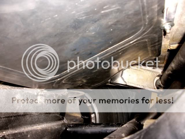

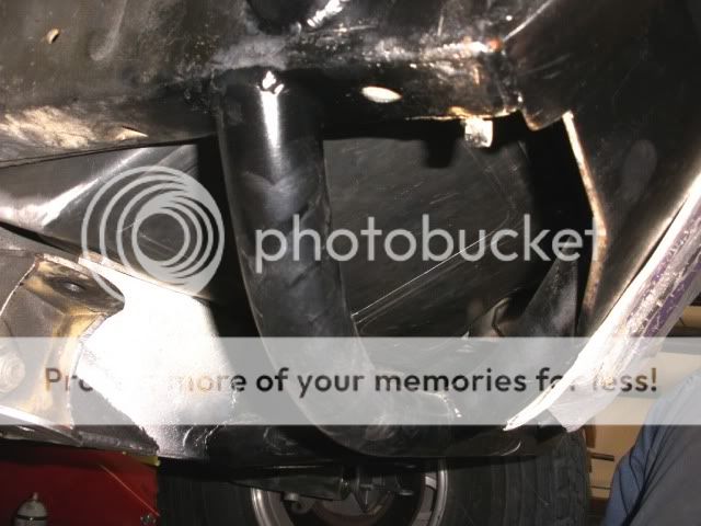

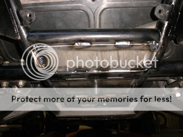

I ended up making it a steel bash plate like i made in front of the steering box. Ive replaced the lower tube since it was destroyed at the last race (it was a 3/8 thick tube) so the new one is solid in the middle. I used the steel bash plate to tie the lower bumper into the front crossmember so nothing should move now. I only welded sections of the bash plates so they can be cut out later somewhat easily and replaced. The lower plate has vertical ribs on the topside to keep it from bending. Still gonna leave the side open for the steering and well see how it goes. I dont want a plate to cover the steering, get bent, and lock everything up.
Also made an aluminum visor
Were gonna try out some booties on our high wear heims and see if they last longer or if the booties just hold in dirt or get chewed up

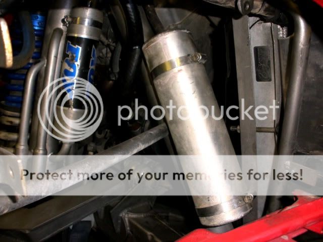

And heres our overflow now. Got rid of the monster can cause rocks from other vehicles kept putting holes in it. Id like to make this much larger though and hold about 1 gallon.

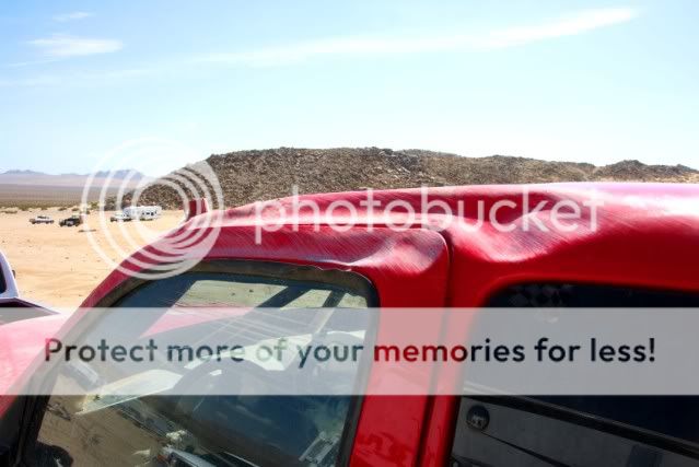

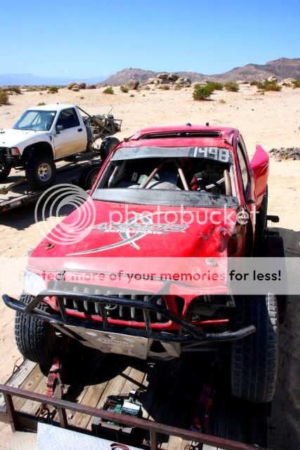

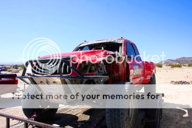

Well the race went awesome for 4 laps and then not so awesome. Our plan was to hold back since our siren stopped working in the starting line and we didnt want to do any dangerous passing that could break the truck, but it was just so easy for the truck on this track. We started almost last in our class off the line but passed 3 trucks in 3 miles and passed 10+ MORE in the first 30 miles. By MM30 or so we were in 2nd place and only physically behind a couple trucks. We had to pull in for a quick check on our tires at the end of the first lap because the truck was pulling slightly to the right. We didnt know until later on that it was because the driver side bypass had lost pressure and was shooting oil out of the bypass valve.
Truck still ran fast and we were trying out the 5th gear switch that i hooked up. We tried holding back some to try and get better mpg and take it easy to not break down. End of 3rd lap we went in for 10gal of gas and codriver swap and didnt have any issues and the truck was doing awesome. We were losing time on 1st but figured if we kept it smooth he might break or get a flat at that speed and we could pass him in that time and let him try to push it to catch back up. But my estimate on mpg was WAY off. I thought that the mpg would be around 7-8mpg but we were really running at 4-4.5 mpg. I couldnt get the fuel gauge to work so we didnt see it coming, but we ran out of gas at MM9 on the 5th lap. It was one of the furthest remote areas on the course and took us over an hour to get fuel in the truck. Luckily a MORE spotter (think his name was randy) drove me to the dry lake bed to bring our chase truck into us. I dont think they would have found us without his help. We fueled up and ran to MM24.5 to get another 12 gal from Mike Fox's chase truck and make a run to main pit for another quick 5 gallons.

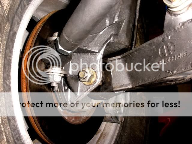

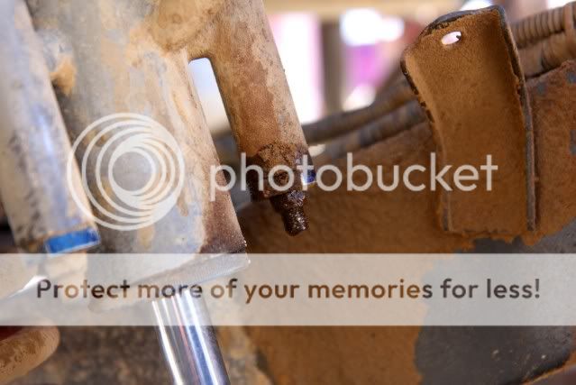

Unfortunately coming through MM39 we were going about 100mph and the studs broke off on the driver side front. Tire took off and the truck started swapping sides. I was able to keep it under control somewhat and we ended up drifting for about 120-130yards. We must have slowed down to around 15mph and almost saved it, but hit a bush on the front right and left rear went into a dip. Not much, but enough to put a sideways truck on its lid. There were some spectators close by and in only a few minutes they flipped us over and drug us off the course out of other vehicles way. We did have 1 good stud and 1 bad stud still on, so we put on a spare tire and drove it 1/2mile to finish up the lap. Other than the broken studs (have already been fixed) and body damage, the truck is in good shape and should run race speed. We are probably going to upgrade to 5/8 studs. Im pretty sure they broke because the nuts were loose, but larger studs will hold up better . . . i hope. So well see if we can re-glass the fiberglass, and figure out what to do with the body, but we will be racing again soon. A HUGE thanks goes out to Mike fox and his team for helping before and during the race. Wouldnt have done so well without them. Glad they were the ones that STOLE 2nd from us haha. And great race to Byma and Hopfe for running so fast. I dont know what happened to Hopfe to not finish, but Byma ran a great race and didnt seem to have any hickups or delays. And too bad Aguis was having engine problems first lap (i think that was what i heard).
Blown bypass. Took it apart today and the allen bolt to the bypass was broken inside and the two o-rings were blown through. Also saw that the rebound valve loosened up 3 turns somehow, but it wasnt leaking.
And the body damage.
socalmoto is offline
