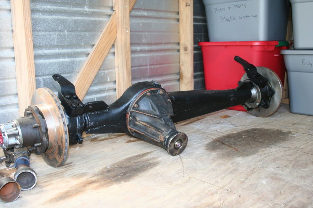

Ok guys.... It's time to spend some money.
I already has a leak from the drivers side of my rack. Then on the Sweetheart Run last month my Driver's side CV started sounding like Jiffy pop when crowded in either direction. I then realized i had a hose clamp off on one side and a busted boot on the other. So.. instead of spending money on repairs.. i decided to rip all that crap out of there and go SAS.
so, after the last 2 years or so of browsing around and reading build threads... i am finally gonna go for it.
So, i already have an axle... now i am shopping for my other stuff.
The axle came from an 85 Yota, it....
..has been flipped for driver side diff drop so i can put it on my Taco
..has been armored and reinforced
..has 5.29 gears
..has disc brake rotors already installed
..has Asco Hubs
..has Marlin High Steer Arms
..was originally set up for a coil over setup (mounting eyes install) but i will have to change that to some spring perches.
On the way to my house right now is a FROR Tacoma Spring mount kit and a third member with 5.29 that i will be putting in the back.
There is a possible used IFS box i may be getting.
A call to Alcan Springs on monday morning with a few final measurements will get the ball rolling on my springs. I will be going with 6" of total lift so i had to get all the other measurements right so Alcan can make the springs like they need to be made.
I have been talking to the guys who will be doing the install and what we are planning is to get everything installed then use his lift to flex it out.. then measure out the proper length for the shocks. So i can get the best possible flex out of it.
There are a few more things i need... and a few more things that i want. But it's all coming together.
I am getting the install done at Searchers 4WD in Prarieville, LA.
Will update as things happen.......

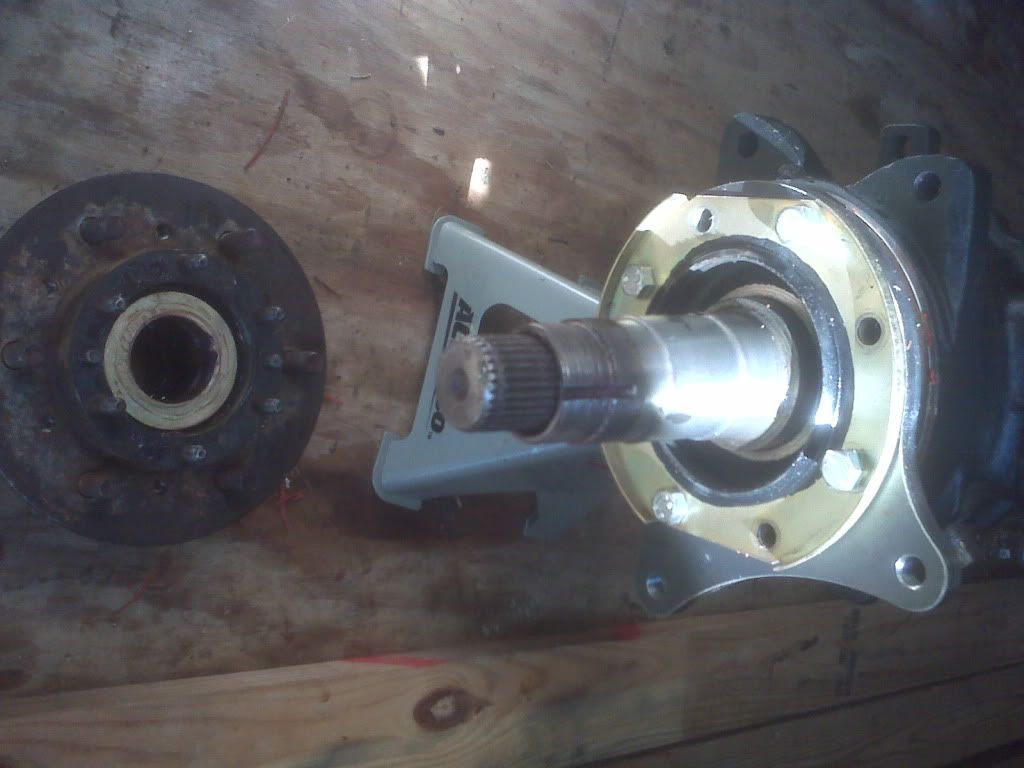

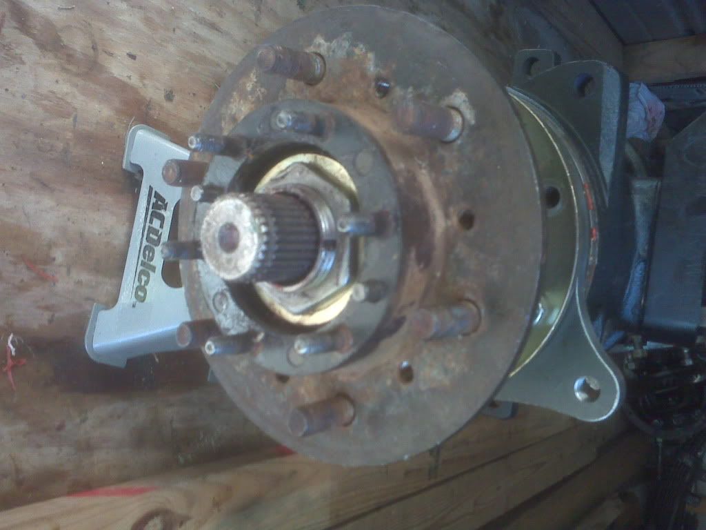

So at the end of last week i pulled the knuckles off to prepare for the FROR brake mounting kit so i can keep my Tacoma rotors and calipers up front.
The kit should be in the mail headed my way, along with some IFS hubs and lockers.

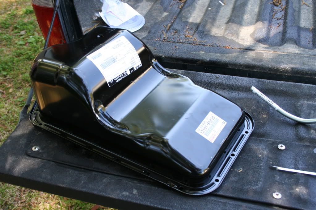

and my t100 oil pan and accessories listed here:
T100 2wd oil pan # 12101-65030
T100 2wd oil pan pickup tube # 15104-62060
T100 2wd pickup tube gasket # 15147-62020
T100 2wd dipstick # 15301-62060
T100 2wd dipstick guide tube # 11452-62060
T100 2wd union # 90405-10033
got all this stuff from toyotapartsales.com.

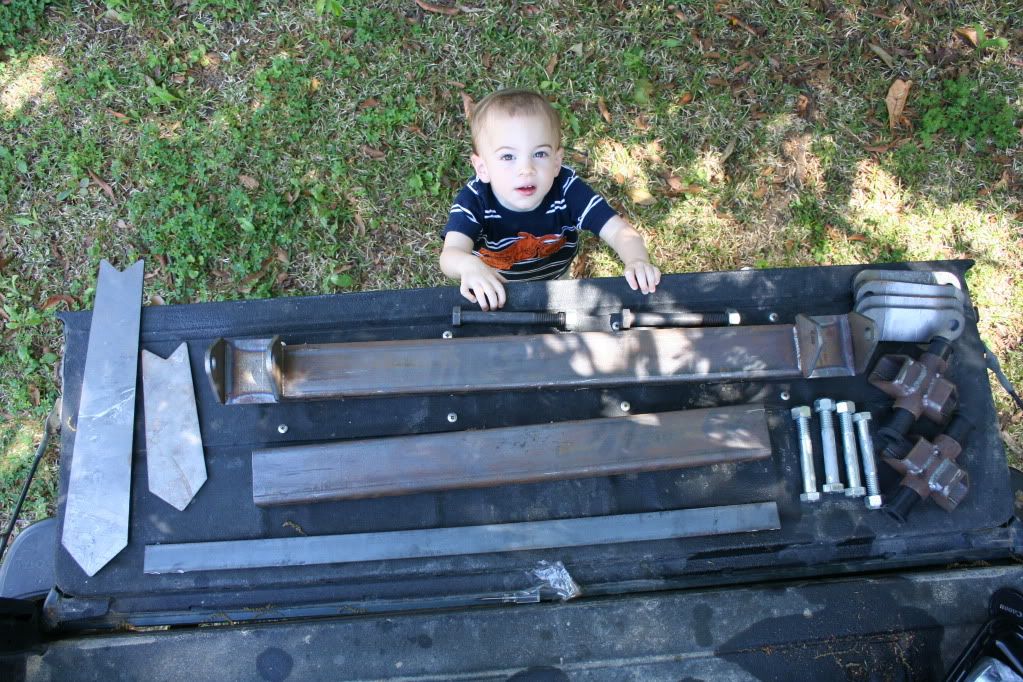

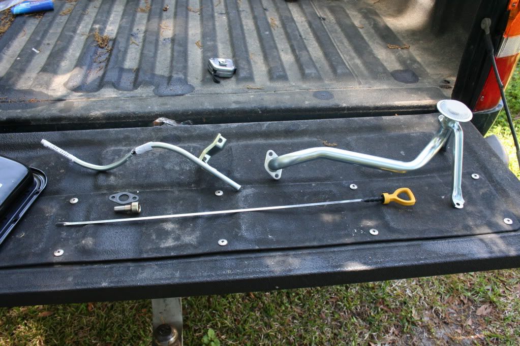

here is a few shots, First the FROR hanger kit.
then, the t100 oil pan and parts..

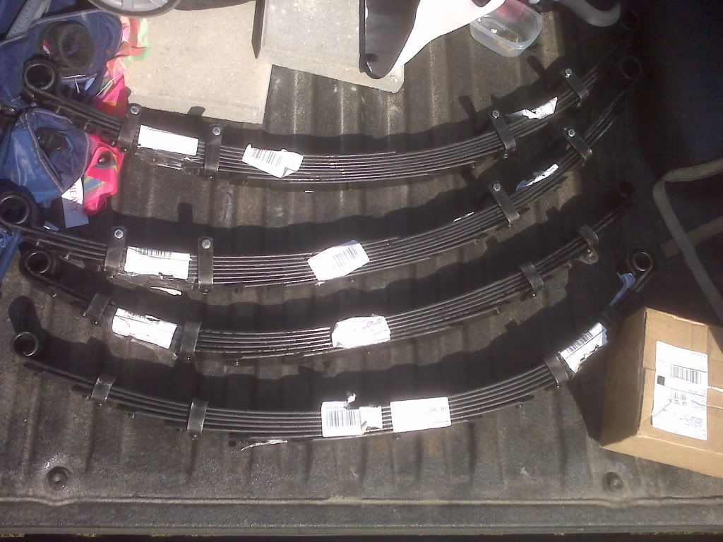

Originally Posted by goofballtech View Post
Got the call earlier this afternoon. My Springs are done and should be either already on a truck or loading up tomorrow morning.
And here they are. Loaded in the truck. Will get some more pics later on. This was just throwing them in the back of the truck and snapping a shot witht he blackberry.

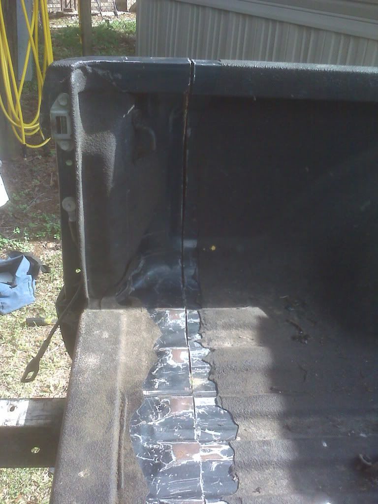

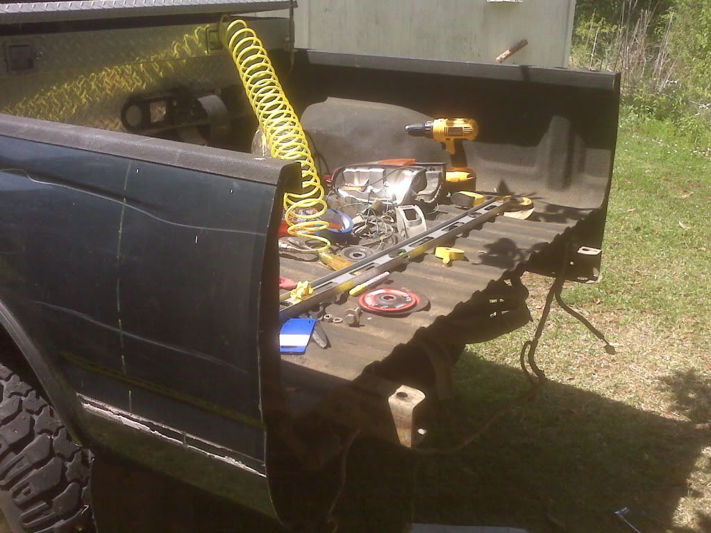

So, i was home from work today and decided to do something to the truck... figured it was a good time to bob the bed. I got a good start but my buddy who normally does welding stuff for me ( i have no machine and can't weld for crap, though i am trying to learn) was busy so we'll stick it together properly tomorrow after work. Got 11 inches cut off and got it fit back together pretty close.
First cut made
Second cut in progress...(Drank so much red bull my truck has wings... )
Pile of stuff....
Inside of seam...
Side View....

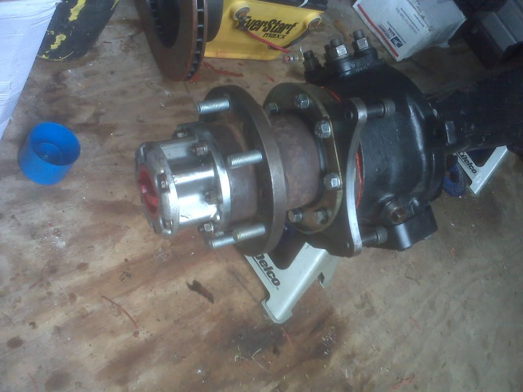

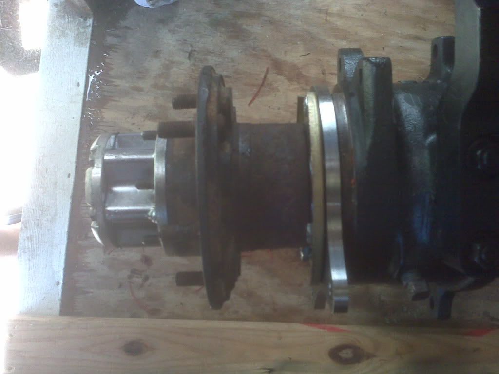

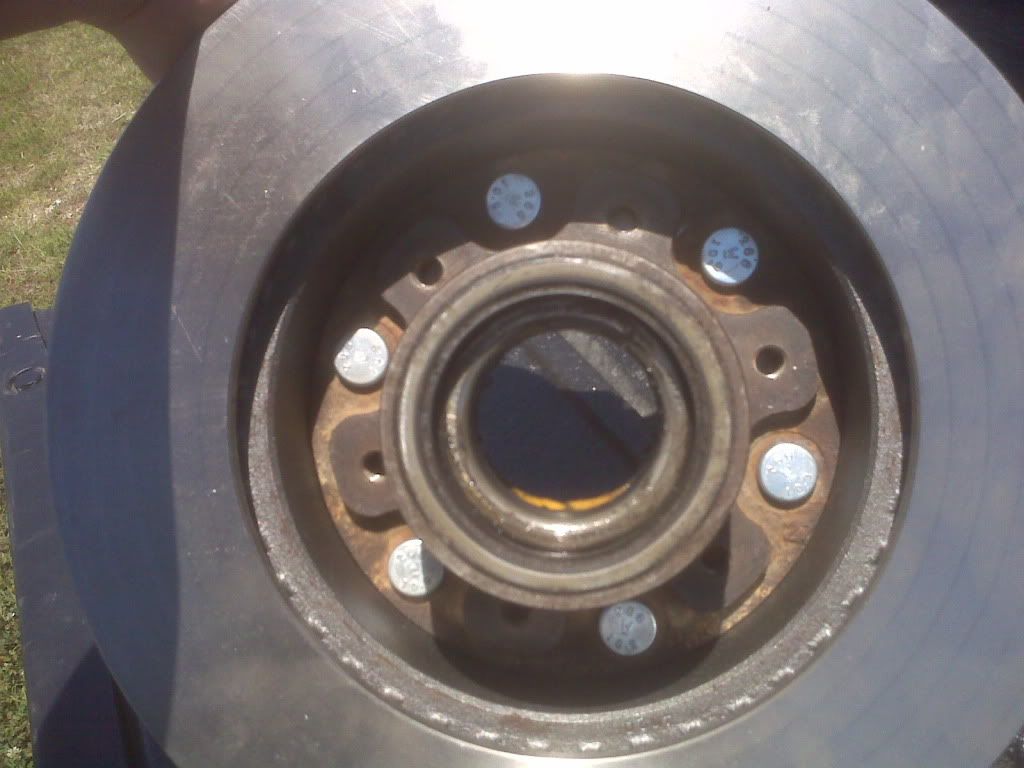

Been mocking up my brakes today.
Haven't put all the bolts in yet because my RTV isn't nearby and i haven't yet had the hubs turned down yet to accept the rotors. here are a couple pics of a few bolts in to hold everything.

A few more pics... just because.
Turned down to fit the rotors and got some new Bling.
Might give them a little bit of wire wheel loving later on too.

About a month ago i got bored one day and decided it was a good time to bob the bed. So i busted out the grinder and lopped 11 inch off the back.
Finally got a little time to do some work on my axle.
Got the 4.10 third put in yesterday afternoon and today i put the knuckles back together on either side.
I just got my u-bolt flip kits in so i plan on putting my new springs on the back of my truck one day this week so i can get my 3" lift alcan springs over to Kigmob because he's patiently waiting for me to get them off of my truck.

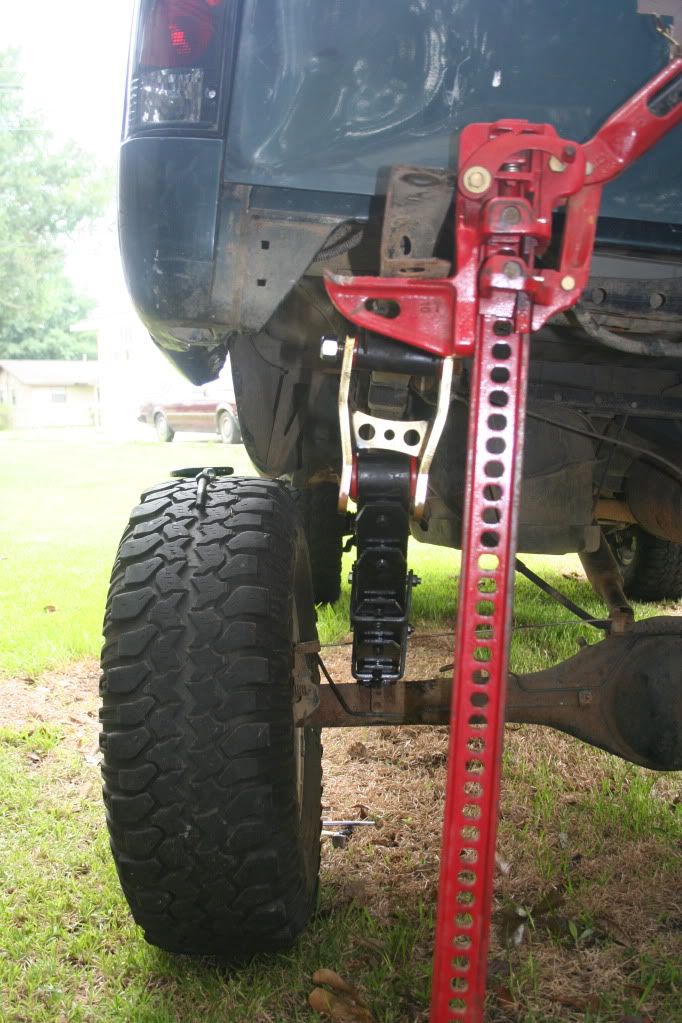

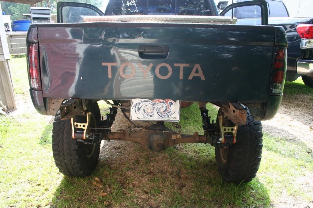

I finally got the chance to put my springs on the back. here are a few shots.
What do you guys think of the shackle angle? These are the shackles i got from alcan when i ordered the springs. They are certainly good and stout but seem a bit steep to me.......
