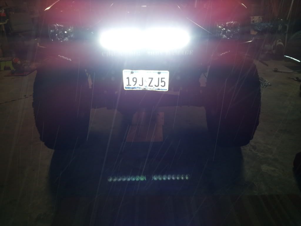

Pics of the Alpine HU and front lights.

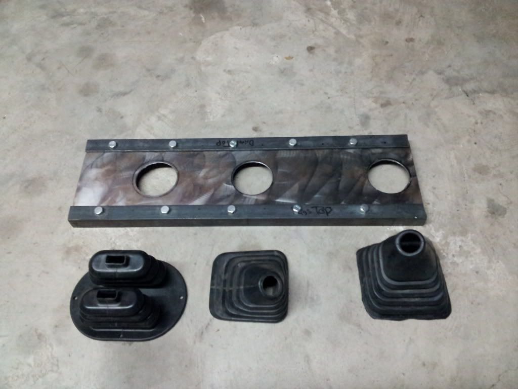

Got my crawlbox sealed up and ready to go.
Davez shifter
Rear case asembled with the Davez twin sticks

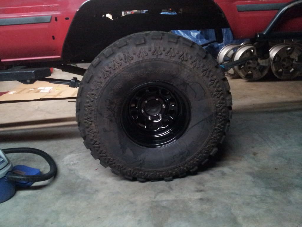

Both rear wheels mounted and installed back on the truck
In the black wheel club for the second time
Got the spare and front 2 wheels mounted today
Should have them all back on this evening.
No more bent wheels for this guy...Hopefully

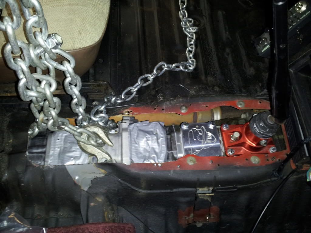

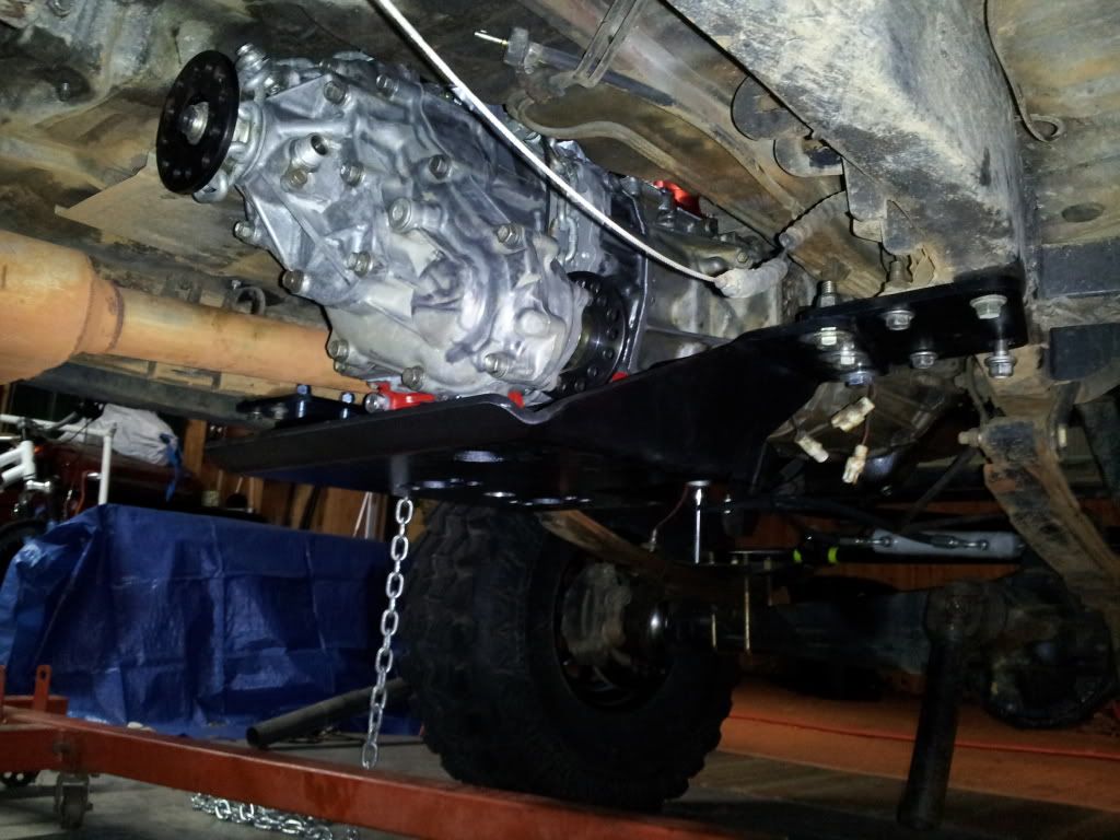

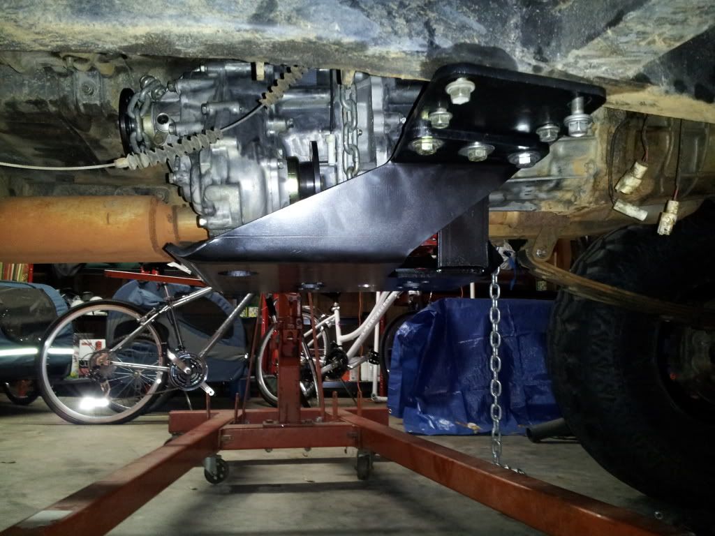

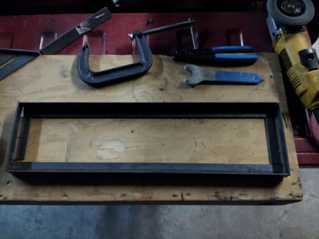

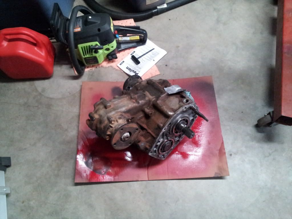

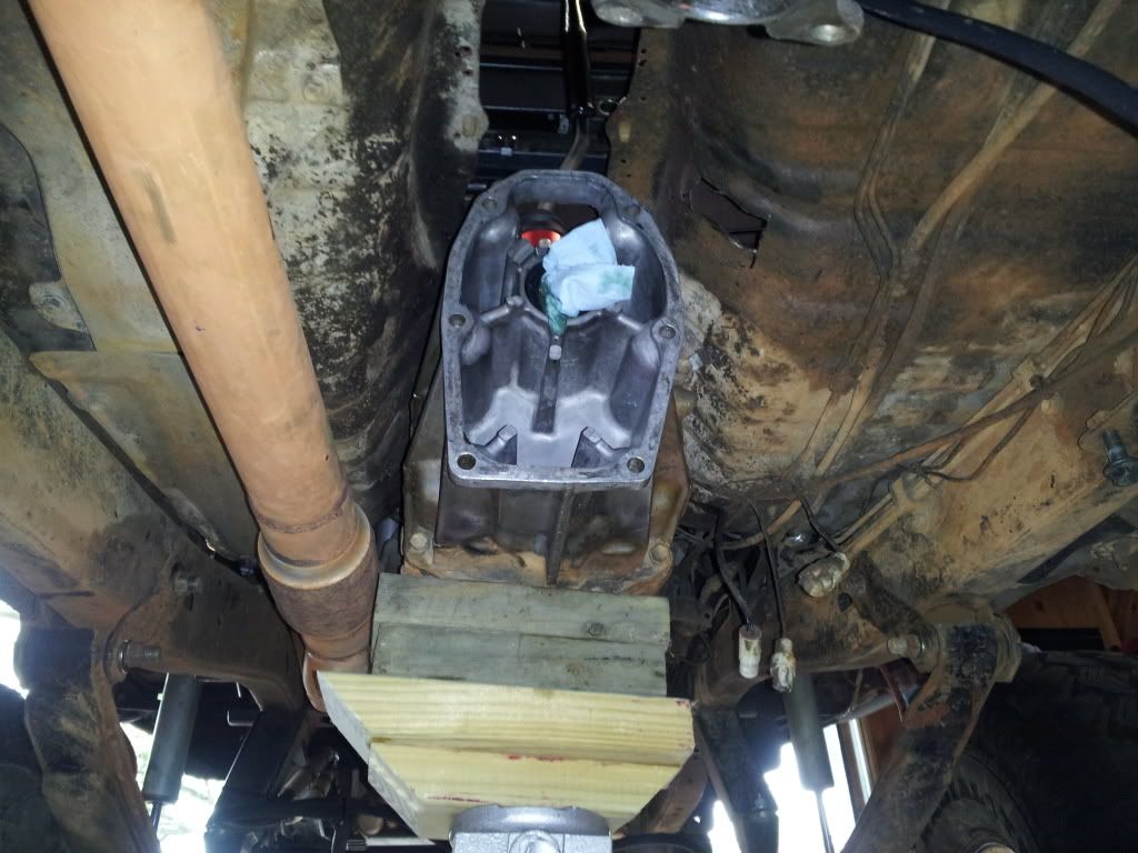

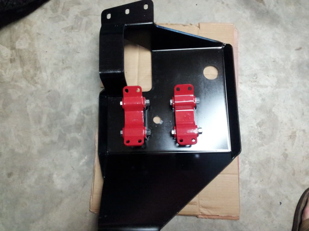

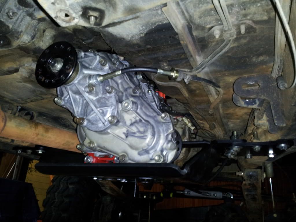

Finally got my duals completly assembled. Just gotta get that heavy bitch installed. I cycled through all of the multiple gear combinations. Seems and feels good. Low/low is going to be a beast!

Now on to other business at hand:
Install the 23 spline Dual Ultimate Transfer Cases.
I have had these put together for a while. The list of goodies include: MC-07 Dual adapter, Longfield Rear output, MC 30 spline front output, MC Total 23 Spline Input, Daves Offroad Twin Sticks, 4xInnovations HD TC mounts and a Sky's Offroad TC Crossmember.
Removed the front driveshaft
Removed the TC shifter and block off plate.
I painted both TC mounts.
Got the TC pulled this morning.
Drilled a whole in the crossmember in order to drain the crawlbox through the adapter.

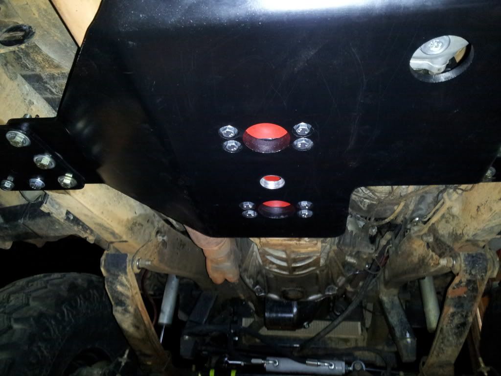

Had some help show up last night. Patrick (scotia) came by and helped me stab the Duals into position.
It was pretty painless. The front input was aligned correctly and we got it buttoned up. I just required and extra set of hands as usual.
The fasteners that came with the x-member were a little troublesome. I got that figured out today. Should have it all buttoned up tonight. Then, I need to add some break in gear oil and install the shifters.

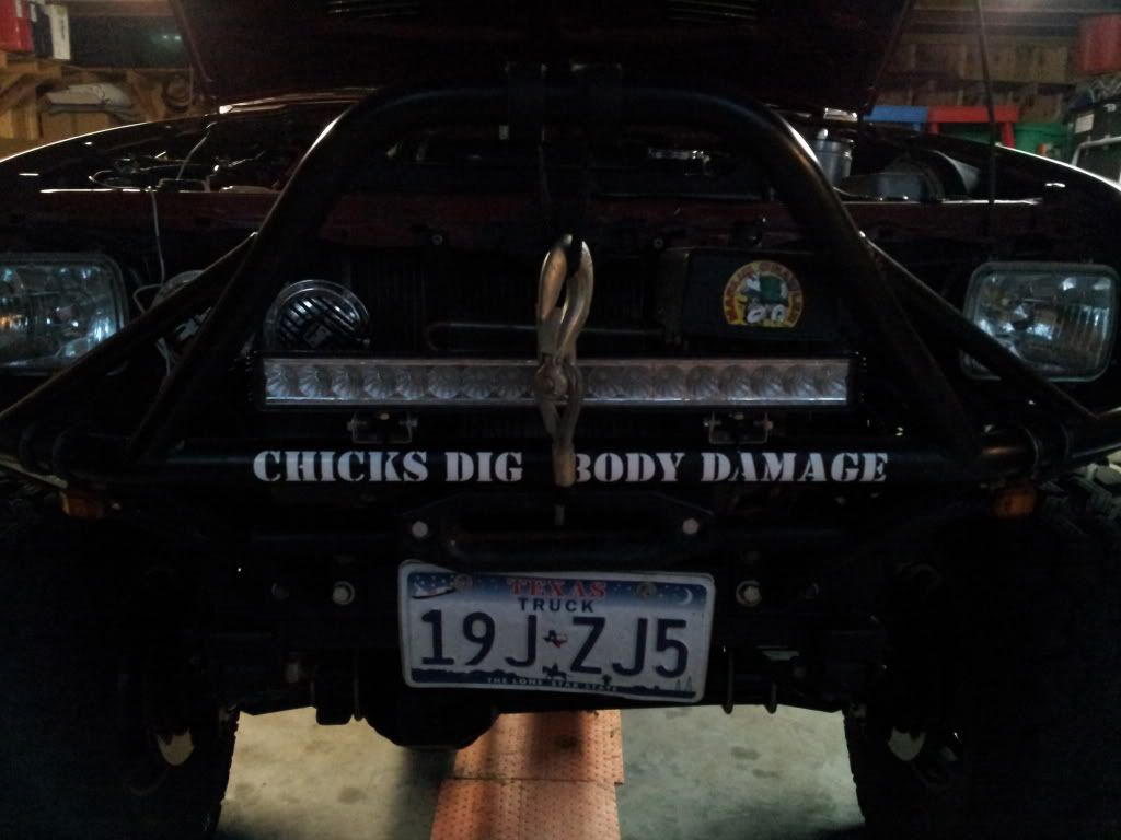

I may have added a few more lumens to the Red Truck with a slightly used Blitzpro 21S LED bar. Fits perfectly under the hoop on my Marlin bumper
I still need to get the mounts figured out but that will be very close to the final placement sans the zip ties.
Here are a couple of shots of my nearly completed transmission tunnel cover
The base that the above panel will mount on
