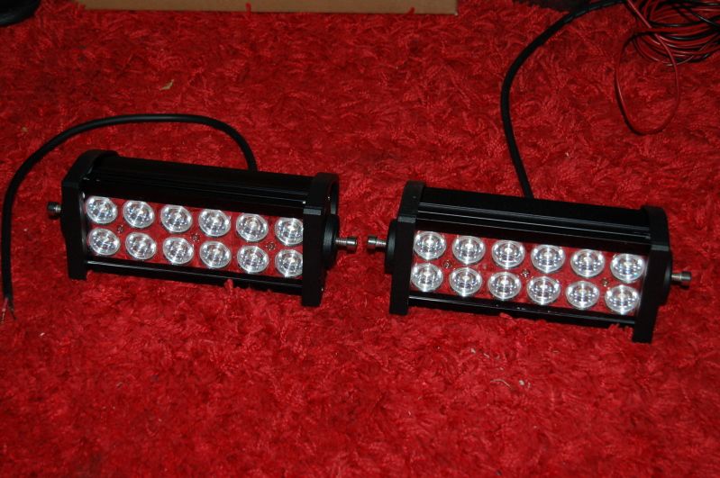

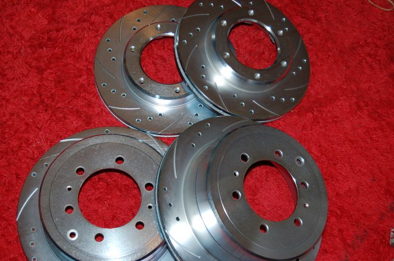

Some more parts came in:
92' fj80 cross-drilled and slotted front rotors
93' fzj80 cross-drilled and slotted rear rotors
I also picked up (2) 6" LED bars to put on the ARB. They each put out 2160 lumens, whereas my old Hella 500 with new h3's put out about 1200, the main reason I went LED was the output but the amp draw is a bonus(2.5a a piece) so I can use the lights without the motor running and not kill my aux batt. I will post a video of them at night when I get the teardrop mounts for the bumper done.

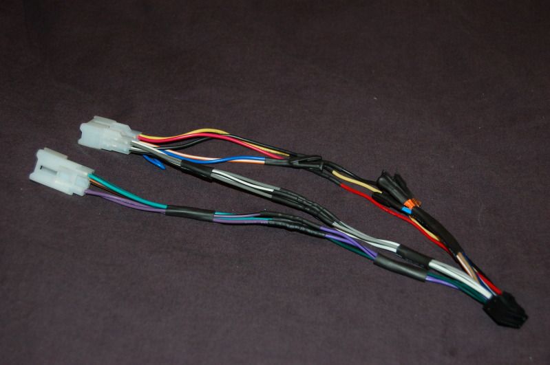

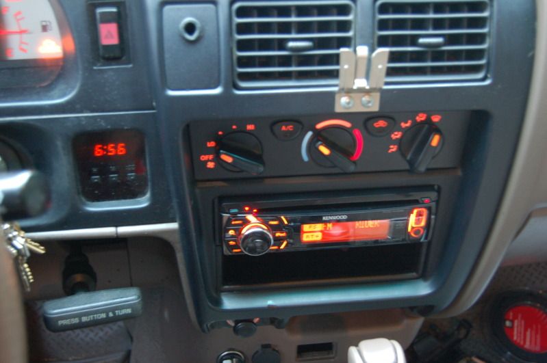

Break from mods and taking care of some comforts.
Decided to take a break from the serious mods and handle a comfort issue, the stock stereo was a little tired and I needed room for a switch panel I"m putting together, so I went with a single din Kenwood Head unit at a great price.
It wasn't hard to install at all, I cant believe people pay hundreds of dollars to have stereos put in. With the amount of information on the internet and few tools you could be done in a few hours. The trickiest part was building the wiring harness because none of the colors in the factory harness matched the FSM wiring diagram, but I bought the adapter harness and apparently all the pins lined up and it works perfectly. I always solder and heat shrink whenever I splice wires together mainly for a professional look but since my truck sees all kinds of vibration and the possibility of shorts occurring. I saw a buddies car burn up in another friends driveway because of an electrical/fuel fire, luckily the dealer was the last one to touch it but you can never be to careful.

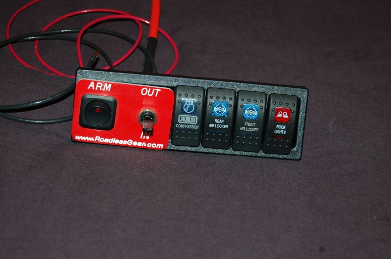

I kinda did a very rough mock up of my switch panel. I have my roadless gear in cab winch controller that connects to the solenoid box but still allows you to use the remote if you want to. Then the ARB switches in the order that i use the most 1-being the compressor, 2- the rear and lastly the 3-the front(which I have only needed a handful of times, mainly up north). I'm going to change all the switch covers to red so that it's a contrast to the amber so I don't inadvertently leave a switch on and it will blend in better than bright blue, I'm big on small details plus the locker covers are tired and loose. I put my rock lights one in there just to see if I could put 4 in, but it will actually be a switch for my dual battery iso/comb. from hellroaring technologies. The rock and driving lights switches will be just in front of the 4wd shifter, but that may change on depending upon the location of the triple sticks.
Gonna replace all the speakers in the doors and soundmat them when i get some more funds. I'm pretty sure the frt. pass side speaker is waving the white flag and I'm sure the rest are to follow. I have noticed an improvement over stock just with the new head unit so I'm pretty satisfied right now.

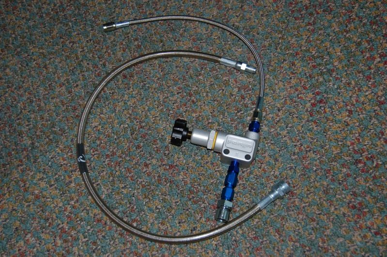

Send a message via AIM to trdtacostand04
Brake prop. stuff
I like going through Jegs even though summit-racing has a warehouse out here but I can wait the extra day or two. The factory 10mm line is going to go into the prop and then the 12" AN line will have a -3 10mmx1.0mm male to connect to the rear brake line to the axle Here's what I ordered:
-3an to 1/8 pt for the prop valve
-3an to 10mmx 1.0mm female inverted
-3an coupler
12" stainless braided ptfe
I already had the 6" marlin rear line, I have too much travel in the rear for the wheelers line I currently have back there. I heard there's a good aircraft hose company in Ontario that will make you lines for a good price to your specs, and I will probably go to them for my steering box hoses when I decide if I'm going forward or rear swing (IFS or 80 series). Next on the list is going to be spring perches and frame boxing plates. I'm going to gamble on ballistic fabs customer service, because I like their designs the best.

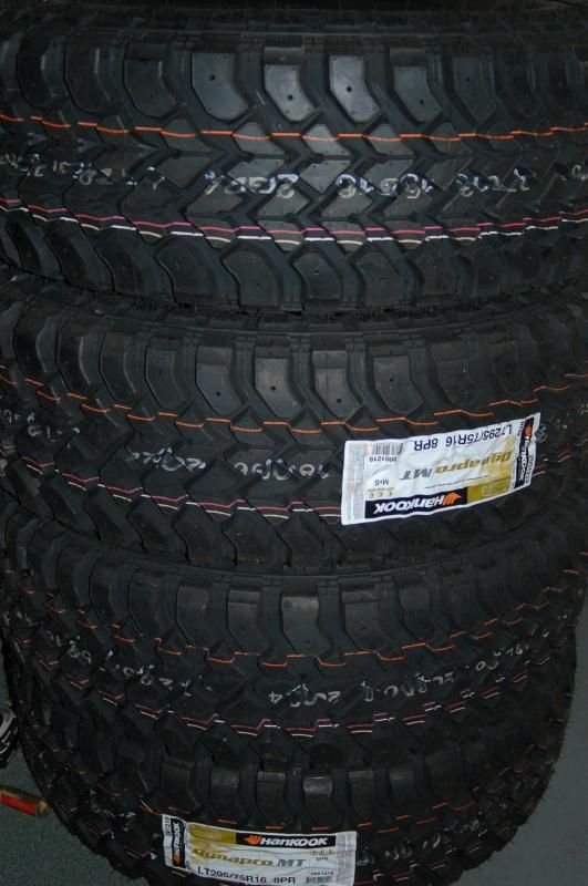

Originally Posted by trdtacostand04 View Post
Sold my 255's to another member because they were too narrow for my bead-locks and I went to a 295/75/16 or roughly a 33.6", in 11.5 wide Hankook dynapro RT03.
Excellent tire choice, I absolutely loved my Hankook's!!

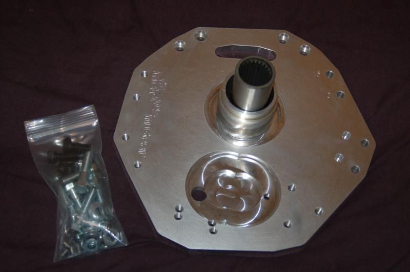

Originally Posted by MVLSKI View Post
I would go with the Inchworm adapter plate
I did end up going with the inchworm. Mostly because they had it in stock and it was on sale but the seal on the spacer looks like junk, im probably going to replace it with a marlin seal. All in all the machining is great quality, I would recommend taking a compressor and blowing out all the tapped holes, mine had a few curlys left inside from the mill
They look like they're going to be a great tire, the best tire I've had all around would have to be the Trxus MT's (the sidewall was stupid thick and they started off pretty quiet) The size was a perfect compromise as i wanted the little more narrow width as well as the slightly larger than 33" size.
