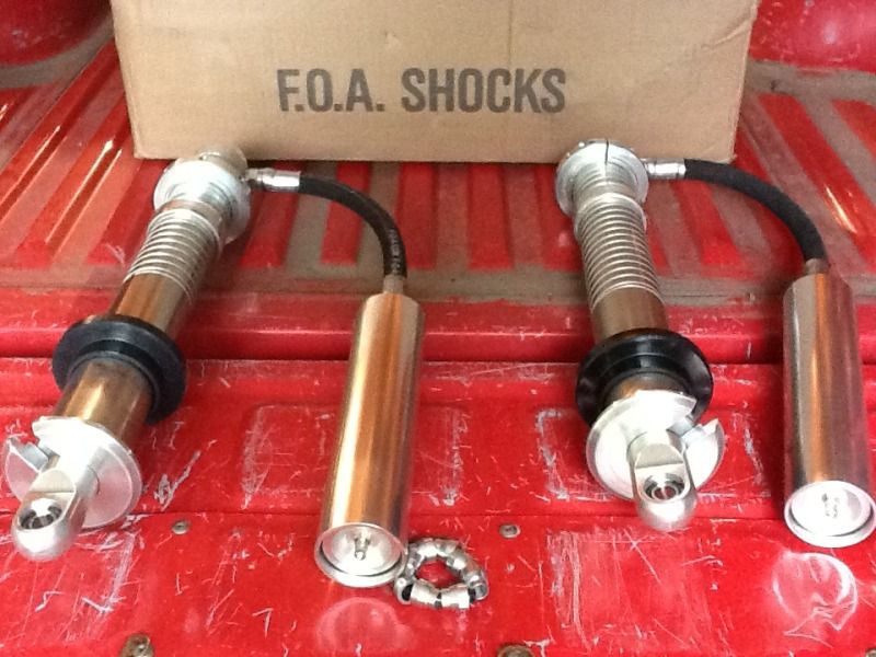

Wish i would have seen this sooner! I ordered some 14" travel ORI STX struts with the remote resevoir. I figured my chances of actually making it to KOH and racing might not be too great, so figured I'd be OK with the ORI's. I have heard they are great up until you get to 4-5 hours of hard running, which i am fine with. Just makes my life easier to not have to fool with a swaybar or airbumps.
I got the steering knuckles from Hellfire Fabworks, the front axle is partially assembled, the ORI struts should ship out next week.
