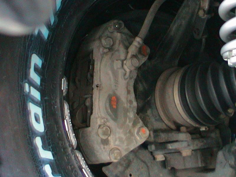

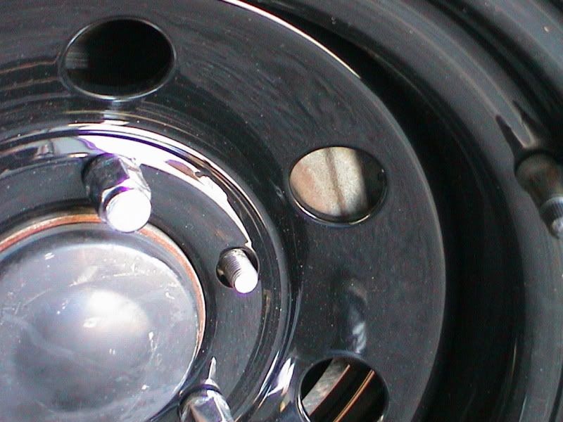

I'm mainly just answering the "Why go from 16s to 15s?" So, I doubt this will help especially since I doubt you can get these rims.
Anyway, I went with 15s, per discussed earlier, I wanted to save some $$$ on tires.
So I did some research and what gave me hope was what this guy posted up:
http://parksoffroad.com/tacomamods/l...ireswheels.htm
So I bought a set and went through the same crap he did with people telling me they would not fit.
But a picture says a thousand words:
The calipers come REAL close but they clear.
Those rims are Pro Comp 15x8 Steelies Series 87 with 3.75 backspacing.
As mentioned before I don't think you can get these rims anymore so you might have to go with what wheelers offroad has.
This is all a mute point now that I went with a pre-taco truck, for my wheeling rig.
Good Luck.
