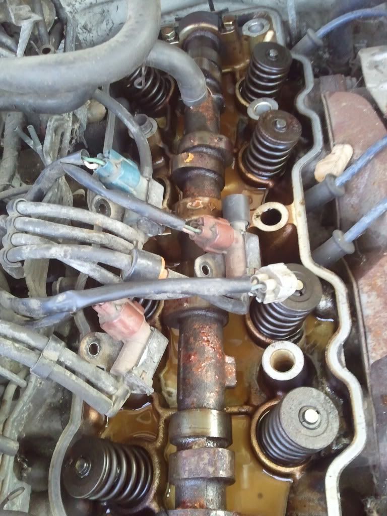

rust.....lots of it
Sic semper tyrannis
NorCalMax is offline
post #6 of 13 (permalink) Old 02-02-2012, 07:08 AM
Join Date: Jan 2012
Posts: 39
Looks if that one saw water, is that rust?
SilverLux is offline
post #7 of 13 (permalink) Old 02-02-2012, 07:08 AM
Join Date: Jan 2012
Posts: 39
Yip, like you said a lot of rust!

I was about to say screw it but the rust fell right off so my next step is taking the whole head and timing assembly off to find the source. I'm hoping one of the guides wore down and let the chain dig through instead of a cracked block. Only time will tell.

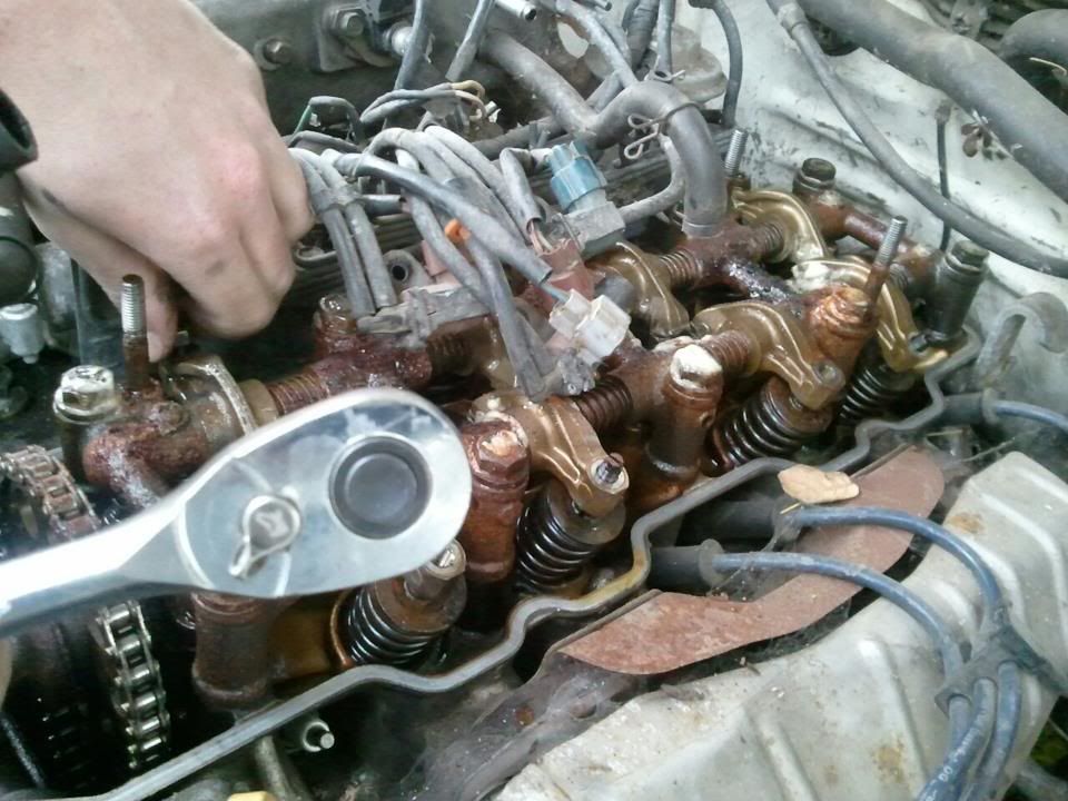

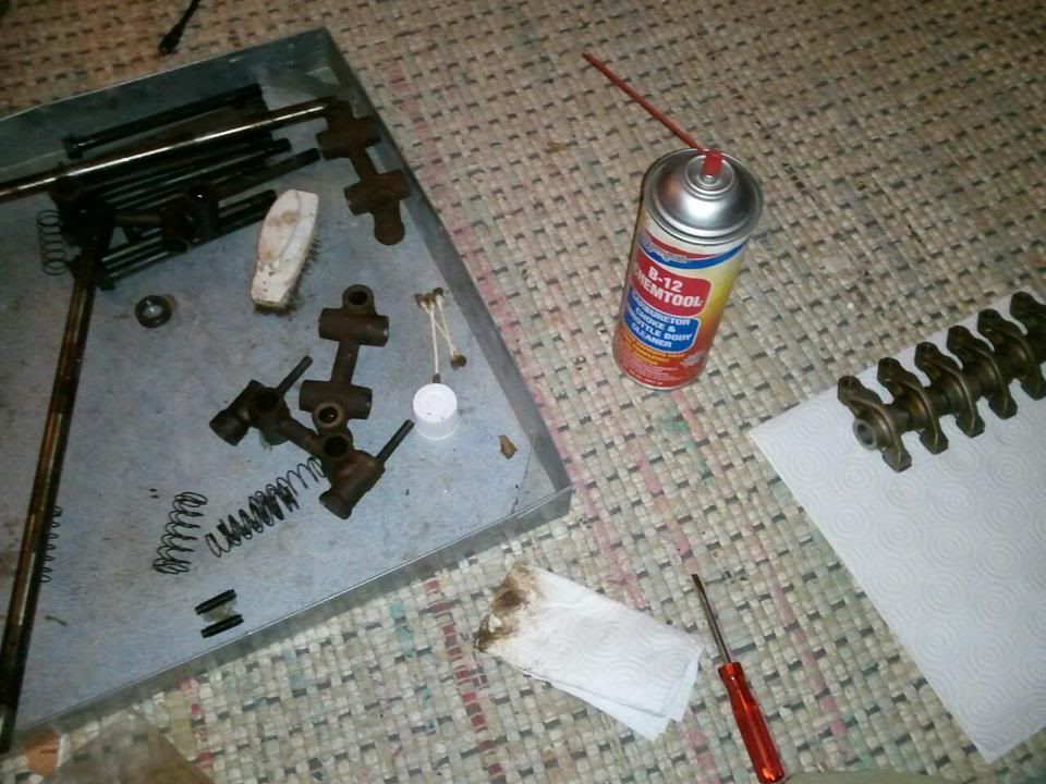

I'm curious as to why you pulled the rocker assembly all apart. Is it the rust you were worried about? The rocker assembly comes off as a unit and you almost never need to remove the adjusters from the rocker arms, unless you find a broken one.

Go ahead and take a look at the picture before it was out of the truck. WAY to much rust to just take off in one piece. I really don't want to put money into this so I'm trying to salvage each part

Im going to start tearing into it pretty soon. I've been pretty busy yesterday. I got my rocker pretty clean. I'll get some pics soon

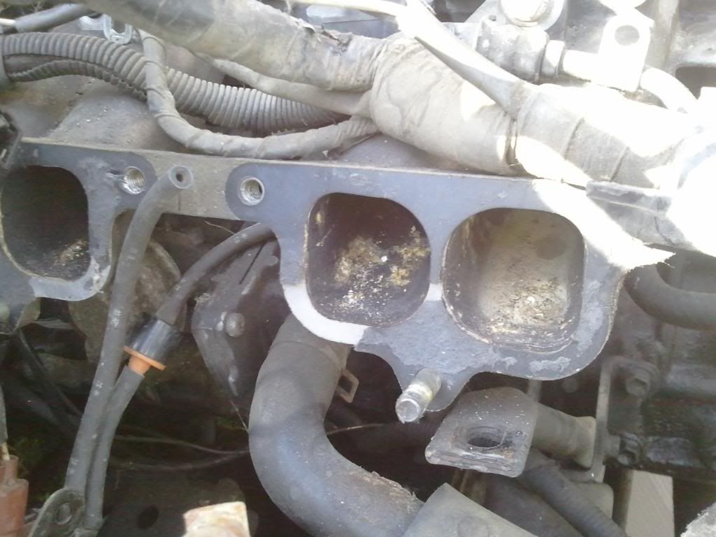

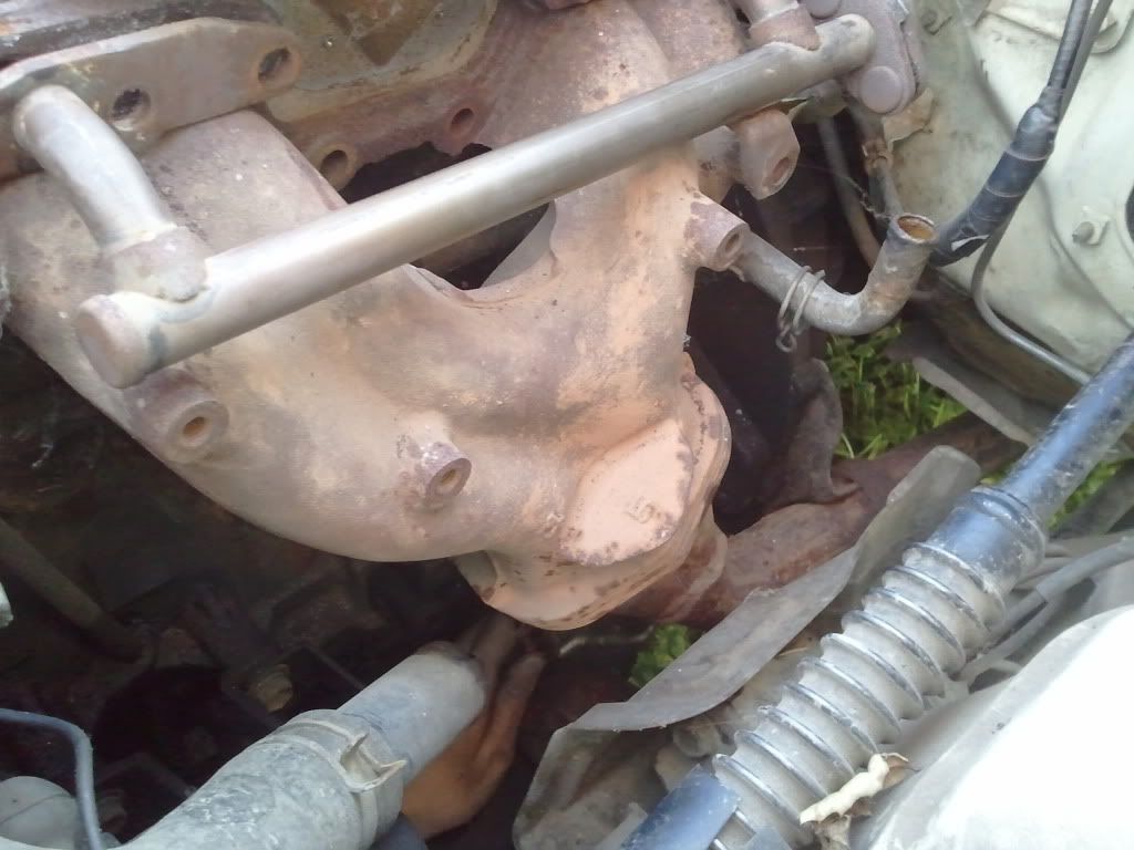

found out its already been torn into
this is an hour after the plug was pulled.....ya its not draining
intake
header
shot water pump
so thats it for now. the head was stuck pretty bad and it got late so i called it quits for now
