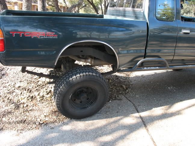

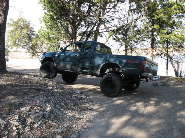

When I bought my truck the owner said the shocks on the rear arnt matched for the rear shock relocation so this weekend was the first chance I got to get some measurements and pictures. Let me know what I should do.
32-11.50-15's
Rear is lifted with (keep in mind the leafs were rebuilt a little while back):
1.5" Downey shackle
1.5" AAL
Shocks on the truck right now:
23.5 inches Extended
14.5 inches Compressed
Took the shocks off the truck and flexed:
25 inches Extended with room to go
20 inches Compressed with room to go
22 inches ride hight
I didnt want to flex it too much, iv heard horror stories about bending the leafs to the point of no return.
now on to the pictures
^^Shot of set-up^^
^^Shocks on^^
^^Shocks off^^
5 inches of travel for the rear shocks seem a bit low, should I move the lower mounts?
Let me know what you guys think.

Marlin sells the bilstiens pretty cheap like 75 bucks for the 14" travel shocks. Not sure if too long would be be a bad thing, but worth a shot if new shocks are needed
