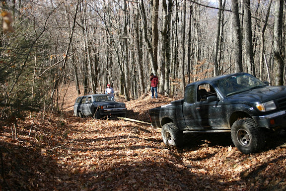

11/2008
about this time, i took it on my first run into north carolina .. and had to get dragged all over the trail w/out a locker. open/open and v-ditches don't work out very well
but it looked good
oh yeah, and I got stuck on a log and broke my stock bumper... darn.

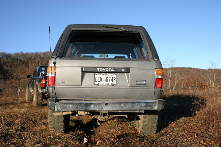

at this point, it was time to stop doing maintenance, and add on some extras....
started with some home made sliders and a rear bumper:
i also took this opportunity to rid my truck of some of that chrome
before:
after:

january trips ... Coal Creek (Windrock) and Back to Ed's (hayesville) for some snow
