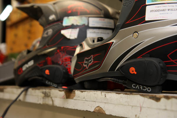

It's just a motorcycle intercom setup intended for street bikes. I think it's bluetooth so it can sync to your phone too, or any other bluetooth device. Mainly intended for communicating between motorcycles, but no reason it shouldn't work in a race truck too.

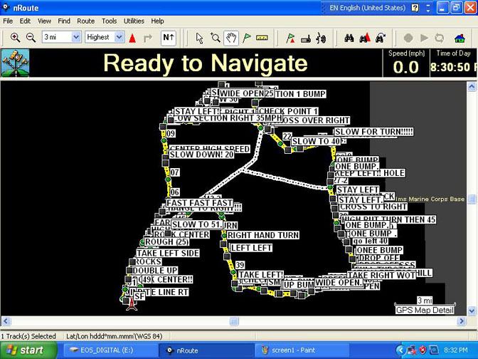

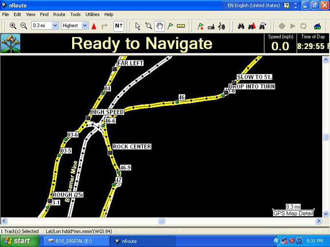

The guys preran the course and put in notes with a keyboard. Here are some screen shots, let me know if you have any other questions!
Actual scale during the race was a little larger (0.2mile)
A zoomed out look of what the whole map looked like
How have you been Chris?! Your absolutely right! Bluetooth intercom that bikers use. I haven't used it myself in the truck so I'll let the guys chime in on what they think. Got it for $242 off ebay.
