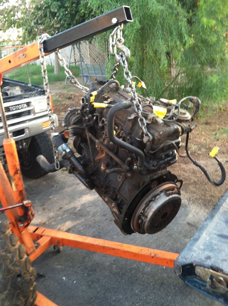

I guess one could say that we got a little done today
I forgot how much of a PITA those top two trans bolts were. All in all, took about 5 hours for my buddy and I to pull it, but in the sun it's around 110 over here. I can't wait to get this on a stand, finish the tear-down, and start cleaning it up

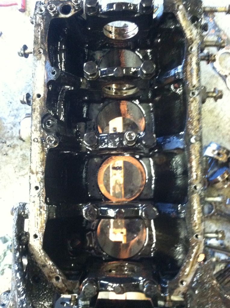

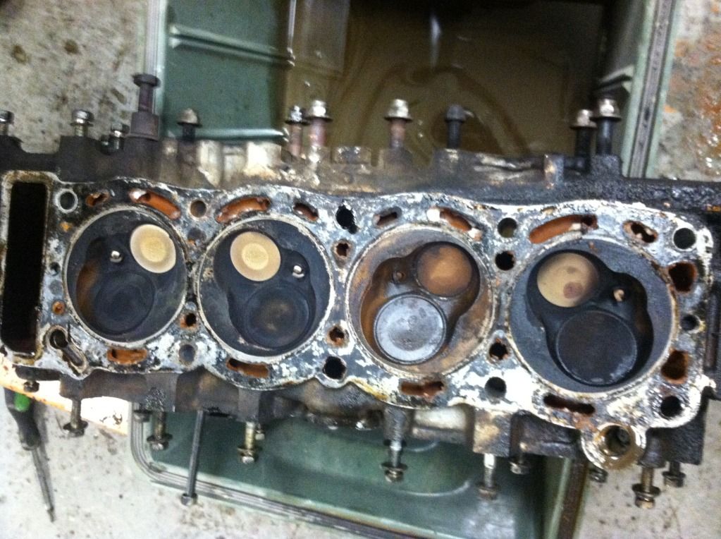

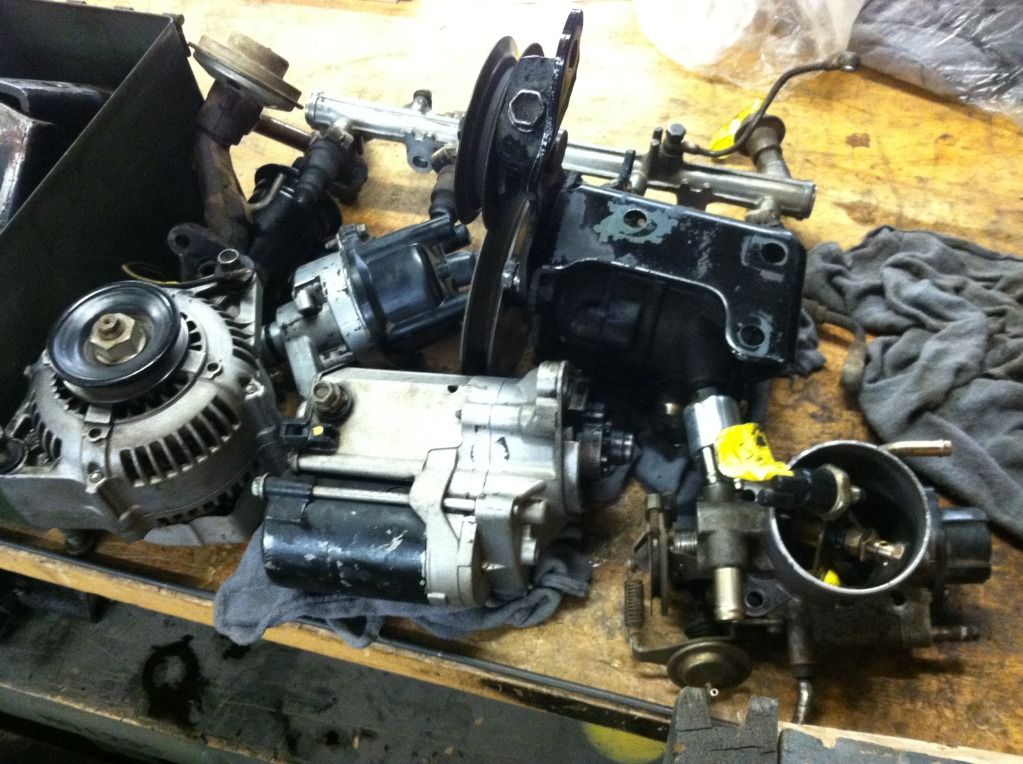

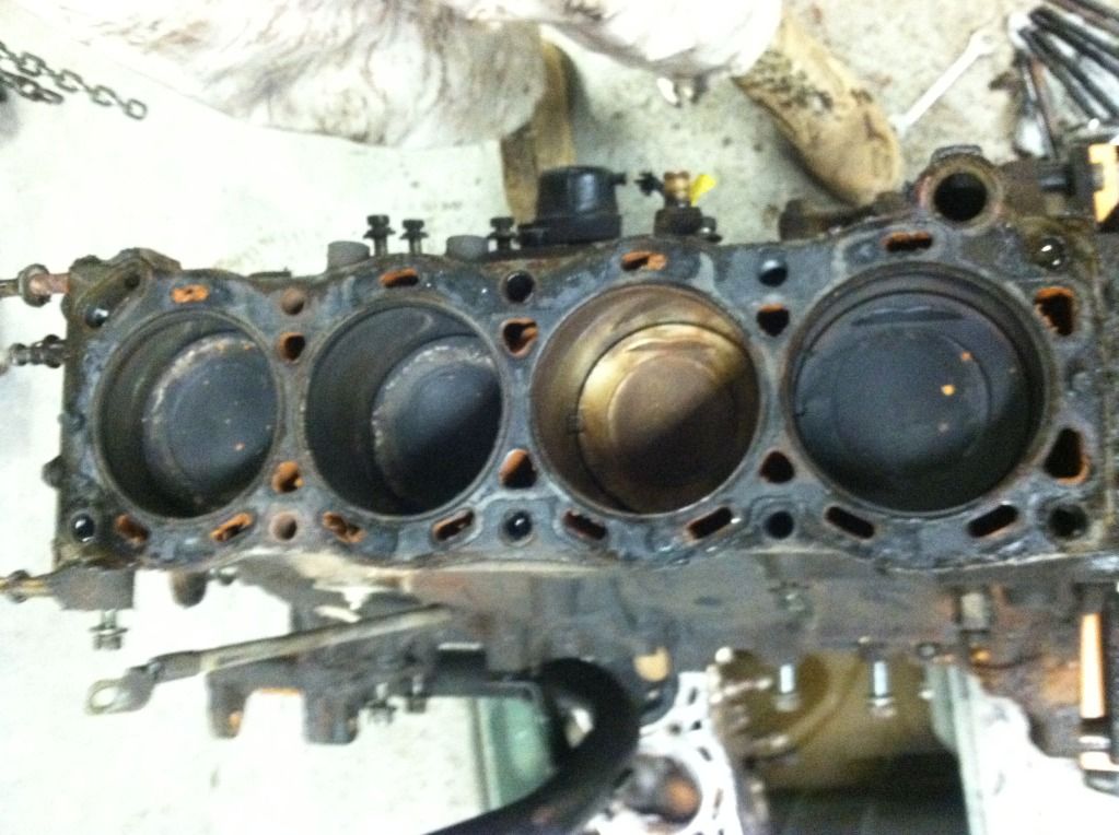

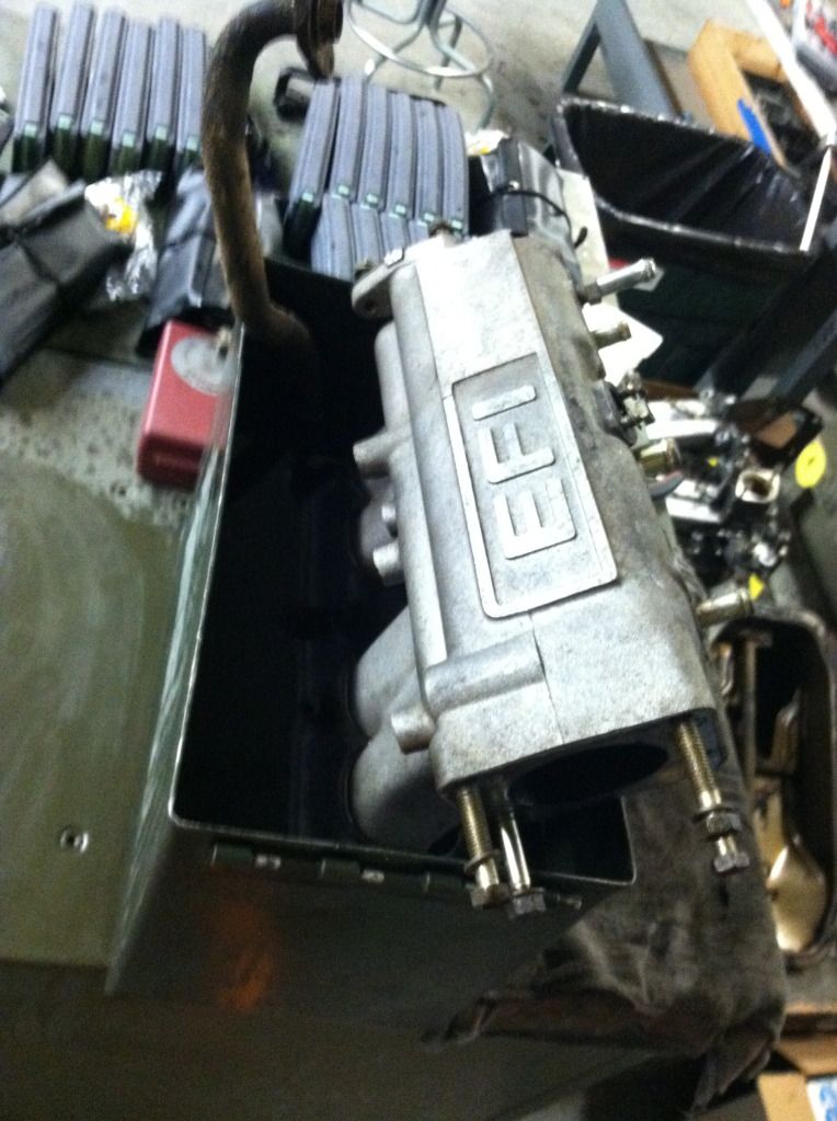

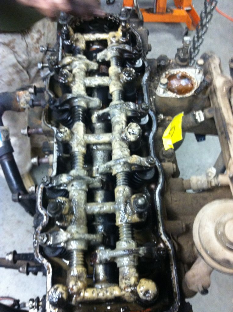

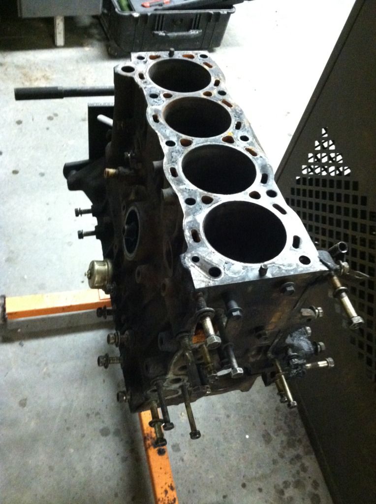

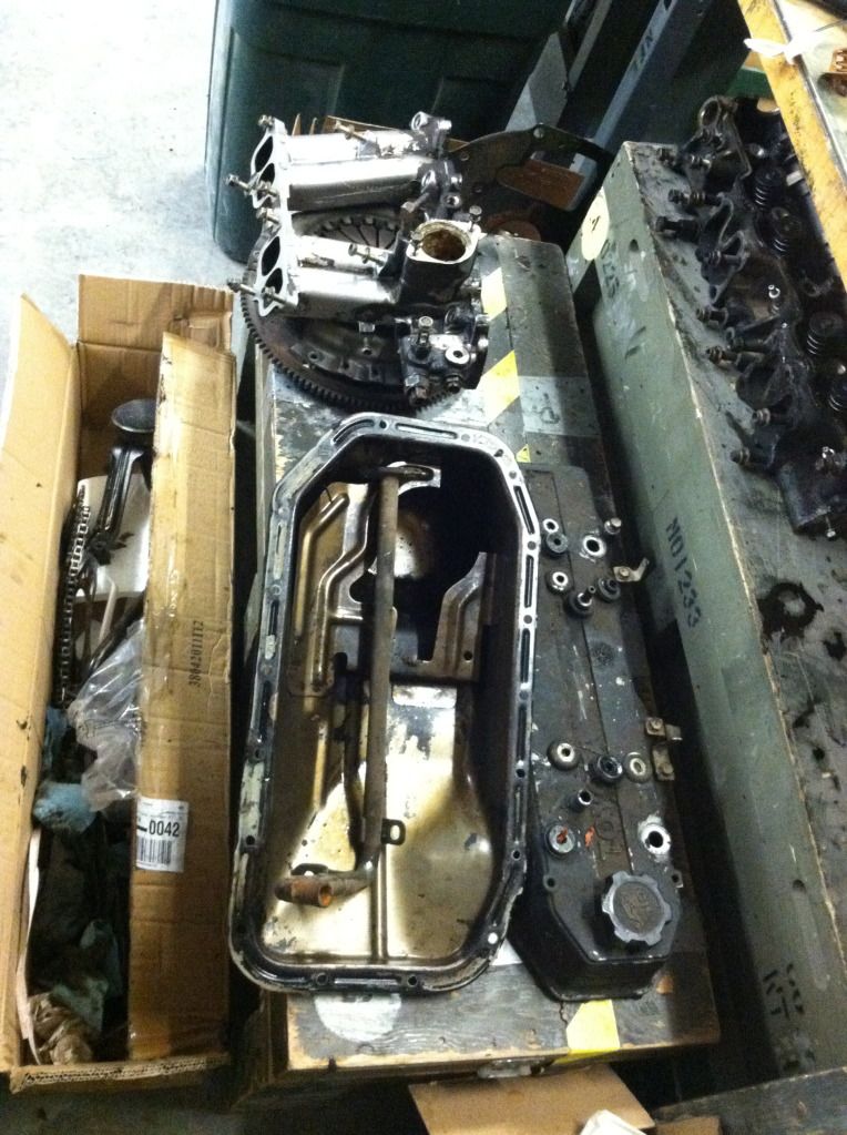

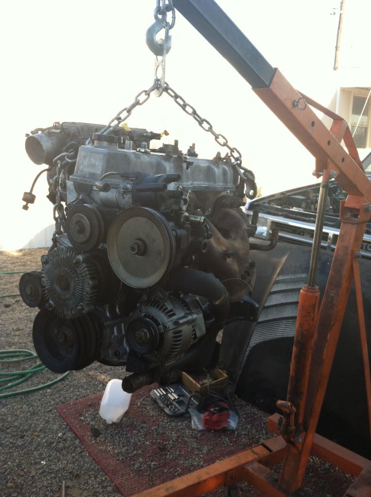

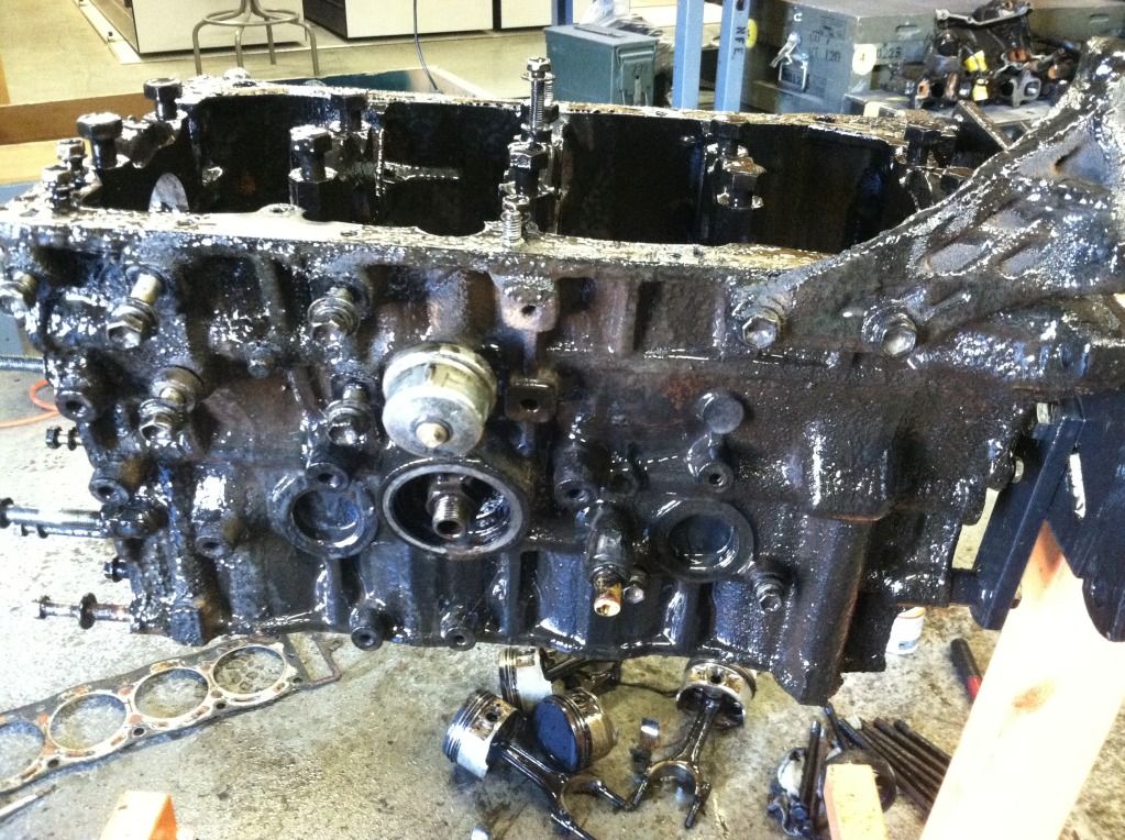

Yesterday we tore it down, inspected, assessed the damage...
Looks pretty awesome, like-new even. But, now that it's all in pieces, let's clean it and rebuild it..... for science!!!
block is waiting it's turn to go to the machine shop
parts soaking in a solvent-filled ammo can
As you can see, most everything has cleaned up pretty well. Got a few cans of brake clean, the solvent tank at work can only go so far, as we've switched to "green solvent". it works alright if you let it soak, and it smells like green apples . The plan is to deck it, bore .020 over, complete rebuild with an engnbldr kit, OEM head gasket, and engnbldr head and cam. Since it's going to be nice and clean, it'll get painted as well.
schwyter is offline

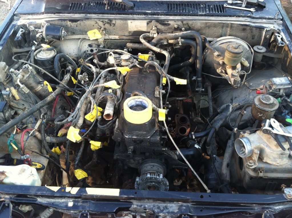

post #37 of 101 (permalink) Old 08-23-2012, 09:19 PM Thread Starter
schwyter's Avatar
Join Date: Nov 2008
Location: Yuma, Az
Posts: 332
Send a message via AIM to schwyter Send a message via Yahoo to schwyter
thanks man, i hope so
schwyter is offline

just dropped it off at the machine shop, where I was told it'll be about a week until its done.
deck the block - $100
bore and hone .030 over - $90
hot tank - $50
resurface the flywheel - $60
turn the crank - $150
not sure if these are good prices, but when you're the only one around I guess you can name your price

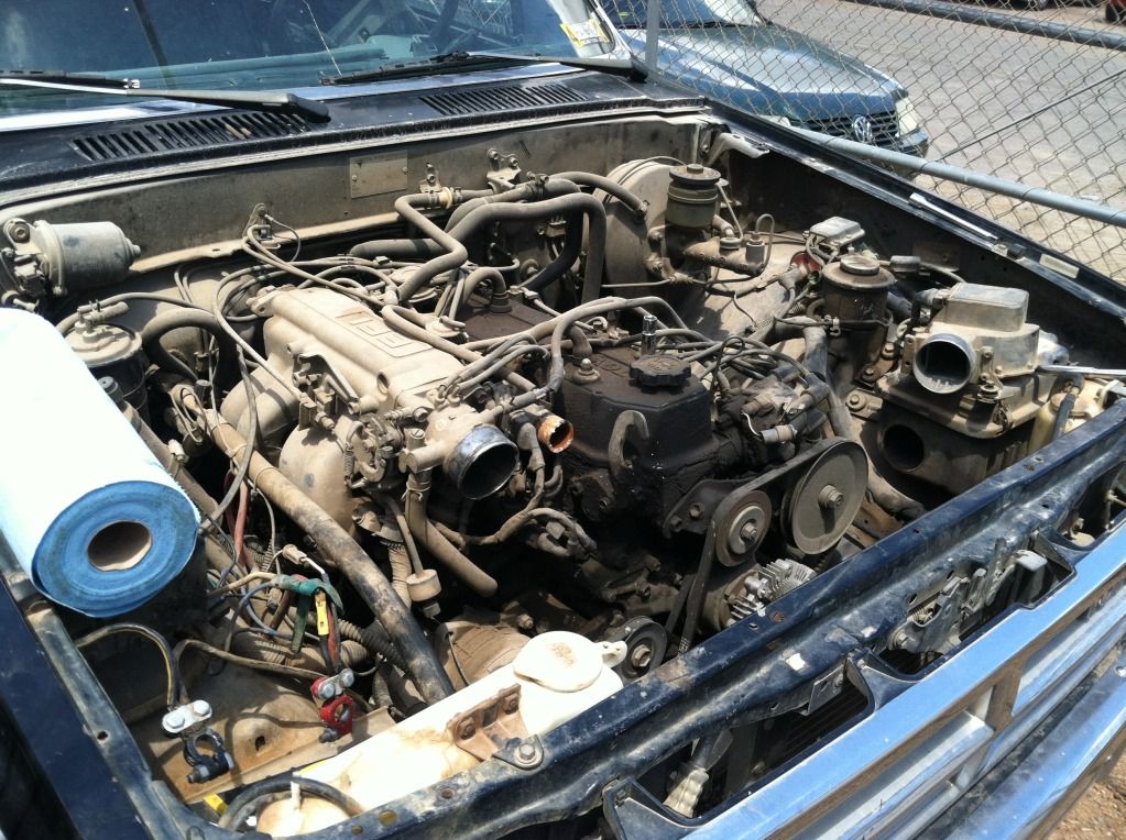

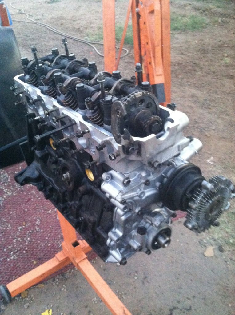

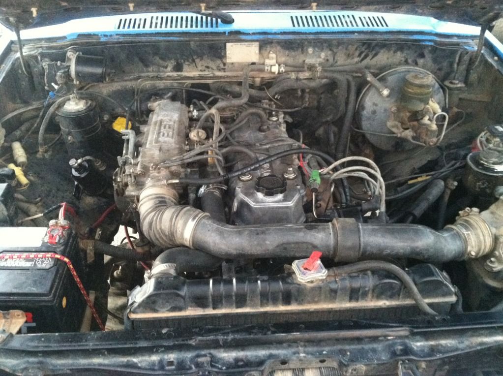

Does anyone know what this ground-looking majigger is? It's coming out of the wiring harness with the injector plugs, and I can't find out where to bolt it down to. Also, update pics...
We got the engine in, i just didn't take any pictures, way too tired after three straight days wrestling with this bugger and running a 10k mud race, all while being beaten into the dirt by the Arizona sun
anyways, hopefully she'll be fired up and running like a champ this weekend
schwyter is offline

[QUOTE=schwyter;2325365]Does anyone know what this ground-looking majigger is? It's coming out of the wiring harness with the injector plugs, and I can't find out where to bolt it down to. Also, update pics...
that wire is a ground.. it gets bolted on to the lower intake manifold at the flange where the upper intake plenum attaches.. it either goes on one of the mounting bolts ar has its own bolt hole i cant remember but either way will work..

thanks mark, i got the answer from yotatech too, and it would look a lot better if it decided to friggin run!! it's got spark, it's got fuel, and we had it running yesterday, but had to hold the throttle open, it wouldn't idle on its own. we think that the t-chain skipped a tooth on the crank gear when we cracked the cam gear and had to take it off to replace it, so on friday we get to take the whole front end apart AGAIN ('-.-) this thing is becoming the biggest pain in the ass i've ever had to deal with, but it'll be worth it.
just pull the valve cover and put the crank pully on the 0* mark then check where the cam gear mark is in reference to the mark on the center of the rocker shaft mount.. you can change the valve timing without pulling the entire front of the engine apart.. even if it's off 1 tooth it should still idle.. whats your ignition timing set at? also make sure the flapper in your MAF meter is moving free

the instructions from engnbldr say set timing at 6-7* BTDC, so I'm trying to keep it at that

hey mark that worked, just have to hook up a timing light tomorrow, bolt down the seats, install hood pins, and that ought to be it. But, knowing my luck, something will shit out on me.

alright, picture time, as promised. video will wait until the exhaust is fixed.
the seats are a little tall, but man are the COMFY
we nearly shit ourselves when this bugger exploded like it was filed with quarter-sticks

Hahaa. And I thought my muffler was getting bad. Nice job man. Looks good. I've always wanted to rebuild and engine. But I'm just too dumb
My dad wants a 51' Chevy pickup. Maybe we'll get to rebuild one of those. A little less complicated than what you just did though.
Enjoy

yea it was pretty intensive, but the knowledge level required isn't through the roof. i mean, I had a shop do the bottom end so I wouldn't fuck it up, and granted there a a few bolts missing here and there, but it's not leaking yet. the timing was a b*tch to get right though. all in all, great learning experience, and it's not even half way done haha.
Also, thanks for the encouragement everyone, I can't wait to get this baby broken in at rausch, moab, rubicon, or wherever.

Nice battery tie down looks good
haha yea, thanks, took some major modding to get that rigged up
all joking beside, that's actually my battery tie-down for the foreseeable future. As for the exhaust, my buddy welded it on for me today and man what a difference a $30 thrush muffler made! I know I keep saying i'll post a video, and I will, just the sun out here is so bright that unless i catch the right time of day, it'll be total shit.

Hahaa. I saw that too. Was gonna rip on him too but figured he's prolly fed up with it by this point.
You sell your Runner yet Jordan?
