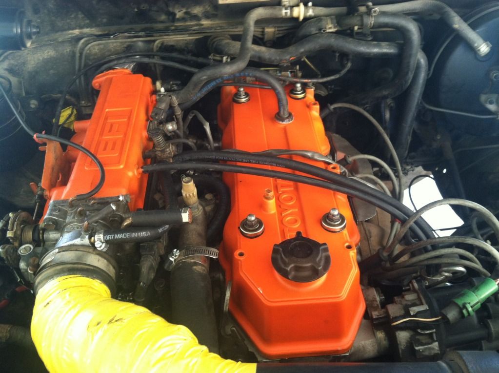

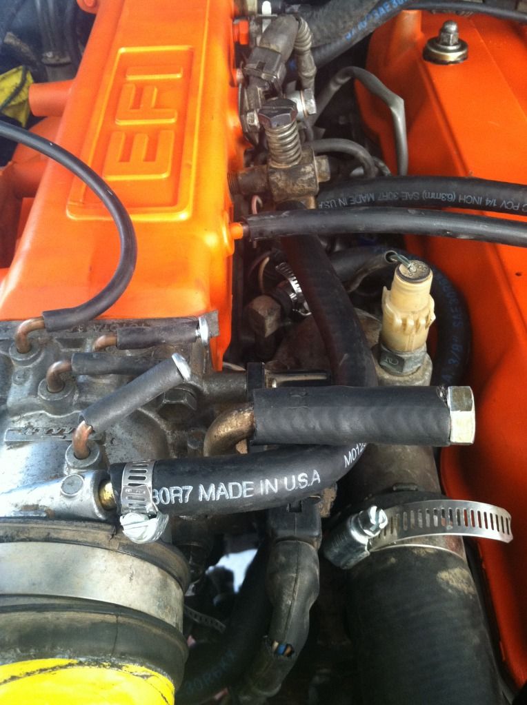

well, I check the CSI time switch, and with both STA-ground and STJ-ground are out of spec. I used this fsm page as a guide, but tested both to ground to since my plug is sideways and I wanted to be sure
painted the intake and valve cover, I'll upload more pics tomorrow of my hose routing and such

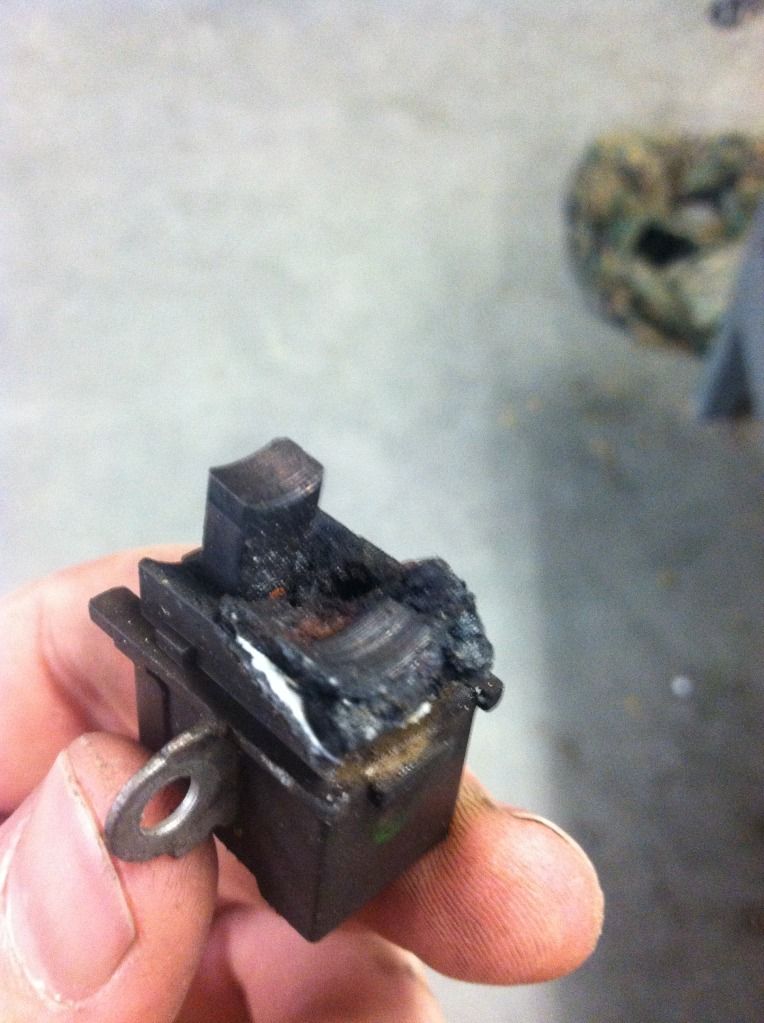

Well, the CSI time switch ohm testing out of spec is confirmed, I took the CSI out and cranked to check for spray, and it's bone dry. Lucky for me though, my buddy has an 89 that i'm cannibalizing in trade for a TV haha. I know the parts are good because his truck was running like a kenyan marathoner till he blew the head gasket (for the third time).
Only issue I'm still having after I swapped the full intake (plenum/throttle body) is that the idle is sitting at about 1200 after the engine's warm and the idle screw all the way in. I tested out the TPS per 4crawler's site, so that's in spec. I can live with it, but for the sake of the engine's longevity i don't think it's great to have it idle at 1200-1300 RPM, rather than the 750-800 i had it set at before.

Here are some pics of the intake setup and a close-up of the vacuum caps I made with my own wits and ingenuity haha
Going to order some intercooler piping and coupling to finish off the intake. On top of the plenum/TB swap and 5mge AFM swap, this baby'll be sucking more than a Thai hooker in a port town.

One more thing, the reason my alternator wasn't charging. gotta love neglected 25 year old car parts
Interesting.
Looks identical to what I found when I pulled one apart that started on fire!

yea, I guess I caught it in time. $20 from the toyota dealer and 30 minutes of my time, sure as shit better than an engine fire.
