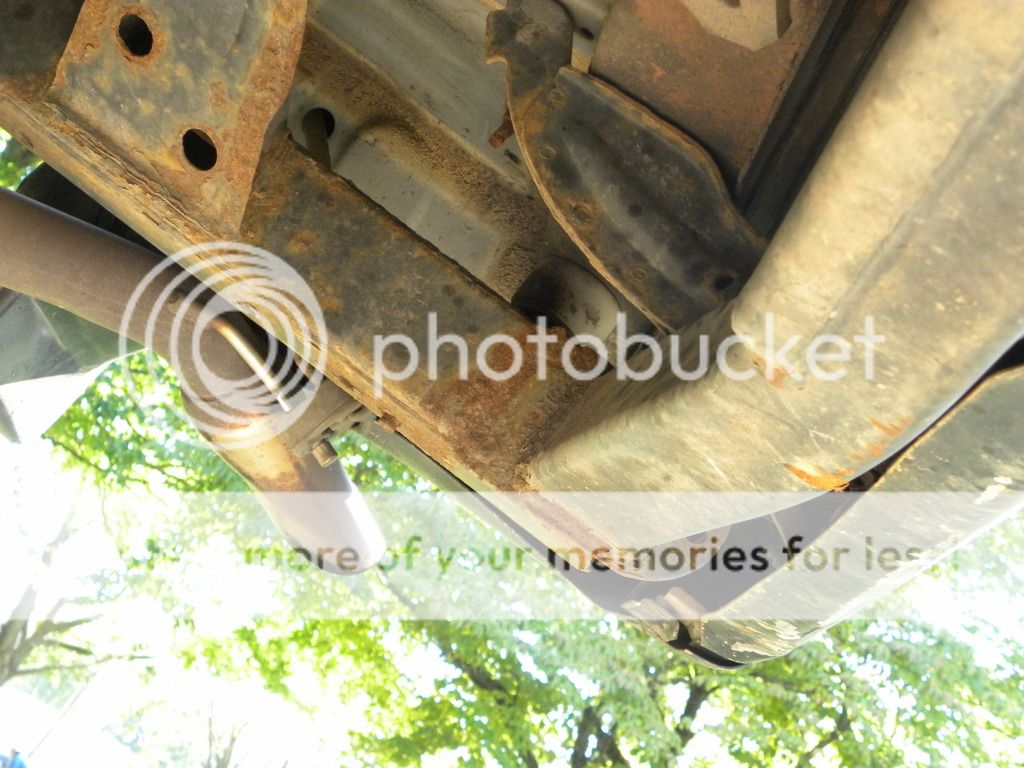

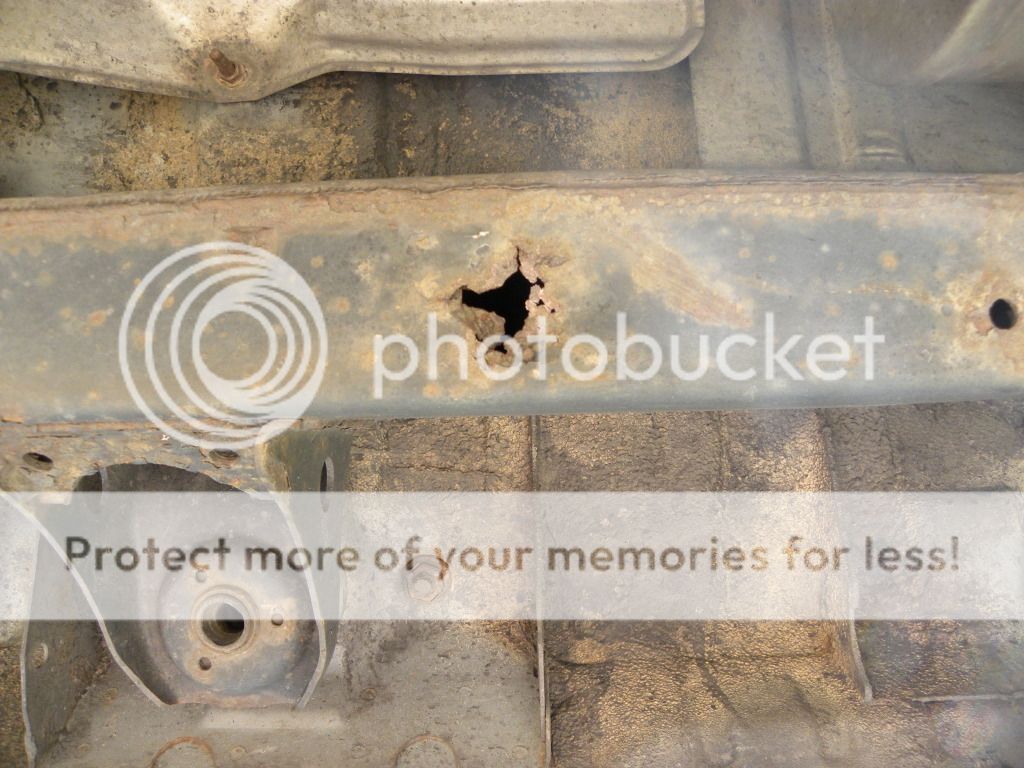

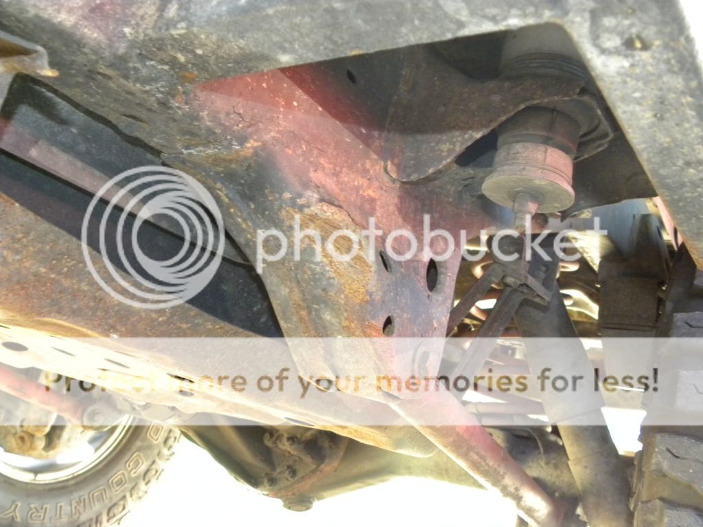

This is the whole that started this all:
Beat up lower link:
How pretty much the whole rear looked, starting to make its way forward:
