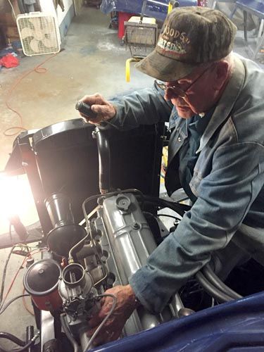

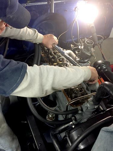

My dad re-torquing head bolts down after engine was warm. Gotta make sure everything is buttoned down. This should not be over-looked for those of you who are new to engine rebuilds like me. You'd be surprised how things can loosen up on first warm up of a fresh engine.
Here's pap just giving er a final once over before we hung it up for the night.

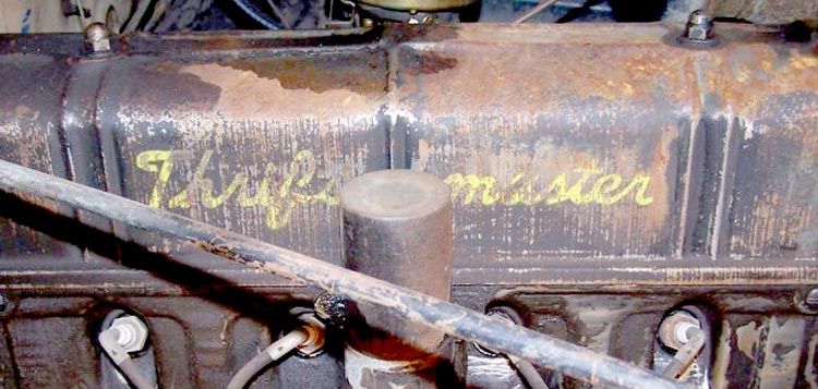

On the side of the valve cover of these old trucks they displayed the name of the engine..for example Thriftmaster and Blueflame. Now there are two different types of Thriftmasters. The 235 and the 216. Ours happens to be the 216 and each had their own logo. Now you can purchase a decal through certain venders but we didn't like how they looked. So this is what we did.
Below is pic of original valve cover.

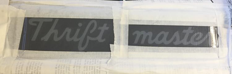

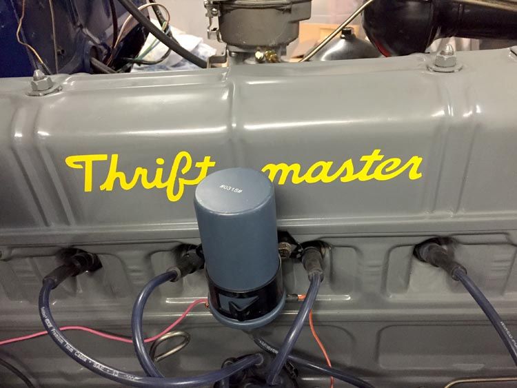

Having the computer programs at my disposal I recreated the logo in illustrator and made a stencil from vinyl and stuck them on the valve cover and taped everything off.
Spray painted over it all and carefully removed decal. Below is the finished result.
Much better than the decal...we believe.

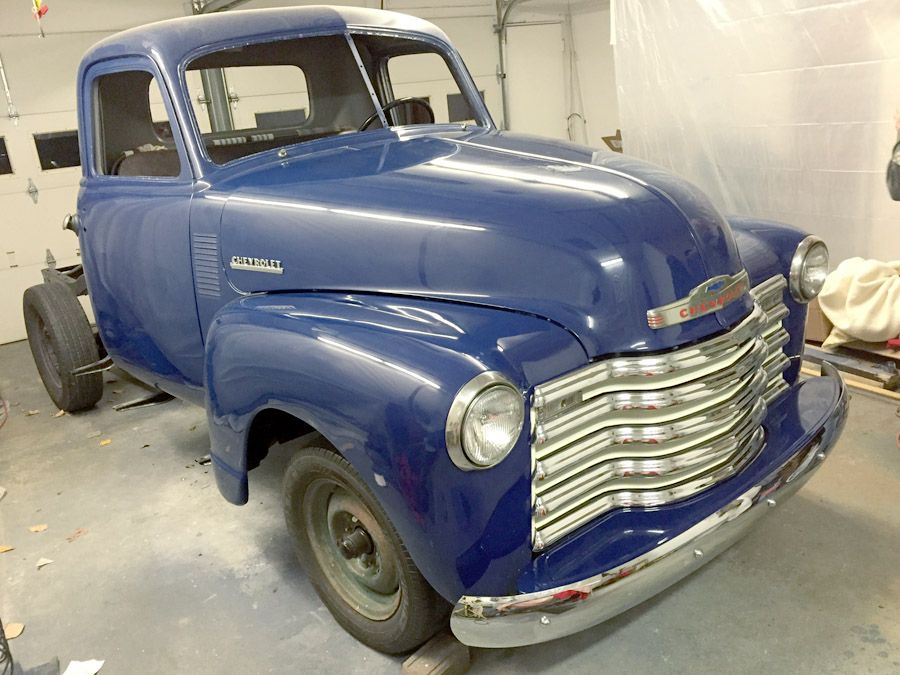

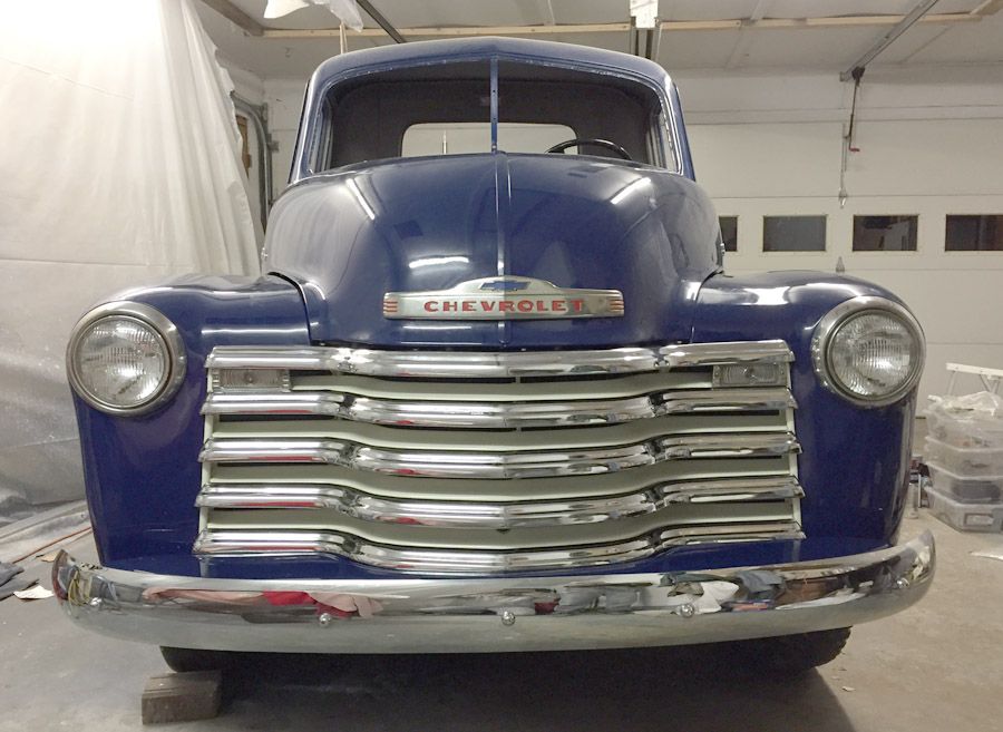

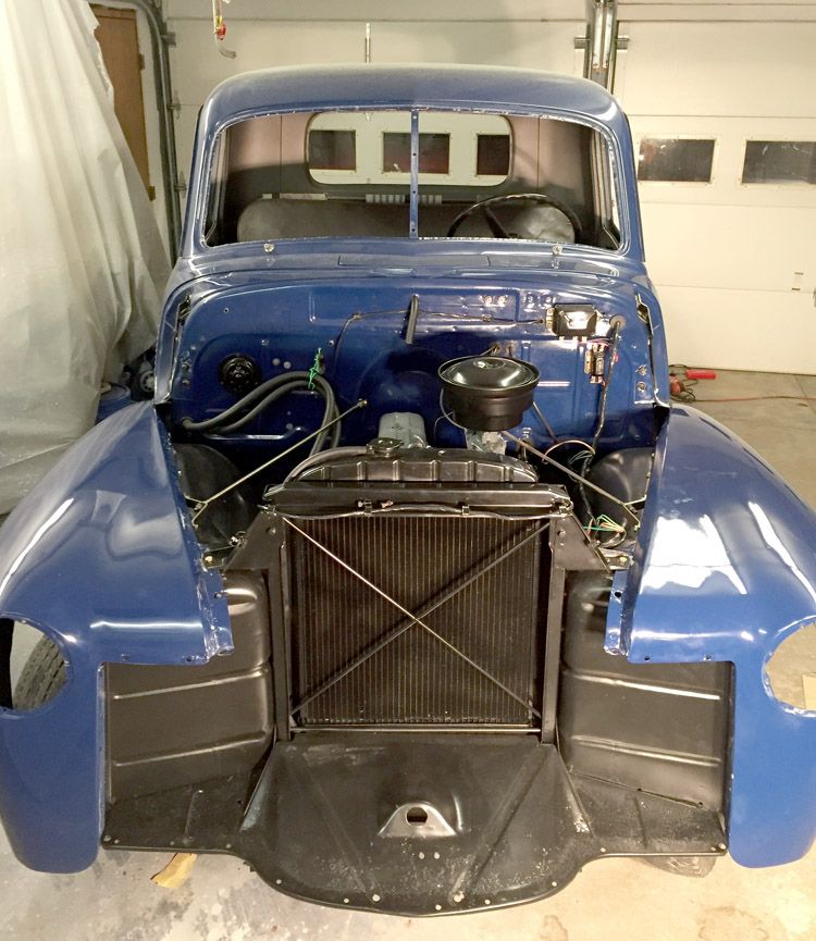

Well we've been hard at it lately. Been spending time on a little assembly. Sounds easy right? Think again. Lots and lots of loosening, tightening, adjusting and re-adjusting bolts to make things fit. This old truck has been a bit of a bear to get right. But at any rate...here is how she sits now. Enjoy.
Finally got the fenders mounted. (pay no attention to the little green wire currently holding up the hoses to the firewall...that's just temporary.)

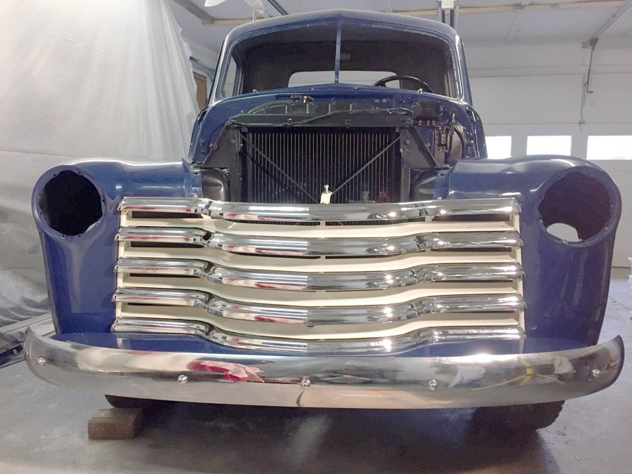

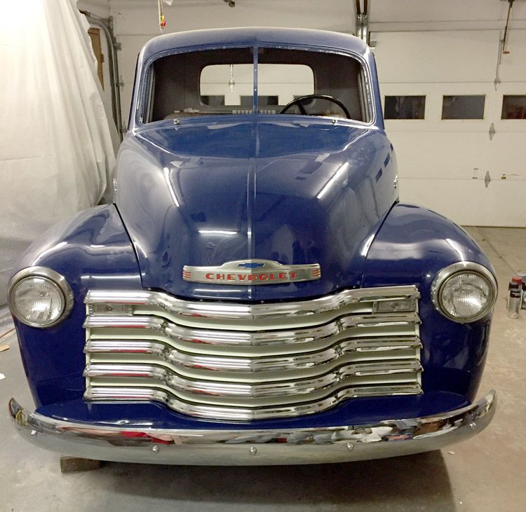

Then we worked on the grill and bumper. That dang grill was a tight fit.
Believe or not...that grill took 3 hours to install. Took a break and went at it the next day with the headlights and hood.
BOOM!!!
BOOM SHACKA LACKA!!!
It's actually starting to look like a truck now. Almost can't believe it.
We still have a few gap issues to deal with but that'll have to wait until we have a good whole day to carefully and methodically tweak it. I'll be sure to keep bringing ya'll some more reading material when I can.
Thanks for following along.
