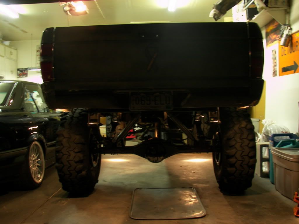

All ground down. Looks like were in good shape to save it with no patch pannels. so after grinding as far as i could go with out making it too thin and still getting as much rust as i could see out i threw some rust converter on it for the stuff i couldnt see. i had wire wheeled out all the seam seler and done the same in the seams. I reseamsealed it using self leveling so it looks smooth in the jam now. Plus it will give a better surface for the new tailgate seal to but up against(more on this later)
i took the pics of the tailgate work the weekend before i broke the U bolt so i will throw the pics in from fixing that. The bed was off and i needed to replace the ubolts. "If it aint broke dont fix it , If it is upgrade"(write that down)
Ubolt flip-check,Triangulated rear shocks-check, fresh paint-check,Drive on stuff to make the 90yearold neighbors freak out-check
you can see the tailgate in this one but its just primed i havent got the filler in it yet. I had to throw something on it tho cause i wanted to wheel last minute
still really straight for grinding and fixing rust and doing no more then a little metal shaping.
So this is where i leave you for today. I have picked up new doors new fenders and the rest will be kept. I know your thinking the rust in the bed side and that dent will be hell and so am i but its impossible to find a rust free bed side for a longbed with out going fiberglass. The plan is to make patch pannels and i have started them already. I think it will wait a few weeks tho. I gotta do the easy stuff first. Fenders,hood,doors,CAb,maybe some more interior mods. I did the headliner lastnight and am going to do new carpet before the dash fun starts.
