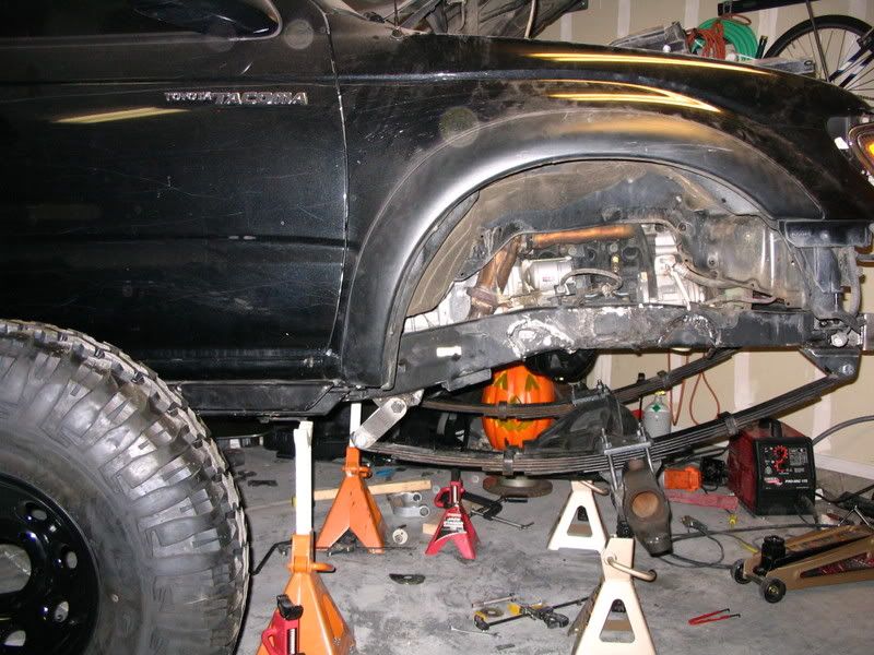

I had grand dreams of having a shop do a three link for me but then woke up and realized I owed a shit load in taxes this year. I had already re-geared the tail and had most of the parts i needed to do a leaf swap so I gave in and started cutting. HUGE thanks to wheelerjake for coming down for a couple of days and helping out with the cutting/grinding/welding. I should have her sitting on tires by this weekend and hopefully ready for kiddie trails at azrocks.
The blah blah stuff....
FROR kit minus the drop bracket to keep it low.
Marlin 4" springs, 14" bils 5125, used from taco1
35" maxxis bighorns on crager soft 8's
And the fun stuff....
Before pic on 35's She measured in at 20 3/4" to the ground from the front body mount, 21 3/4" in the rear
Jake welding
Front hangers on
finally done, what a pain in the ass!

Super WEEEE. Good luck on getting it ready for the kiddie trails by AzRocks. I'll be running some kiddie trails in mine too. Firday I'm supposed to lead a group on an easy run. Saturday should be stepping it up a little.

want hear here the most impressive thing - they had no plasma cutter or tourch! all cut off with sawsall and angle grinder.
Sawsall is how quite a few have been done. If done right, the saws all leaves less to clean up. They are not as fancy as a plasma, but a sawsall and grinder goes a long ways.

sounds like a ton more work to me.

a real sawsall would have worked a lot better all we had was a shitty ryobe battery powerd one
Yeah, that would be more of a challenge. Need more juice. Looks like you guys did a nice job cleaning junk up. Now get the rest done so us newb SAS drivers can all play on the kiddie trails together.

Got the axle hanging. Adjusted for the body angle its sitting at 48*. This the second attempt so im thinking about leaving at this. The springs are used on a Tacoma already so they should not sag much. Here is the angle, do you all think its worth cutting off and moving a half inch forward? I want to keep it low anyway, in the photo its sitting at 25" on the front and its about 2 inches high to mount the tires. I would be really happy to come it at 23" to the front body mount.
I think it looks pretty good, but can't tell how much weight is on there. I was just discussing this recently and here is a good thing to go by, measure your front hanger bolt hole, center, to top bolt center hole of the shackle, then measure center shackle top hole to bottom center shackle bolt hole. Add the 3 together. Mine come out to 47.25". The top bolt to bolt is 42.25" and my shackle is 5" My leaf springs are 47 inches long exact, therefore when my leafs are totally flat, I will not be able for the shackle to hit the frame as the total length is longer than the leafs. So if your 3 measurements are longer than your leafs, your good to go. I have never had my shackle hit the frame and I've had my leafs go past flat and into the negative arch. If my total number were 46, then I would hit the frame or come REALLY REALLY REALLY close to hitting.
Truck specs:2001 D-cab Taco with solid axle conversion, front and rear 65" wide Diamond axles, Tundra 8 inch rear w/ARB, H.P. front w/ARB 30 spline Long's, full floating rear from FROR and blah blah blah, IE lots-a cool stuff.

You castor looks like its going to be way off. You should only be at about 5 degrees + max. I don't know, maybe its just me, but it looks like its going to be off. You might benifit from turning the knuckles some to get the pinion up too. That would fix the castor issue and low pinion angle. I think guys are turning anywhere from 8 degrees to 15 degrees.

I have not set the caster yet. its just bolted to the axle right now. Did not want to mount weld the perches until its set right.
Thats good to know. I measured it last night but i cant remeber the exact number. I think I was just over 42.
42 plus the shackle bolts eye to eye is what you need to add up, those numbers should be longer than the leaf spring length, which is prolly 47 if you are using toy. spec'd leafs.
My Alcans and Marlins springs are 47. My measurements are 47.25
If I ever wanted to use Marlin 5 in lifts springs It would be a crap shoot for me, since his 5 in lifts leafs are 47.5 in long.
