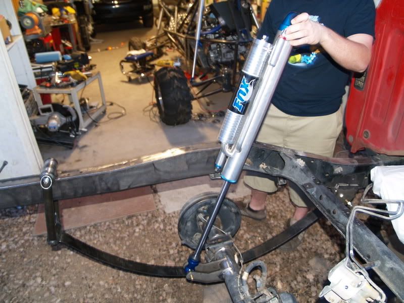

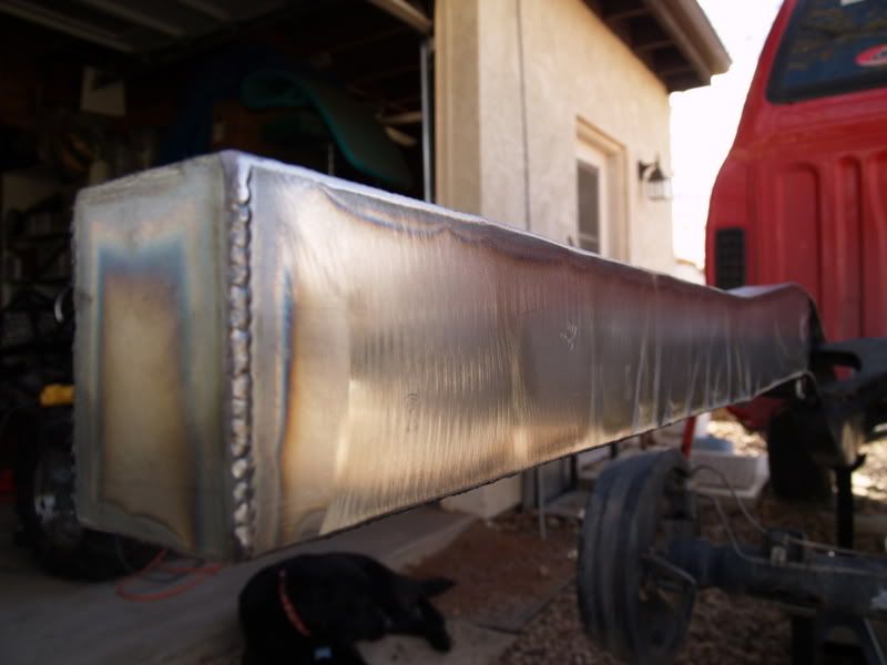

If you are on dezertrangers, you have probrably already seen this. Otherwise here it is.
62" f55 deavers
16" 2.5 dual bypass fox shocks
32 gal fuel cell- jaz
2 vertical spares
Its only wrong if you get caught
03 Prerunner v6 TRD ext cab
Total chaos long travel
16" Fox bypasses with 62's
Fuel safe

Cool dood, fixed your pics for you and I've been watching the madness on DR, looks good so far!

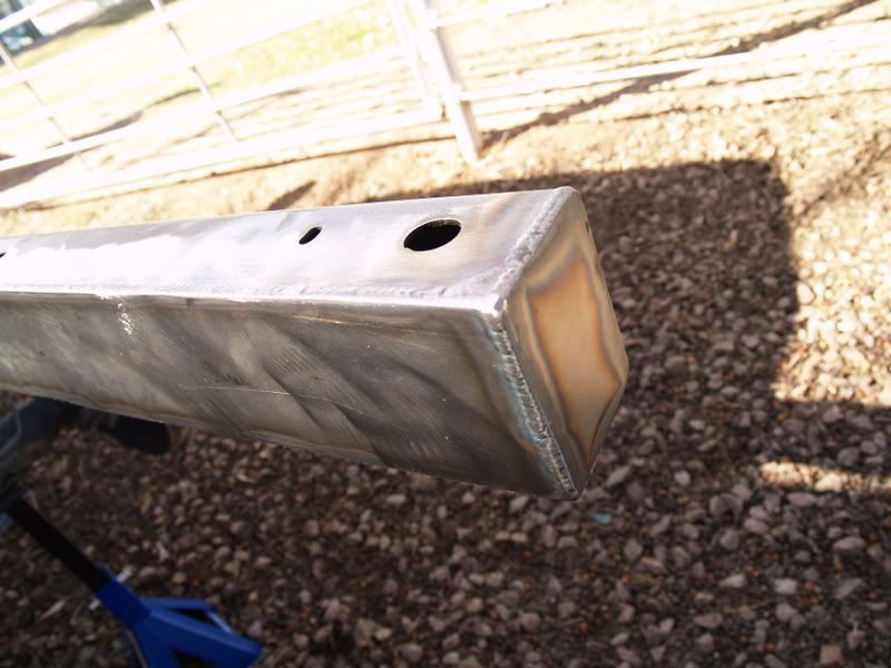

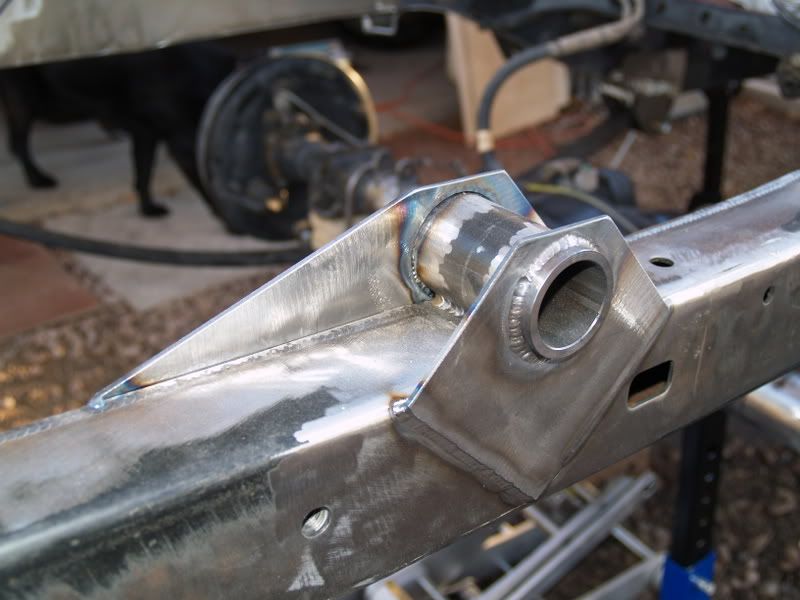

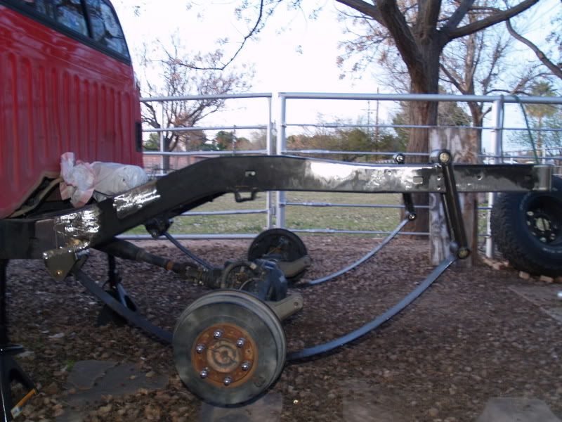

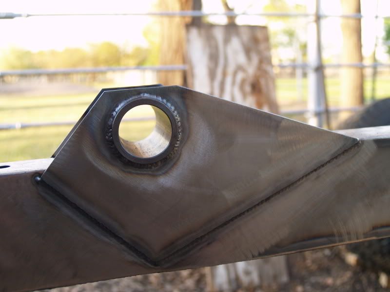

Frame boxing looks good. I'm sure you're planning on doing more to the shackle pivot but just to be safe make sure you do some gusseting that goes over the top of the pivot tube.

Agreed, I have some plate work on mine up both sides, that plus something wrapped all the way over the top should work. How it is now will rip your frame up for sure.

looking good but why didn't you just 4link it?

Those leafs set up correctly and valved correctly can out run a shitty link set up in the rough stuff.
Plus a link set up is more time, money, and room for error when your a green fabricator.
*I'm not calling pinky a bad fabricator but he might know enought about Link set ups yet*

Matt Helton is the current 1450 champ and he runs deaver leaf springs in the rear. Of course they are set up and tuned propperly. He beat out many other trucks that were linked in the rear. Obviously high end trophy trucks do have properly set up links not to mention center mounted a amrs and so on, but if properly tuned deaver 62's and a set of bypass shocks can do just as well as a linked truck.

yes picks needed cause I'm on the fence with either a canti setup or run 12's and limit the travel to about 14 when I go 62's.
Bob your dumb, I was obviously referring to a Toyota or other production truck.
But in the late 80's class 8's where the faster vehicles in the desert and had to run what the truck had stock IE it came with leafs you needed leafs. To get around this guys ran a elliptical spring off the front of the axle kinda as lower links and then ran coilovers and shocks on top of the axle.

Actually a quarter-elliptical setup doesn't use coilovers, the upside-down leafs running off a roller on the axle support the weight of the truck, and bypasses coming off of the axle or trailing arms control the damping. Basically a 3 or 4 link setup but instead of coilovers on the trailing arms they used a large (like 23 or 24 something leafs) leaf pack cut in half and ran upside down. Pretty funky setup, but pretty sweet when setup right.

biggest problem with this set-up was the leafs would always break.

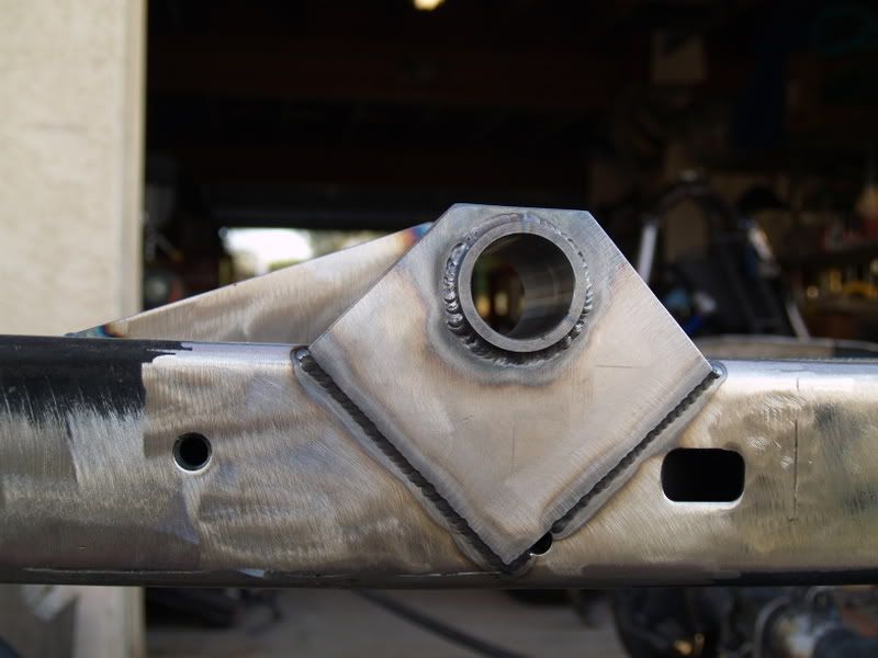

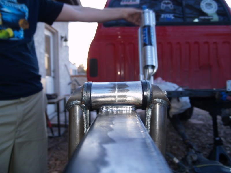

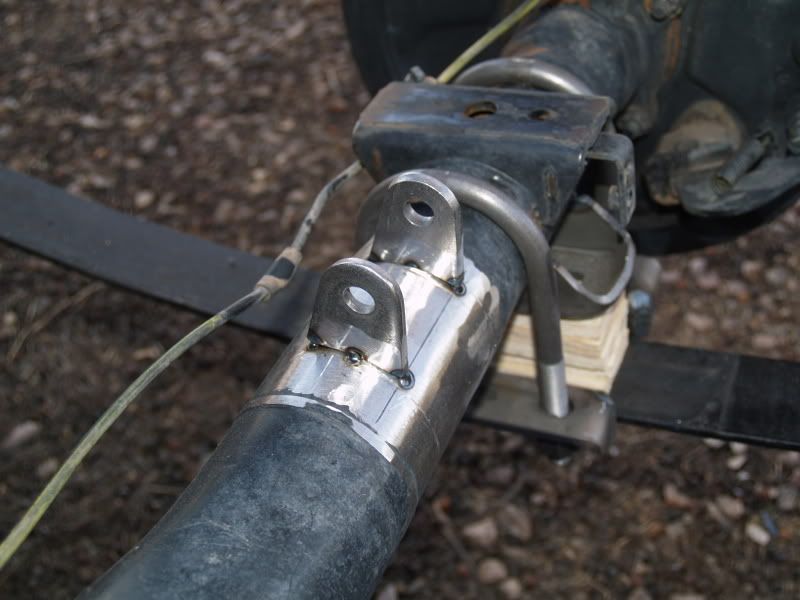

Update
Slow progress but we are starting to get everything together. Being poor and building trucks dont mix! The cage work will start tomarrow and the fuel safe comes in next week. Let me know what you guys think.

Are you going to plate in as much of that shackle bracket as you can?

are you going to put welds on the inside to make it stronger?
