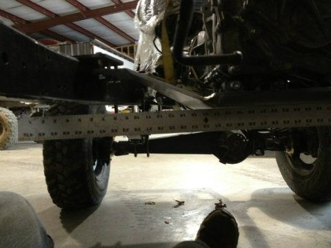

It's rolling.... Gotta figure out what to do about the steering shaft. 2wd shaft is different. No weight on the springs, so the shackle angle is off. Possibley pulling a leaf from the pack. Still have to buy metal to plate the frame.
Steering box mount, box moved forward far as I could.
Hole in front clip to clear the box.
Dirty front axle. Got an 85 housing that will be cleaned up, trussed and armored.

Who's hanger? Marlin's came with two small gussets that run from the top of the spring pocket to the body mount pockets. I never used them, as they're for IFS rigs, but may still have them if you need them.
Also, you may want to consider bracing from the hanger back to the frame with a small amount of angle-cut square tube... hope that makes sense... May break out the paint skills in a minute
Lookin' good, Sean!

The gussets were talked about today. Being that it is a 2wd, the body mounts are different. So the gussets that came with the kit don't fit. It's a pretty small space and I need access to the body mounts. We'll come up with something creative.
Show me some of those paint skills fool, on the bracing.

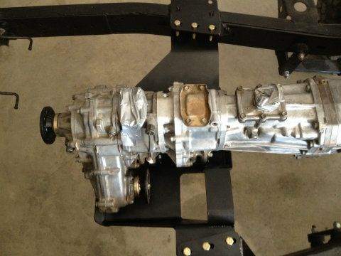

Marlin's Heavy duty 1,200lb clutch kit.
Marlin XD-07 dual cases adapter with Marlin 4.7 Competition gears in the rear case.

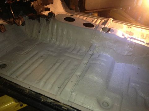

Floor cut for the driveline.
Did a floor lift for the center console to keep it looking factory. Did a few coats ceramic heat and noise reducer.
Then sprayed the bed liner material with Raptor liner.
