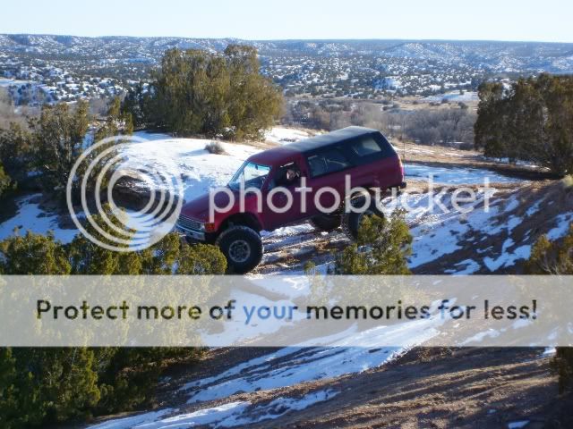

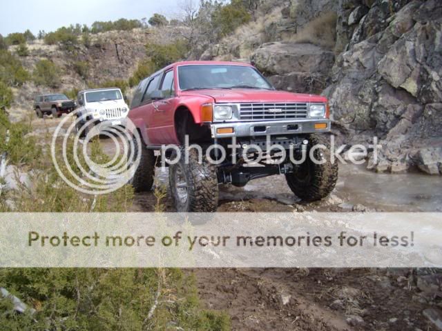

First Trail run:
First run out in Socorro: BHD

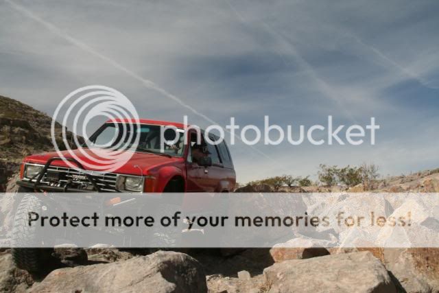

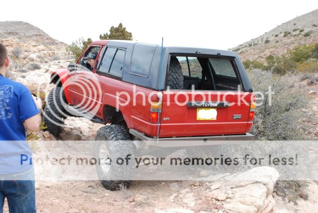

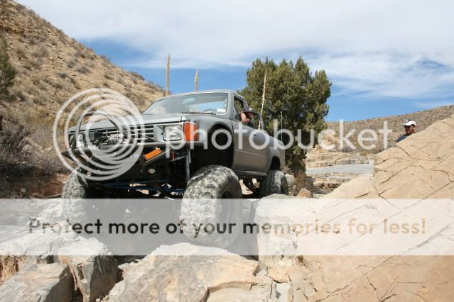

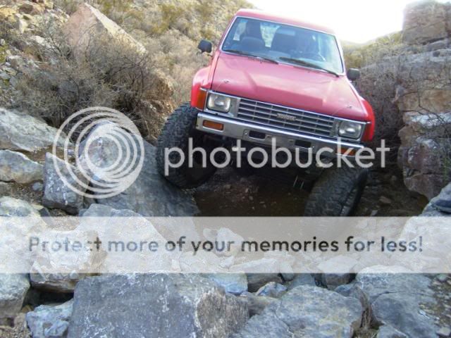

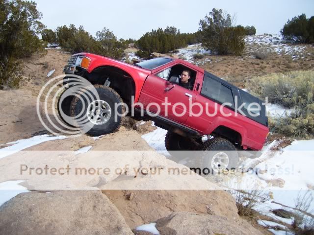

So initially began fixing up all the minor problems. New crank seal, window regulator, etc. Really wanted to armor the runner first so Ended up purchasing Marlin Crawler front bumper and picked up a used Chicago electric winch with synthetic line. Began building a rear bumper with wrap around protection.

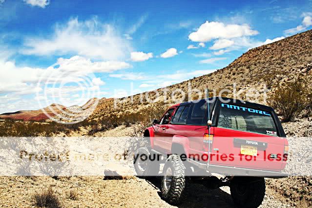

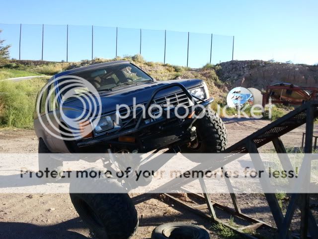

And wheeled the piss out of it:
Ran in The NMT MudBog I helped Organize
Oh ya and was featured in 4WheelDrive Events Page for the 2010 Chile Challenge

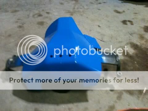

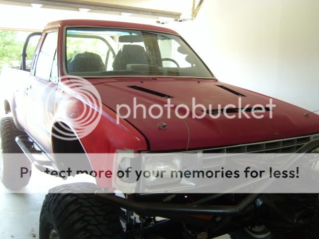

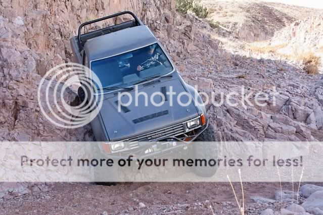

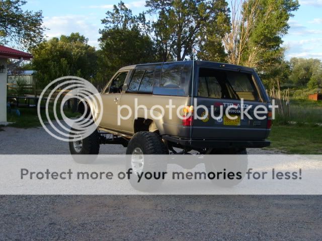

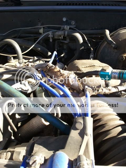

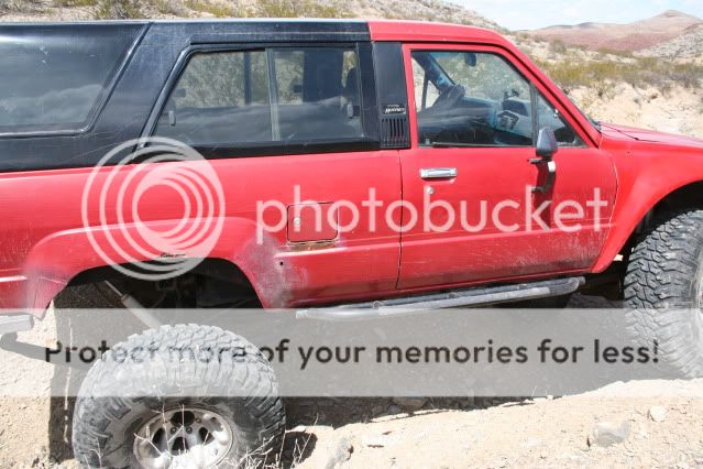

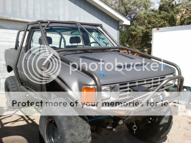

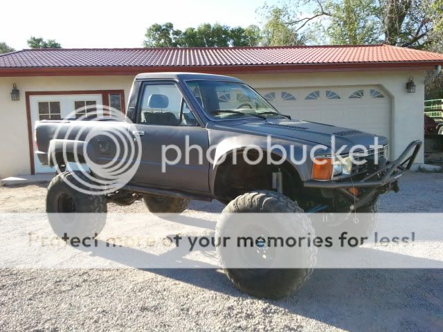

So pretty much that summer of 2010, really needed a front locker, so got a used lockright, installed in front diff. Fairly simple install, had done a few of these already in my taco and my cousins pickup. Fully locked now and yes still with stock front birfs.
After plenty of trail runs, found out with the turbo in there, engine bay was getting super hot, enough to damage my spark plug wires. So to fix this got a set of Taylor High Performance High heat Spark plug wires and a turbo wrap to contain some of the heat.

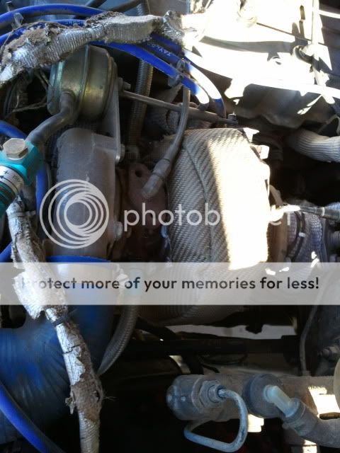

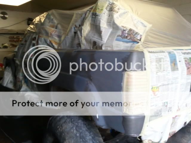

The rust on the runner was pretty horrible on passenger side, the usual locations they all seem to get it. Right above wheel tub and along gas door. So my first real sheet metal work. Cut out rusted area and replaced with new sheet metal. Also shaved off mirror locations/holes.
Not a huge fan of the color RED, especially with mine so mismatched with the fiberglass front fenders, and decided to repaint the entire 4runner. Using HotRod Flatz Gunsmoke Metallic. Its a urethane based pre-flattened ready to spray low-gloss color with the desired satin primer appearance. LOOKS TITS!
Also took this opportunity to add hood louvers to help exhaust some the heat created from the turbo.
Finished Paint

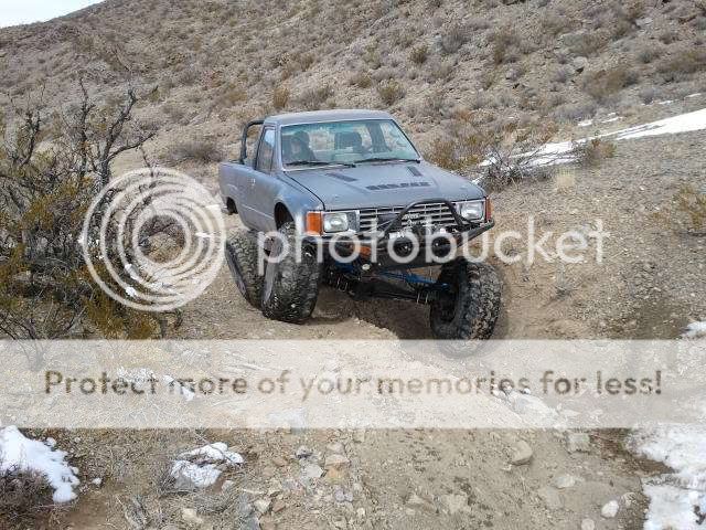

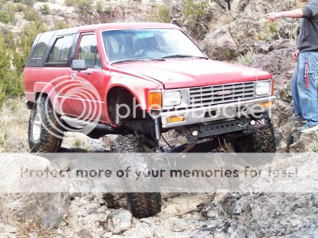

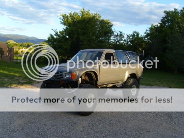

Wheeled her like this for long time, picked up some cheap baldish Iroks and sold the MTR's. The 'well experienced' Iroks actually hooked up a lot better than the MTR's ever did out on the rock in Socorro NM. mostly fossilized rock.

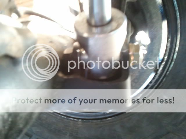

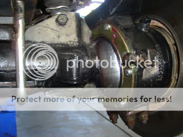

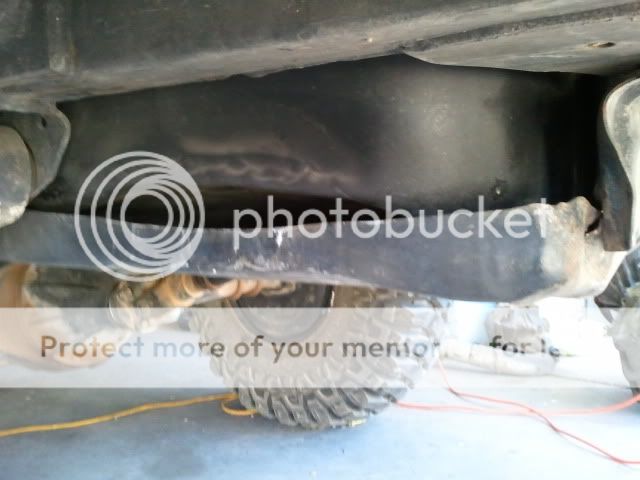

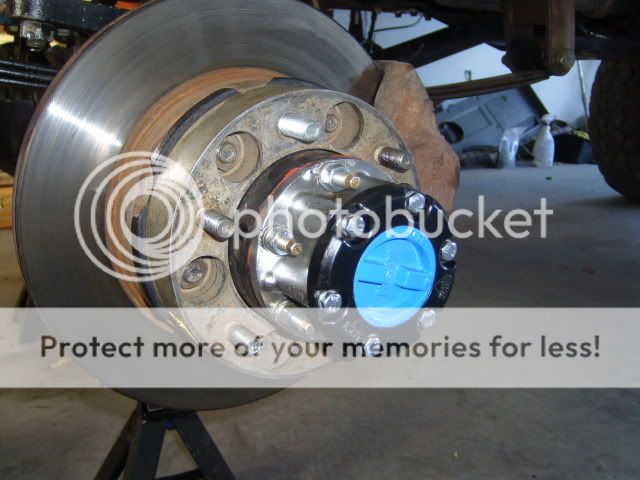

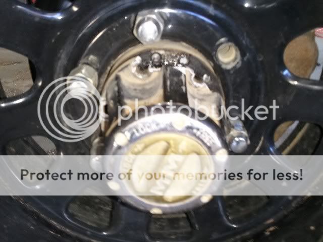

First real damage on the trail. Blew up a MM hub. This hub did not use stock cone washers, which allowed some play on the studs. Ended up shearing all 6 of them and blew up hub body.
So I tried to use an easy out to get the broken studs out, and got all but one. Decided to get another spindle assembly. At that time, was able to purchase a single MM hub and replace it for now. In time plan is to get arp studs and go back to original asian hubs.

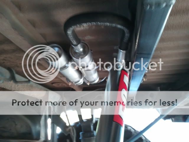

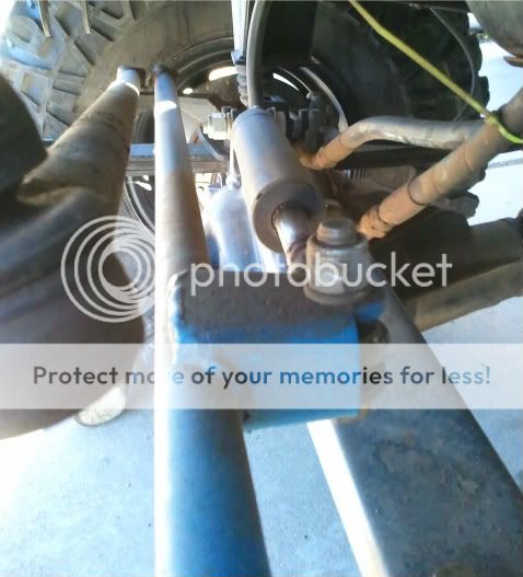

Hydro assist is in, went with TG's kit and taped box myself following the thread on marlin crawler. relatively easy install, did add a steering cooler that I got from summit and also a larger reservoir, picked out of the junk yard from a Isuzu rodeo or something of that sort.

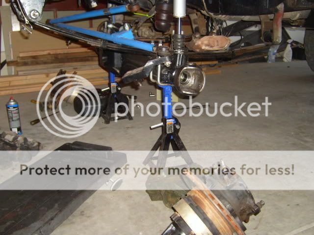

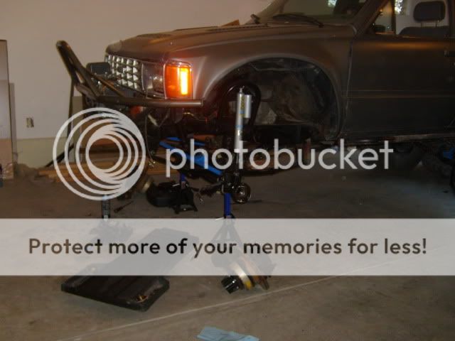

Time for LONGS...

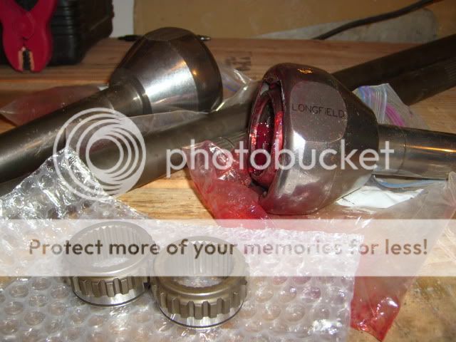

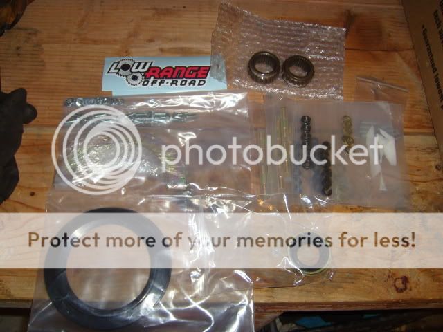

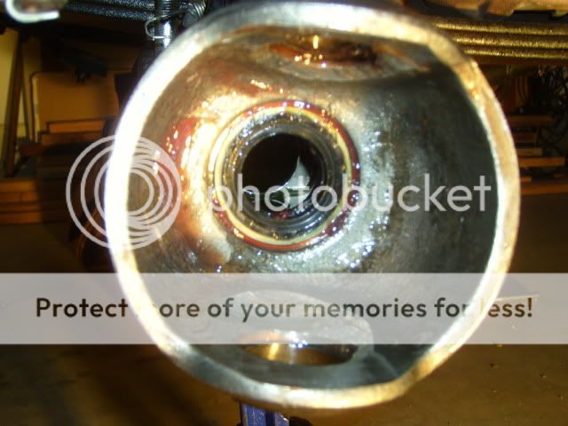

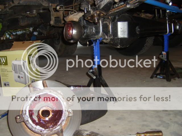

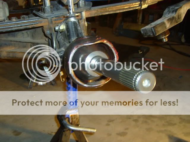

Had been wheeling stock birfs fully locked, hadn't broken one yet, but didn't want to deal with the hassle on trail. Found a good deal on some used longs off of Pirate, and ordered up chromo 30spline hub gears, arp hub studs and Trail Safe Knuckle Ball Wiper Seal. Also picked up some Asian hubs from a buddy. Used the camo method...
So it began..

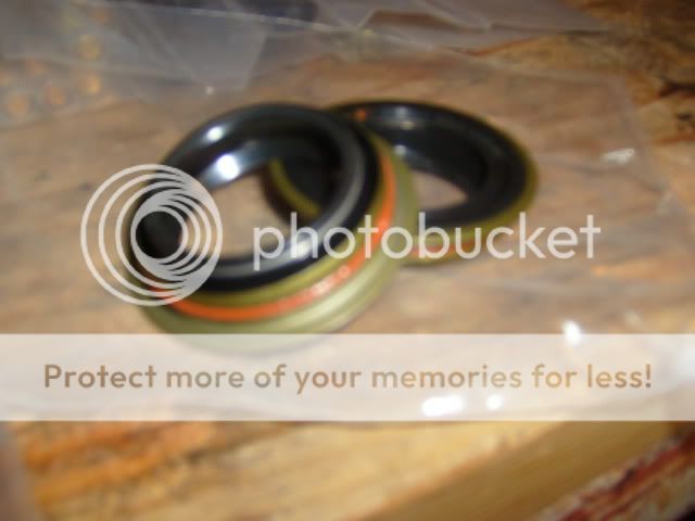

Marlin crawler Eco seals..
LONGS in with trail safe seals...
ARP hub studs...

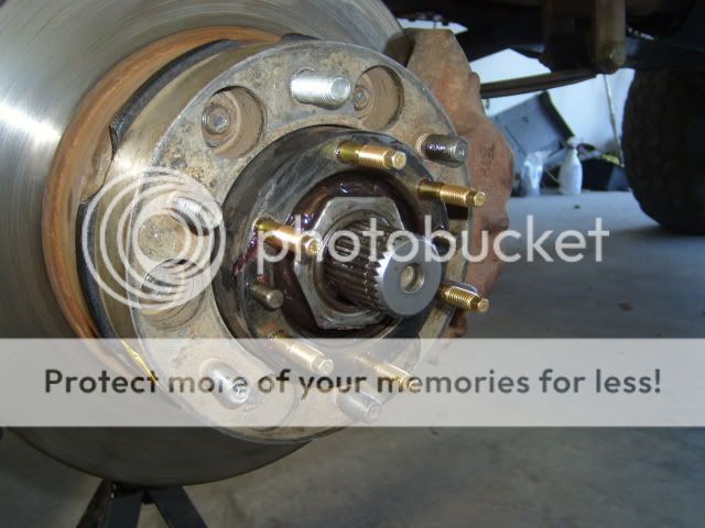

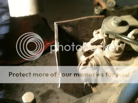

So i ran into a few problems with ARP 2000 Hub Stud Kit
First of all they were super easy to install with the hex head. But when I began torquing down the nuts they kept stripping before I reached the right torque range. I had issues with nuts stripping, but that was easy fix, Stock nuts would torque down no problem,but I didn't have any. I needed my truck, So I fixed it with local hardware Of course I could have contacted trail-gear and Im sure I would have had excellent customer service like always.
I know all the controversy over whether the hex head is on the right side and what not, but When I installed these taking out old studs with double nut was ridiculously tedious. The hex head head design was nice feature and IMHO saved time and effort.

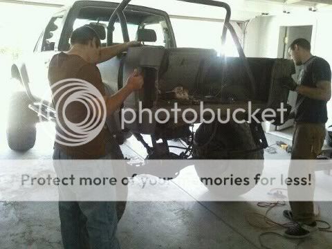

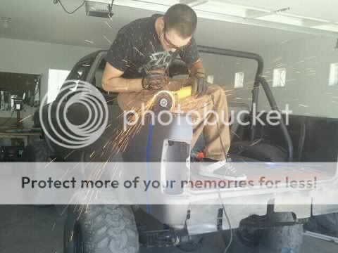

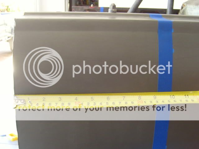

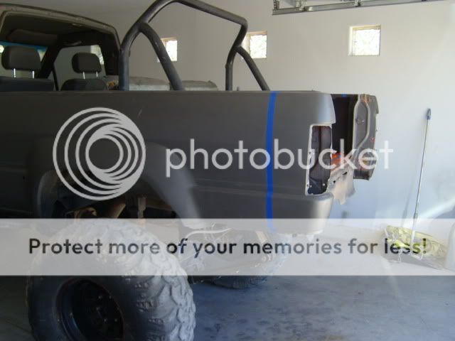

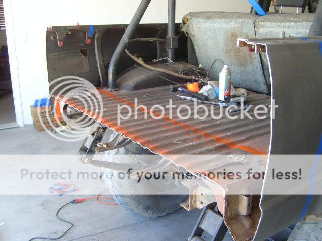

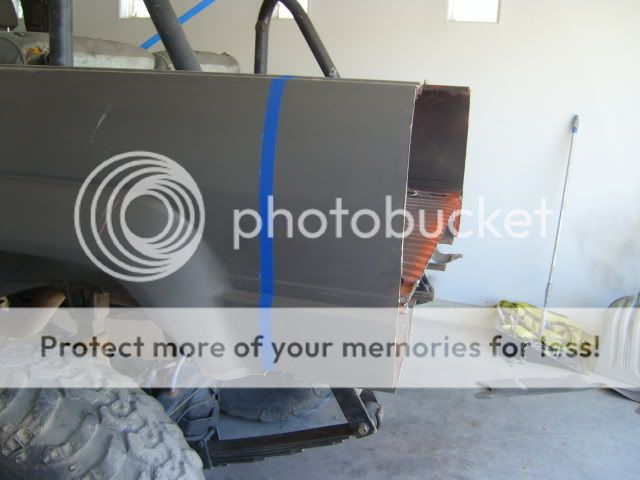

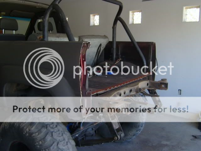

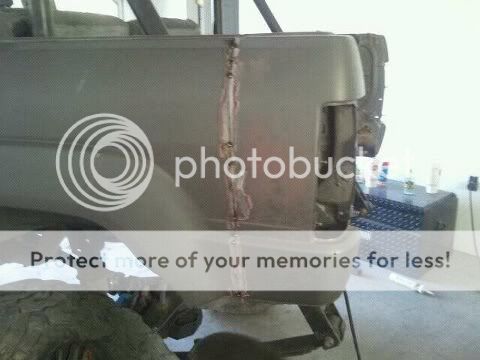

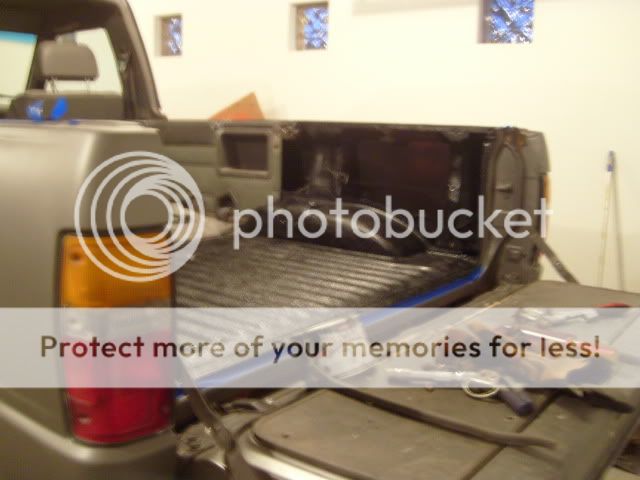

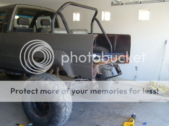

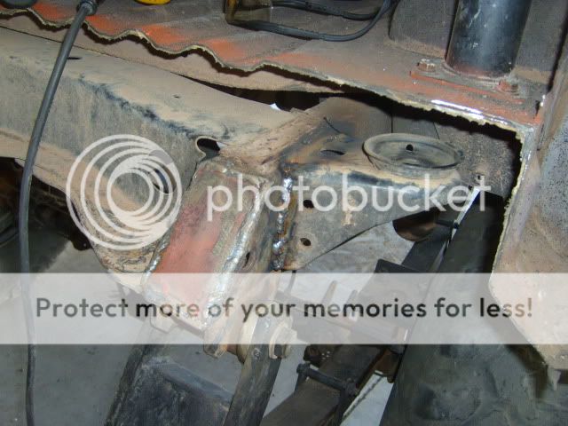

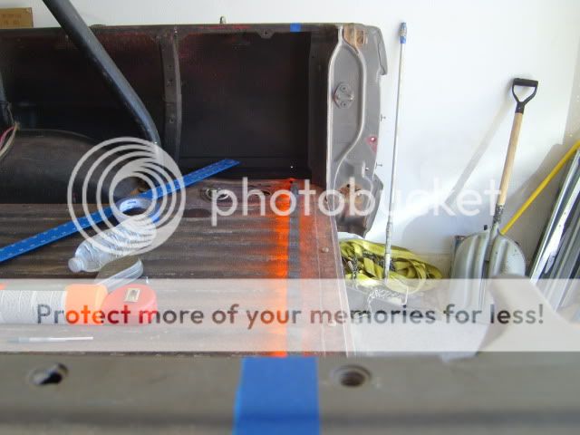

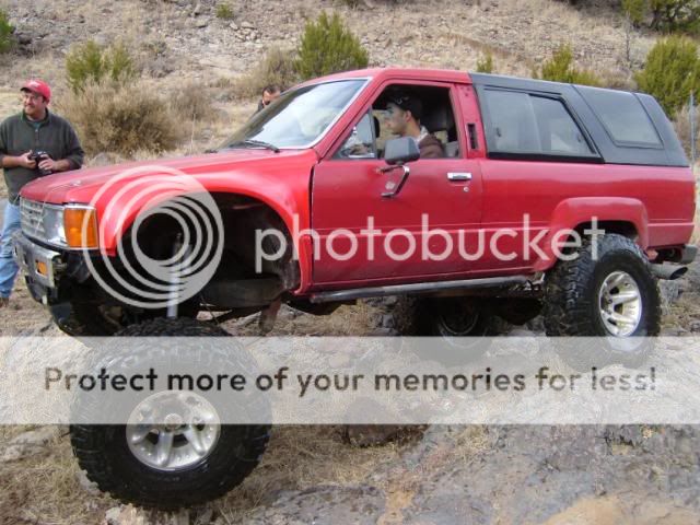

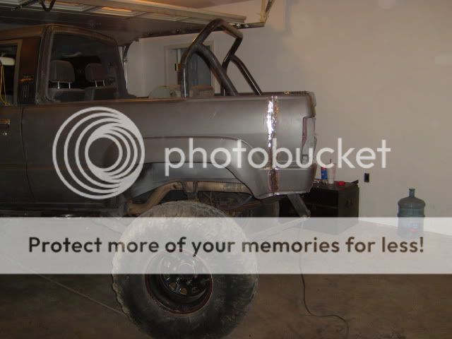

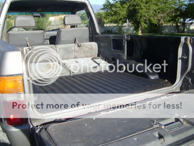

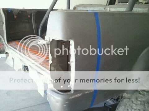

Finally decided to Bob the runner...

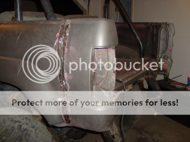

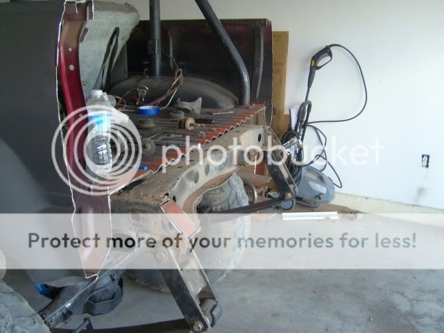

Got kinda tired of dragging rear end, So began taking measurements looks like 10in would be max I could cut out with a fully functional tail gate. Me and my cousins began hacking it up, and welded it all back up together. Took 12 hr in the garage and some lunch.
First line marked...

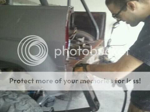

Cutting began...
Second line 10in forward...
Chopped off excess boxed it in, remounted body mount...
Began piecing it back together...

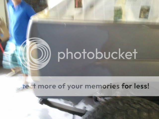

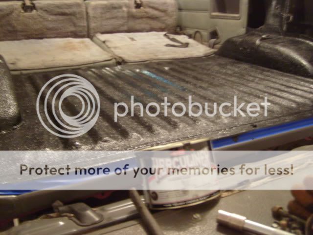

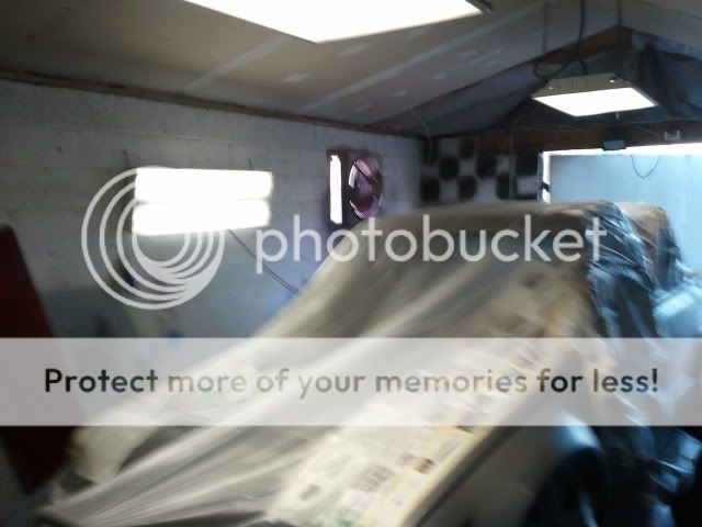

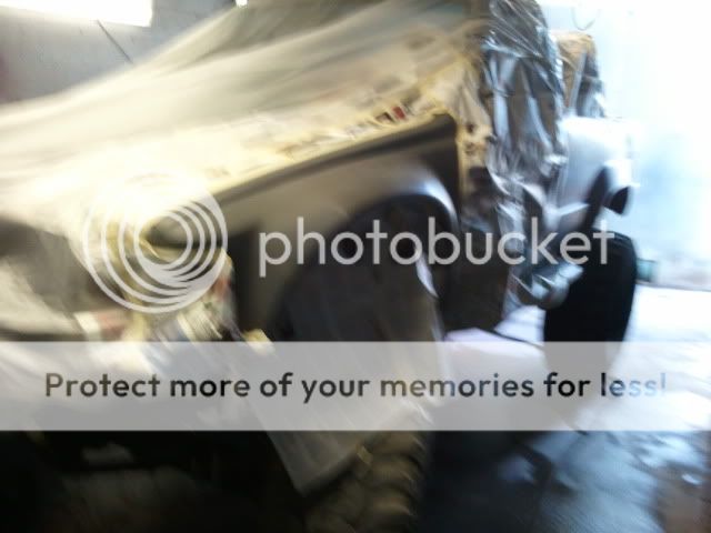

Getting repainted... Touched up other minor areas.
Used some seam sealer to smooth over inside welds, and Hurculined bed area

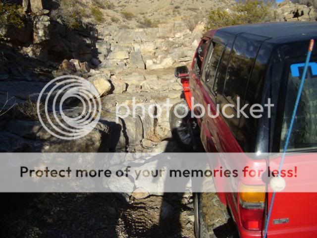

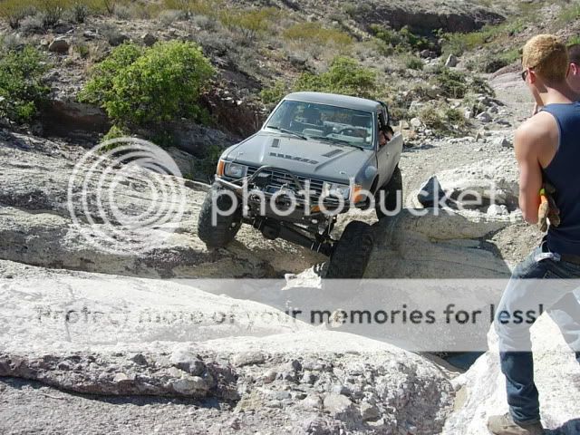

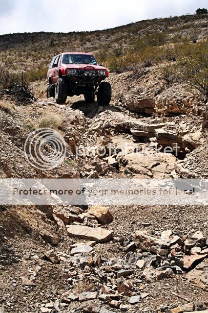

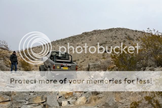

Went wheeling,
COTTORA Takeover
Hit up Rio Puerco
No photos but did get some video footage...

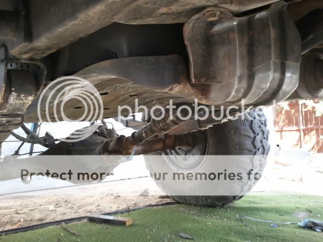

On the ledge slammed my gas tank pretty good.
Check out the Video Here
Straightened the skid out for the most part

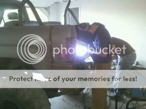

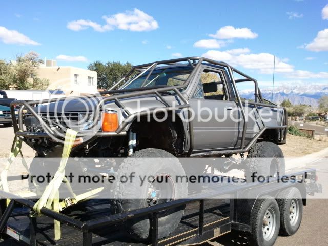

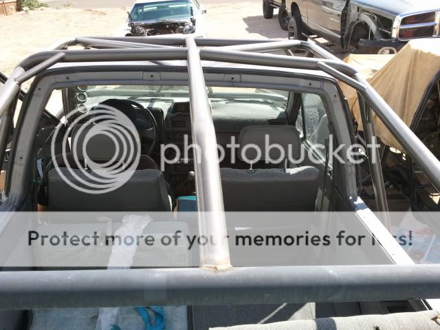

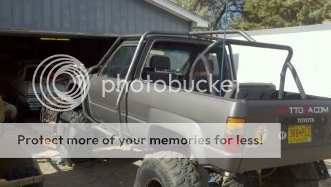

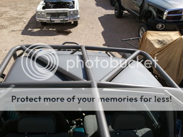

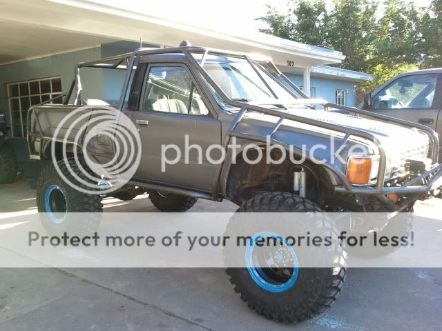

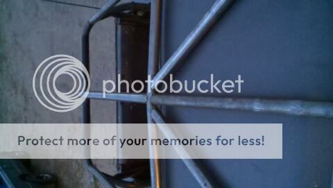

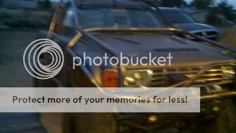

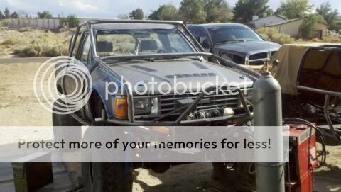

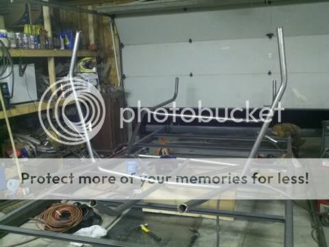

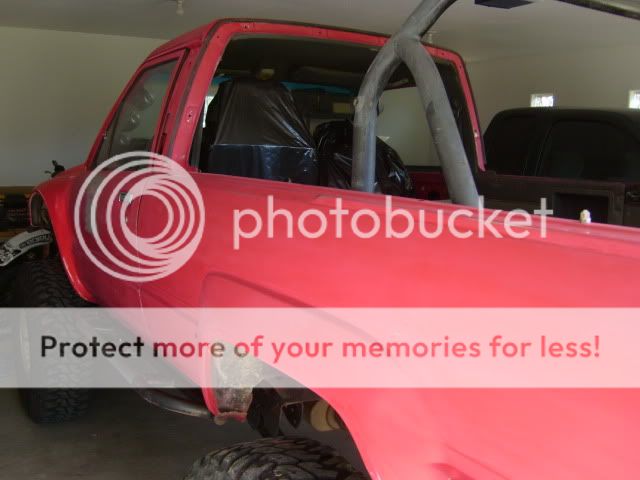

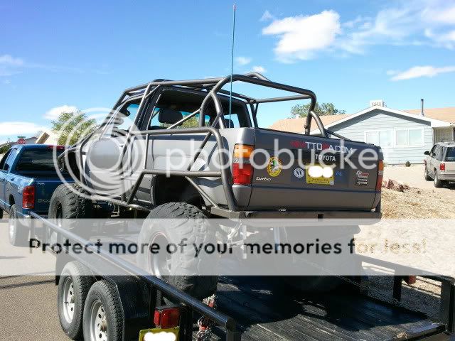

So It was time to get a cage, I played with the idea of Inner vs Exo for some time. The trade offs between the two And when it came down to it I feel that extra protection of the body is well worth the extra tube outside.
So had a buddy of mine who primarily does Baja type stuff build my cage.
He goes by DNA Fabrication out of ABQ.
All steel is 1.75 inch .120 DOM tube and 1 inch .120 DOM for gusset stuff.
Pulled off to weld bottom side.
Welding cage on
Back got finished and painted cage all up

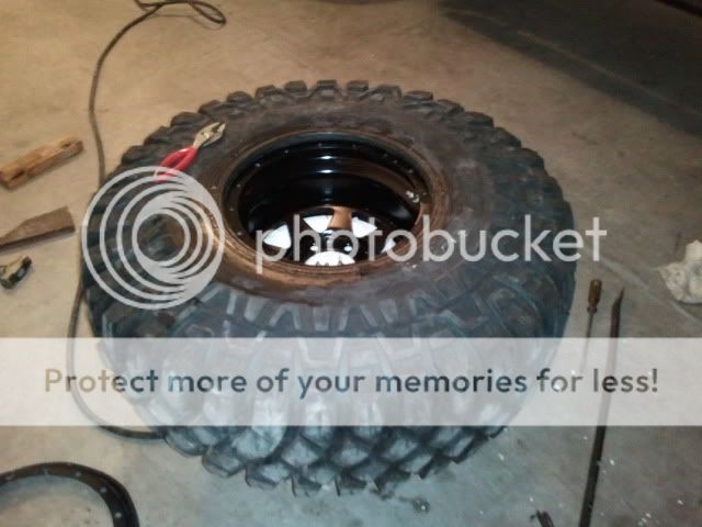

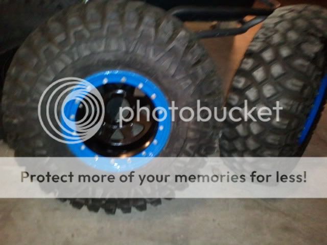

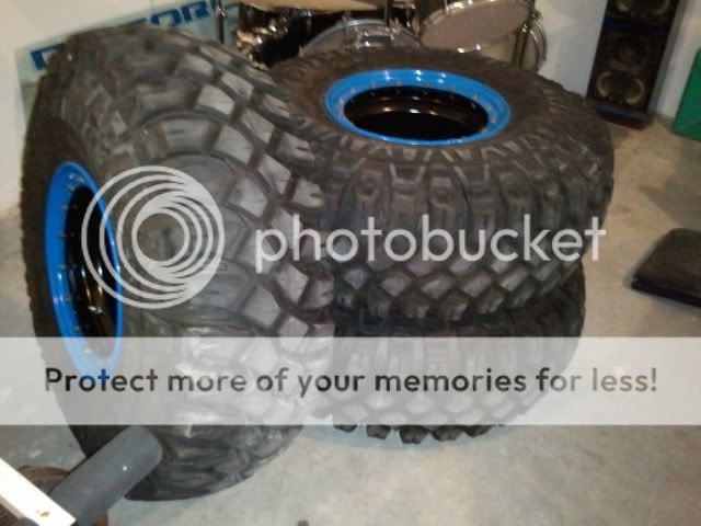

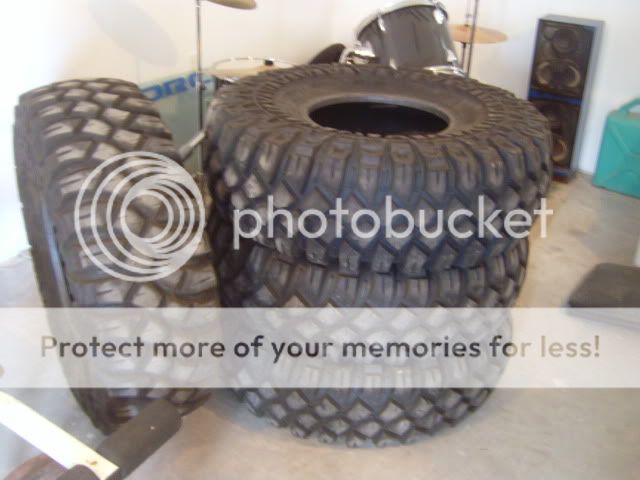

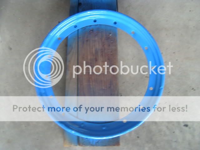

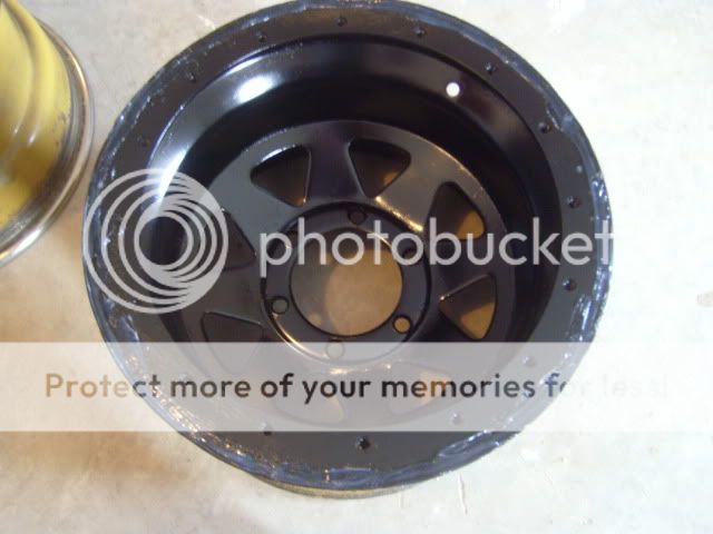

New Tires YAY!!
MAXXIS CREEPY CRAWLER 37 12.5 15

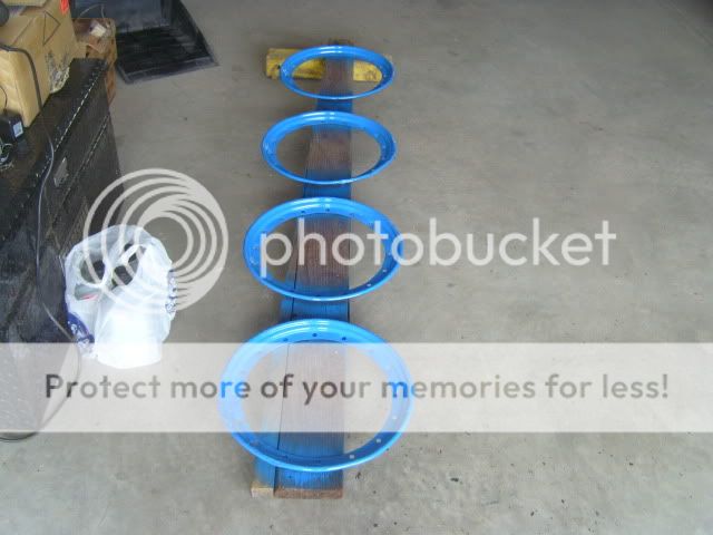

Picked up some used beadlocks for really cheap. They were a pretty crappy yellow color, kinda see on the inner of the rim. So stripped all that off and painted with some good old Rustoleum. Painted up rock rings to match.
Only complaint I can see is these are the 16 bolt Bead locks and the rings are kinda thin steel.
Getting them all mounted up...

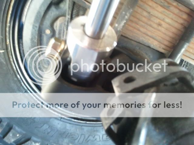

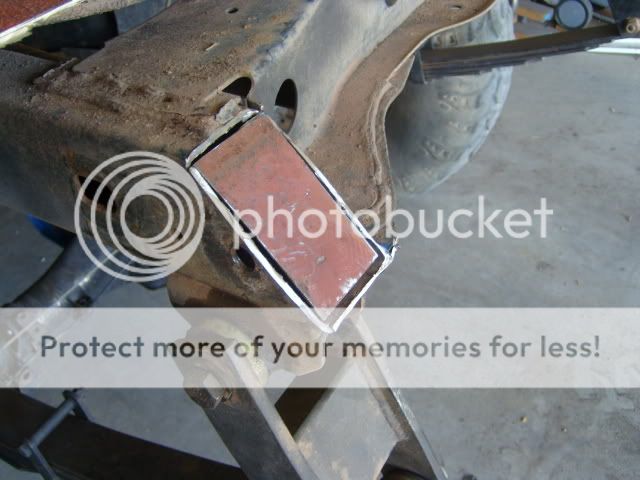

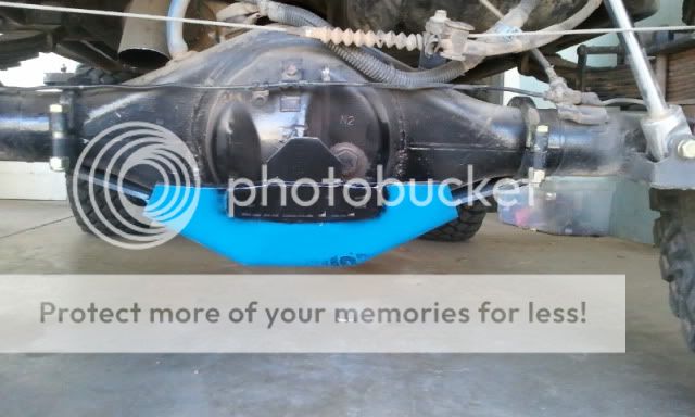

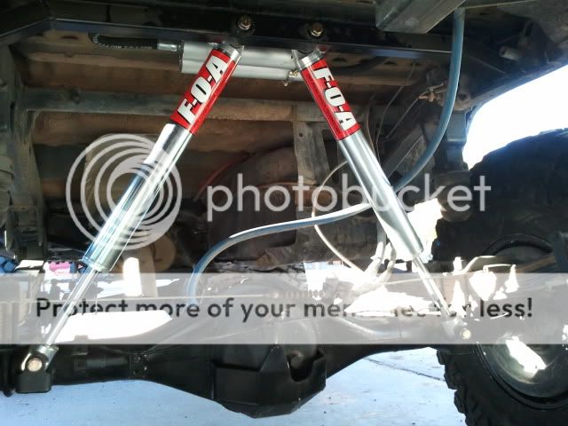

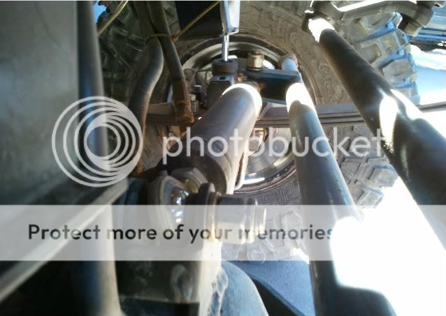

So with the runner back home, began working on rear shocks. Wanted to do /\ triangulated pair in the back.
Fabbed up an upper bracket out of some square steel. Drilled out a hole and sleeved it with some weld washers and a bolt sleeve.
weld washers I used
Bottom brackets are axle side shock tabs, welded nut on the back side.
New 14inch 2.0 FOA remote reservoir shocks Installed...
To mount the ressi's I used some sweet tabs from poly

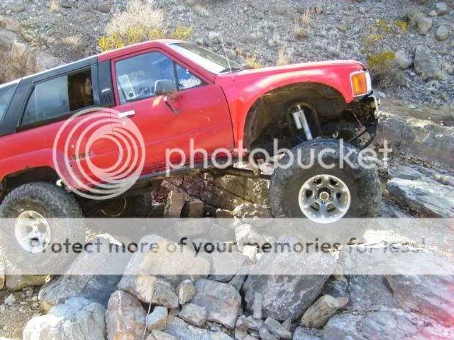

Tires finally on the truck
First run with the cage/tires Socorroween 2011

Looking good. If your worried about the beadlock rings, you could weld a rolled piece of round stock in the lip of them to stiffen them up a little. Also, you can take 13.5" inches out of a 4runner and still have everything functional.
94 SC300 She boogies
86 4runner turbo diesel swap Now has a 1UZ
me_tu05 is offline
post #20 of 111 (permalink) Old 12-20-2011, 04:21 PM Thread Starter
Moderator
RiskyRicky's Avatar
Location: Santa Fe, NM
Posts: 467
Send a message via AIM to RiskyRicky
Thats a good idea, kinda like an anti coning ring. Ya i probably could have, but I thought 10 was good. Made things easy.

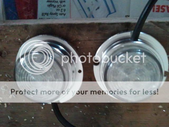

Rock Lights...
Looked around for good lighting solutions and this turned out to be the cheapest and had some fun factors.
Purchased VisionX Tantrun Light kit. There pretty rugged fully sealed LED lights. With aluminum mounting casing. The mounting screws are ridiculously tiny so I drilled them out to use a #6 self taper. The lights have several strobe and pattern affects which are fun for around the camp.

Love the truck & the buildup, but the cage looks like shit. So many un-needed little dinky braces.

To each their own, I know many people are not a fan of exo cages especially on Toyota, but I wanted practicality and protection over looks. I think my cage came out awesome and is supported where needed. The only thing I would probably change is to maybe try to get the cage closer to the body next time.

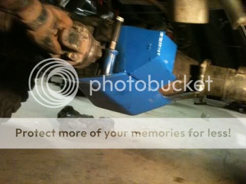

So bought a BAMF Diff Skid but wanted a bit more protection for the E-Locker
Here is the stock skid
And the pieces I added, tacked in to place
Plenty of room for Elocker
Pulled it off to finish weld
Painted skid to match

Very nice truck. I'm not a huge fan of he exo, but to each his own. The rest is simple and clean and functional. love the color also.

Nice rig man. Where did you pick the Creepy Crawlers up from and how much were they?
05 Taco - SAC'd HPD44 - F.O.A. Coilovers - Armored and Locked.
99 Cummins - Workin towards 1,000lbs Torque
05 GSXR 750 - 20th Anniversary - My Coffin
I'm Brown And I will Rule The World One Day.
hawaiianbro is offline
post #29 of 111 (permalink) Old 03-02-2012, 04:05 PM Thread Starter
Moderator
RiskyRicky's Avatar
Posts: 467
Thanks, I got the Crawlers off of Pirate4x4 for like 1200 shipped. They run about 450 new a tire. I always see a bunch for sale on Pirate, I would look there.
So far I love the tires, they are pretty beef. Lugs are quite massive and have that clean square look rather than Iroks which end up looking like giant balloons. The sidewall on these tires is like 1/2 in thick.
