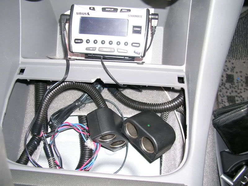

With all the 12v accessories like cell phones, satelite radio, GPS, etc. my console was getting cluttered with cords. I went out and got 2 multi-outlet cigar lighter adapters. One is constant 12v from the aux batt. and the other is ignition switched 12v from the aux batt. Now I can plug in my semi-permanent accessories and hide all the wires uder the cup holders.

i was considering doing something similar, but I did not know that the cup holders came out like that. Do they just pop out?
Also, is there an auxiliary switched power wire anywhere in the truck? My jeep had one, and I want to put an extra (hidden) 12V plug somewhere in order to clean up my satellite radio.
338 Posts
The cup holders pop out with little effort. The switched wire is stuck into one of the empty fuse spots on the drivers side.

I'm looking to do a clean install of a VHF radio in the cubby hole where your sat reciever is. I have to run the power/gground wires, as well as the larger antenna cable.
Can the cubby hole be removed as well? I wanna place the VHF where your sat box is, with all wires/cables hidden behind.
Minimal drilling as well!

I dont think the cubby can be removed without removing the whole center console, I tried today. I wanted to put a series of switches accross the front of the cubby, but there is no depth behind it due to the heater duct.
To get to that cubby hole you have to take out the whole console. Its not hard. Four black screws near the shifter and two bolts inside the storage compartment (under the carpet).
There is not much space directly behind the cubby on the right side. A little more on the left.

A little update: I converted the stock cigar plug on the right side to full time 12v and used the switched power that used to go to it to trigger my relay for my switched 12v from the aux battery.
With this mod no need for the wire to the fuse block any more.
