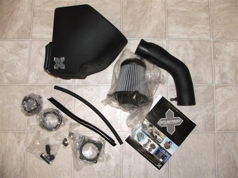

After a somewhat long wait, I finally took shipment of an Outlaw intake for my 03 2.7L 4wd Taco. Keep in mind that I'm writing this with Joe Shmoe in mind, If your a master welder and fabricator, don't bother reading.
I'm not too much of a mechanical person - I can do a car stereo...wire in a amp, My friend and I did my spring packs... I'd say my Automotive skill ranks somewhere between your older sister, and the 15 year old zit faced freshmen pumping gas at the local service station. :D
The removal of the OE intake stuff was pretty straight forward. The instructions were comprehensive enough so I could navigate my way through with very little problems... The only snag was the instructions did not mention this clip holding the MAF wire loom behind the resonator tube.

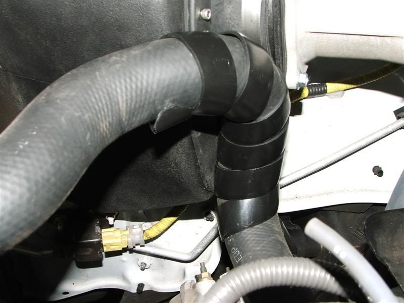

Test fit the air cleaner box, note where it "comes close" (read comes into contact) with the upper radiator hose... wrap the hose with the supplied wrap BEFORE you screw the box down... it'll be damn near impossible once the box is bolted down.
It's a good idea to trim the sharp corners off of the wrap too... It's a little sharp, and you don't want it to rub a hole in your hose...

The only other concern I have is the airbox is smashing up against the upper radiator hose. Outlaw does supply a hard plastic loom, but I am afraid that given enough time and vibration it will eventually rub through. I also noticed that because the hose gets so hot, the heat is radiated/transferred to the box. The airbox was warm to the touch in the area surrounding where the hose is in contact.
