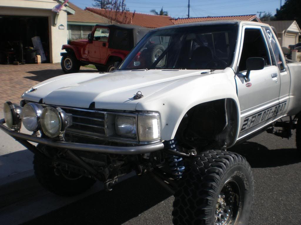

Hi everyone, Im new to this site but not new to the desert/ offroad world at all. I have owned this truck since i was 16, and plan to keep it for a long time to come. It has gone through many stages starting at a simple daily driver. Im not going to cover every step of the way here, but a simple recap with specs on its current setup.
Back when i first got it:
Didnt take long before i had it in the dirt:
Averaged taking it out about twice a month through almost all of high school while i contiued to dump every penny i made into it.

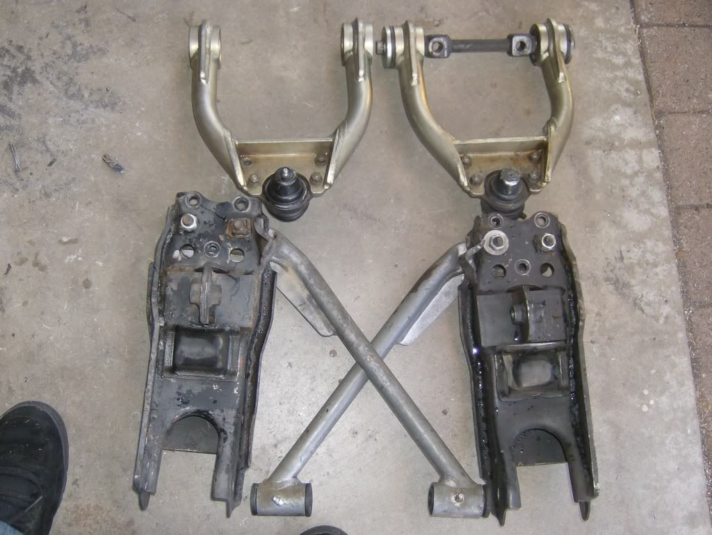

It was time to sell off the super reliable downey kit in favor of a used Duffco kit
old front end off
Installed the new front end, reusing the old torsions and white rocket shocks

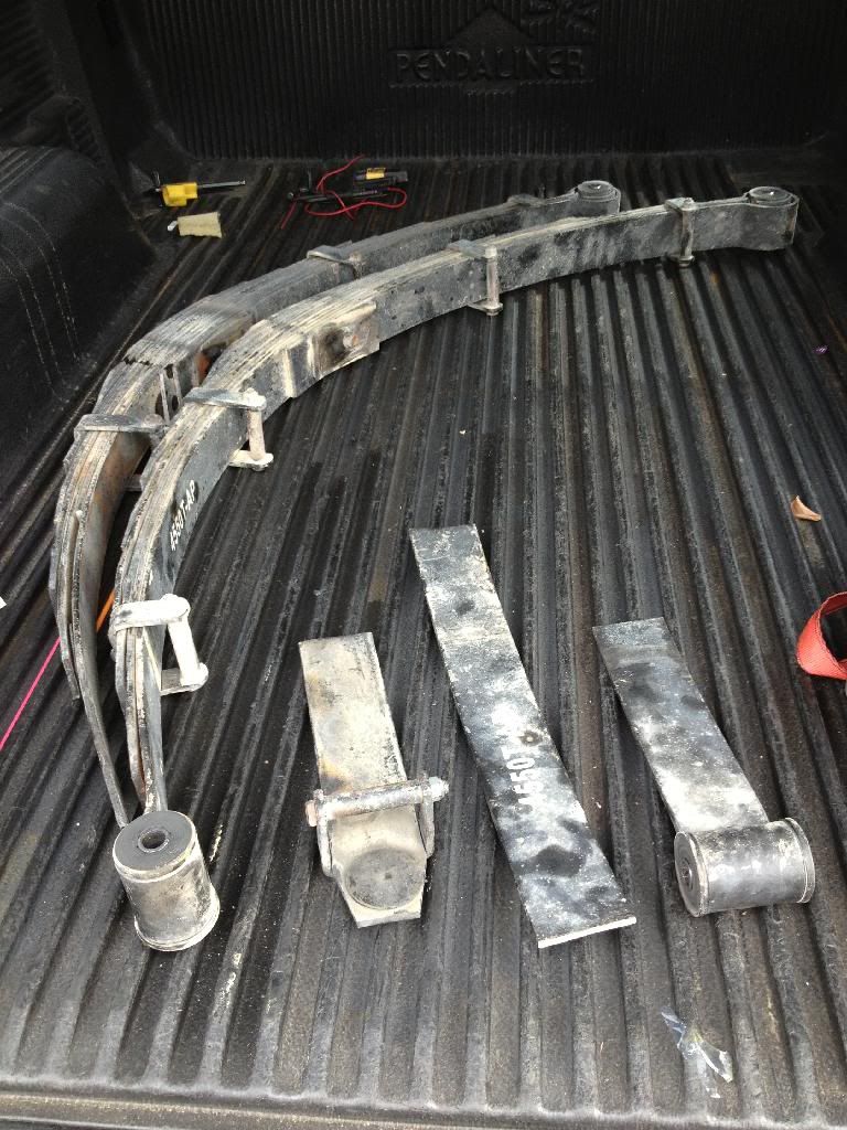

Continued running that front end for a few years while adding to it. Built some lift spindles for it using T100 spindles, put All-Pro 50T leaf packs on the back and FOA 2.5" smooth bodies (still on torsions)

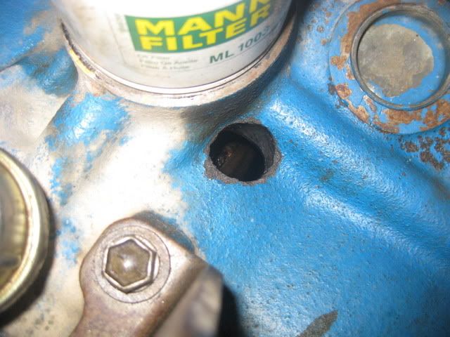

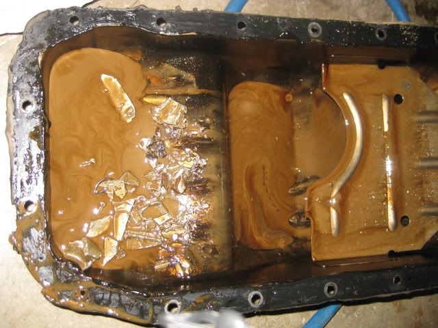

Next big high light was a hand grenade going off in my motor :mad:
Not really surprised though, it spend MANYYYY miles wide open and 5500 RPM. At this point it was still my daily driver putting about 75miles per day on it. When the motor let go i decided to bite the bullet and get a dedicated DD and take this thing to the next level.

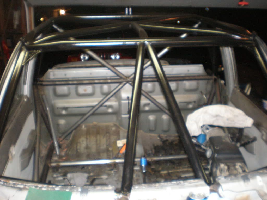

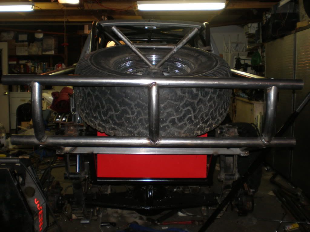

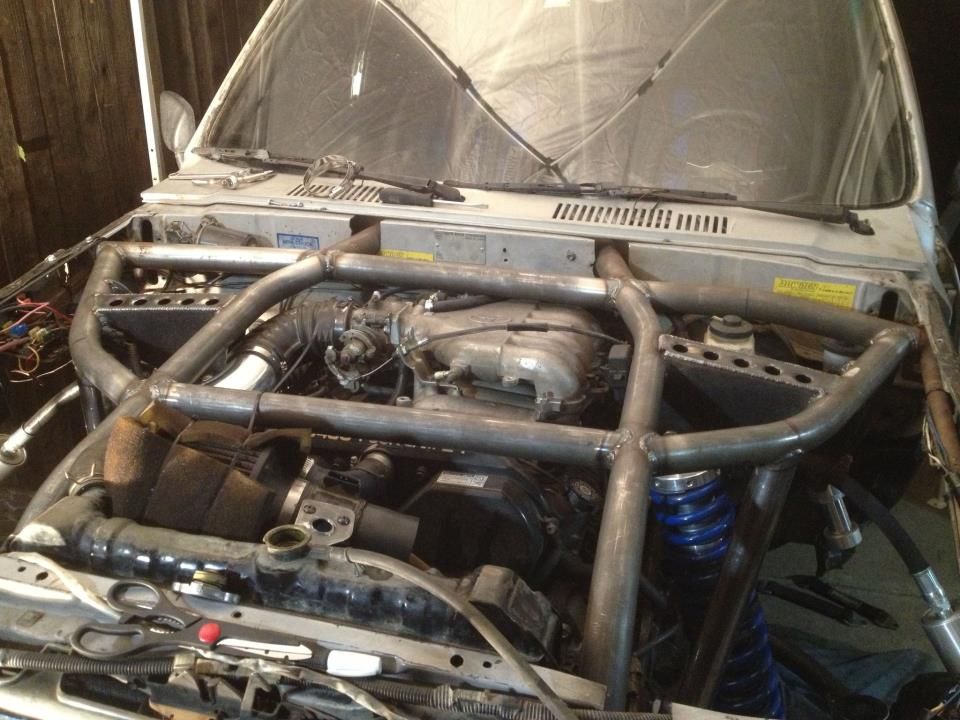

Started building a new engine cage...and doubling my HP
Angry little V6 going in

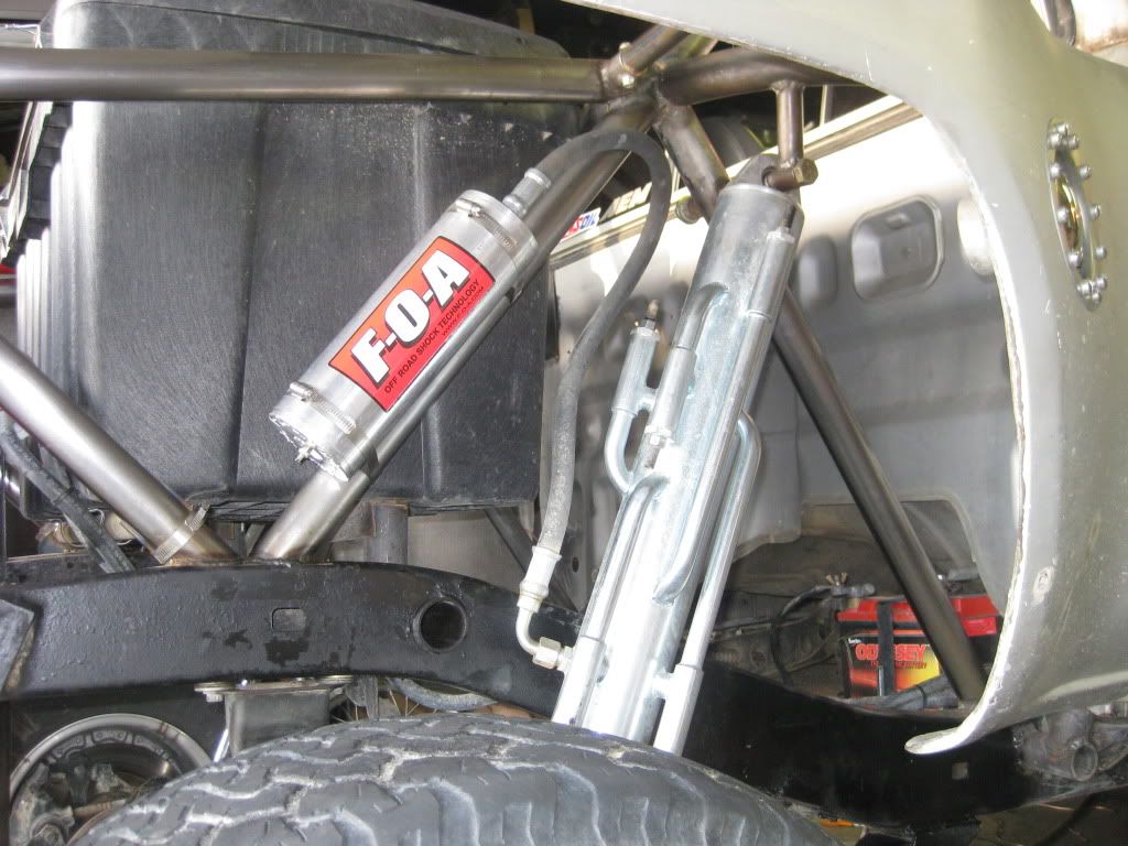

Added coilovers, FOA air bumps and ditched the stock cross shafts in favor of heims

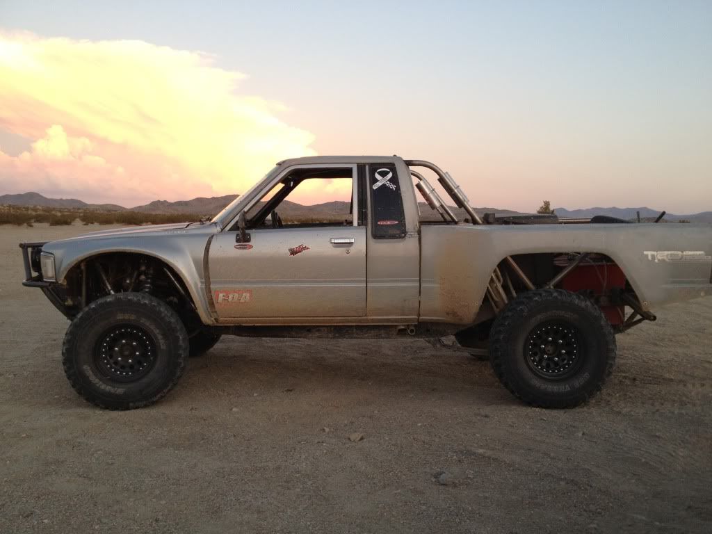

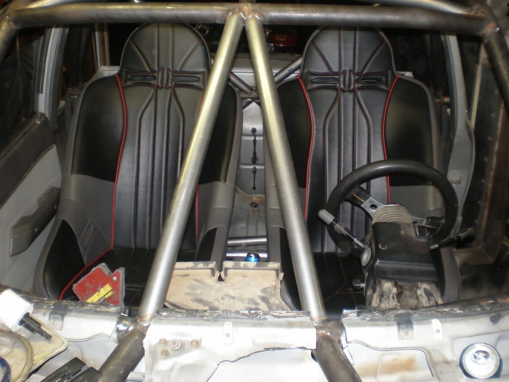

Full cage, fuel cell, ditched the bed, and a 9" rear end with new FOA 3.5 5 tube bypasses...race truck

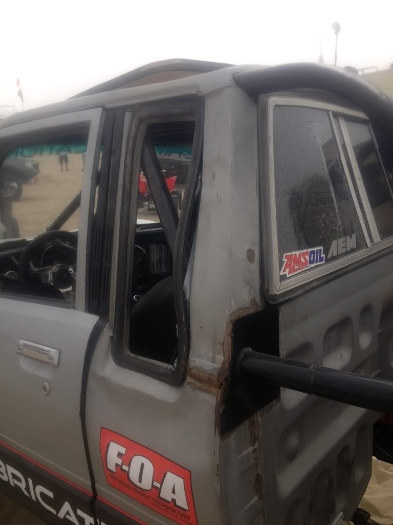

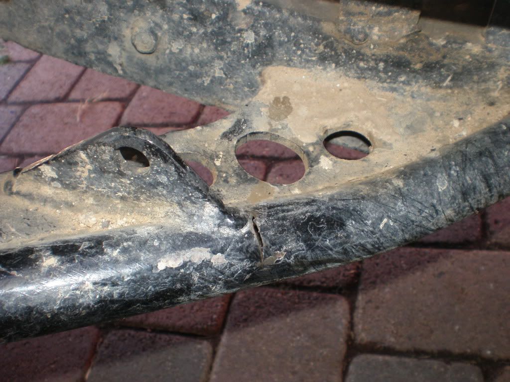

cracked lower arm

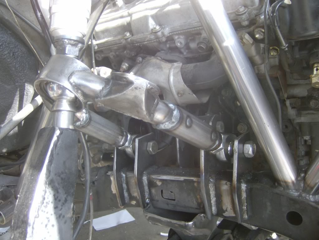

steering rubbing the engine cage
Lifted the entire engine cage and dash tube in the cab about 1/4"
It also made one of my rims into an oval...still held air though lol

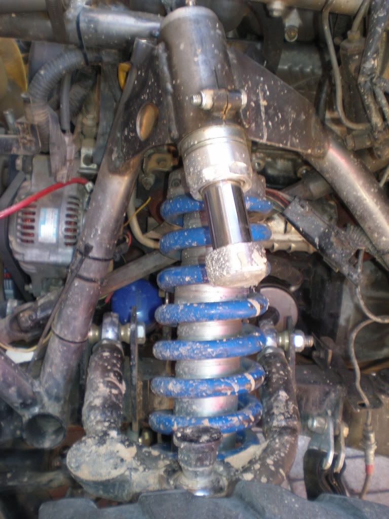

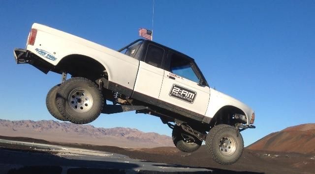

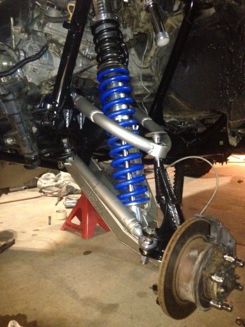

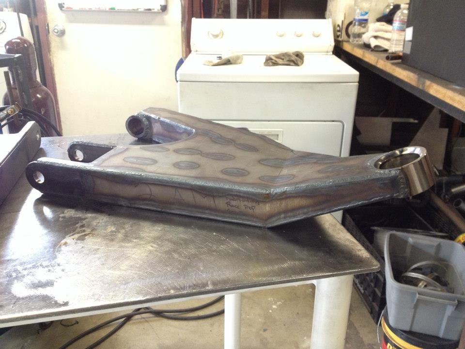

Just before New Years 2013 i had time to get back to my truck. Decided to prototype my own Long travel kit.
CAD drawn, CNC cut and tig welded lower arms

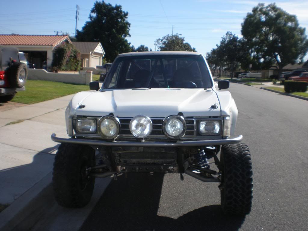

Front end together with brand new 2.5x12" FOA coilovers
Did i mention we knocked all of this out in 2 weeks? :) From bare frame rails to desert ready with time off for Christmas thrown in the middle
Front end specs:
6" wider per side (84" track width)
4wd spindles, hubs
20" of wheel travel
hydro bumps off the spindle bolt

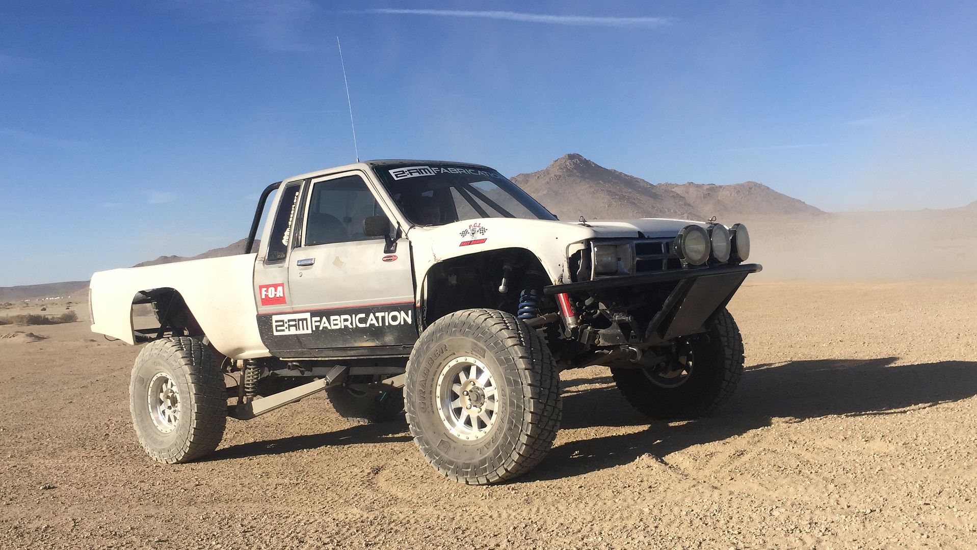

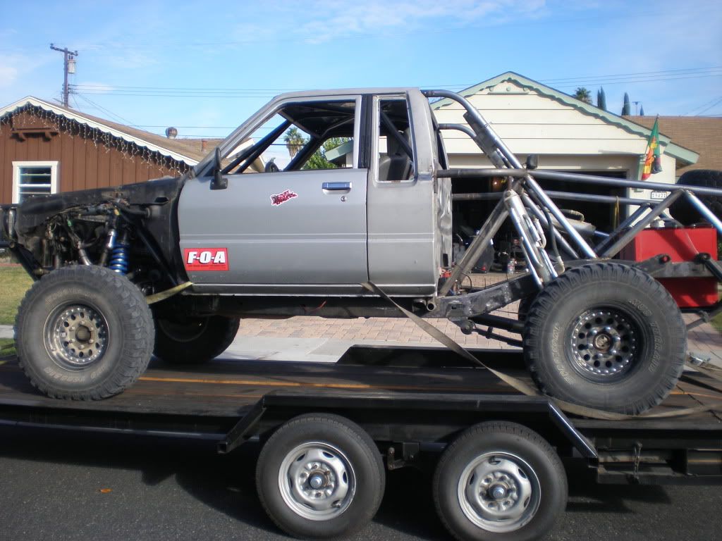

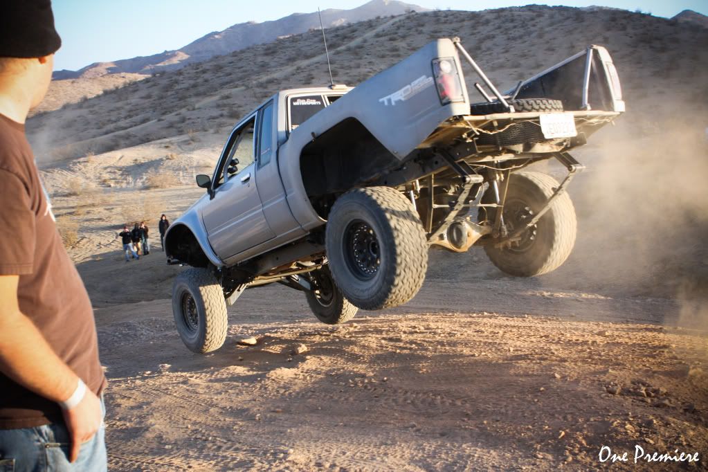

Got the front end together, did 1 hot lap around the neighborhood and drove it onto the trailer for a new years trip

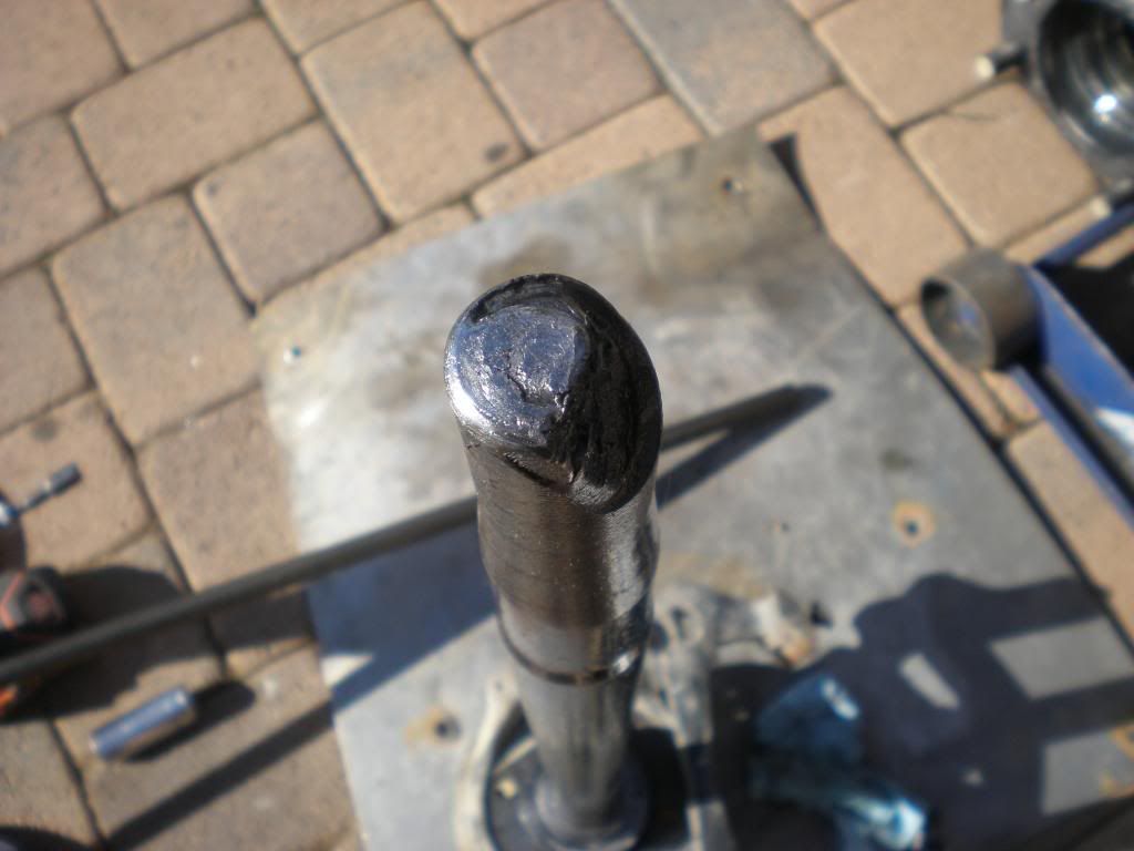

New front end did absolutely awesome, made the truck so much easier and enjoyable to drive, i was blown away. Sadly i only got to put 1.5 days on it before i broke an axle shaft in my 9".

And the broken axle
The truck is now back together with new alloy axles from Mitchell Differential. I should be taking it out soon for a weekend of shock tuning and testing. In the mean time im working on a custom dash and headliner, should be pretty sweet when its done. Thanks for looking and I look forward to your comments.

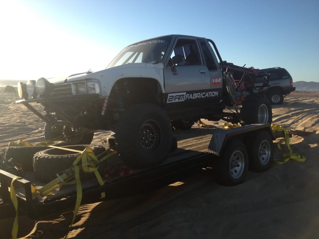

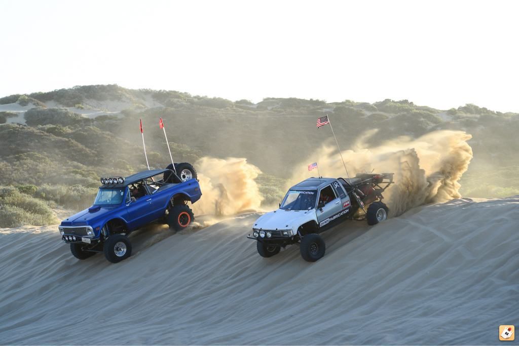

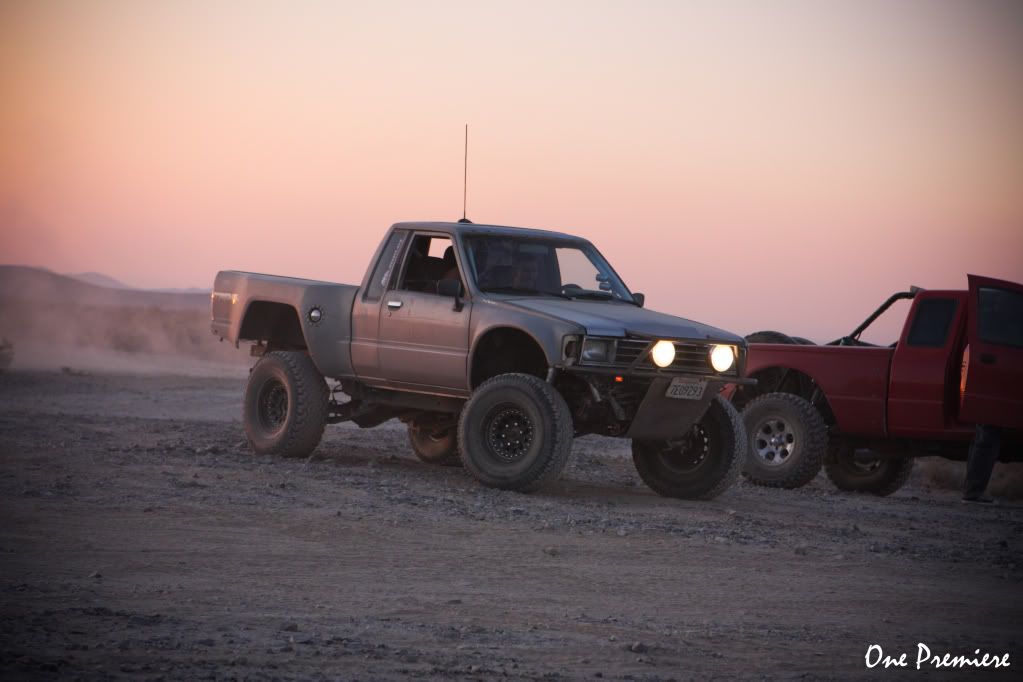

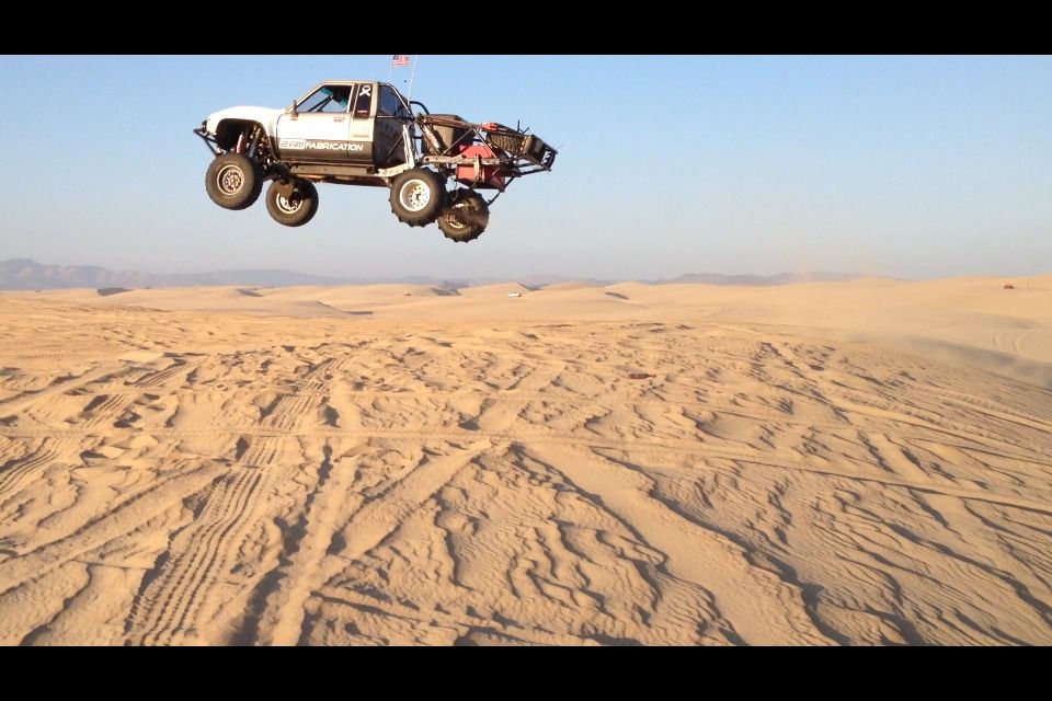

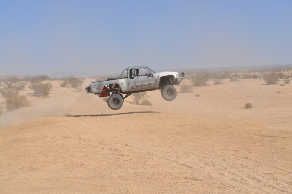

After prep was complete the truck got loaded up and we headed off to Pismo for 4 days. Truck did better then expected in the dunes while moving, Drove great.

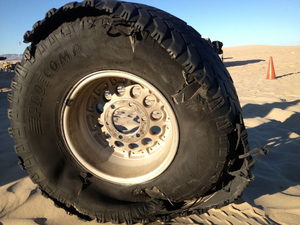

Lost a tire, i think a few plugs will fix it

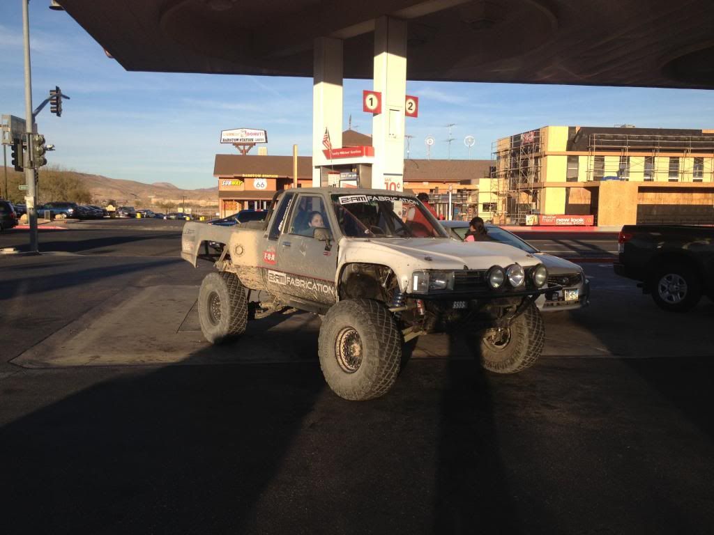

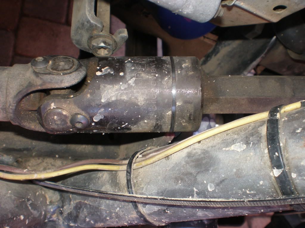

spent 6 days in the desert over new years. broken exhaust and center support bearing issues but other then that a solid trip!
Truck is now getting prepped for KOH

Took the truck out last weekend. Headed to Barstow to get away and watch the Freedom 250. Before the tripped i installed a billet aluminum center support bearing to get rid of all my issues hopefully and installed AC because it was suppose to be 110*. AC and the bearing worked great and fun was had in barstow.
