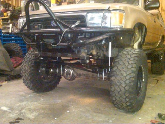

2nd Gen SAS thread
95 4runner 3.0, 5 speed, 230,000 miles

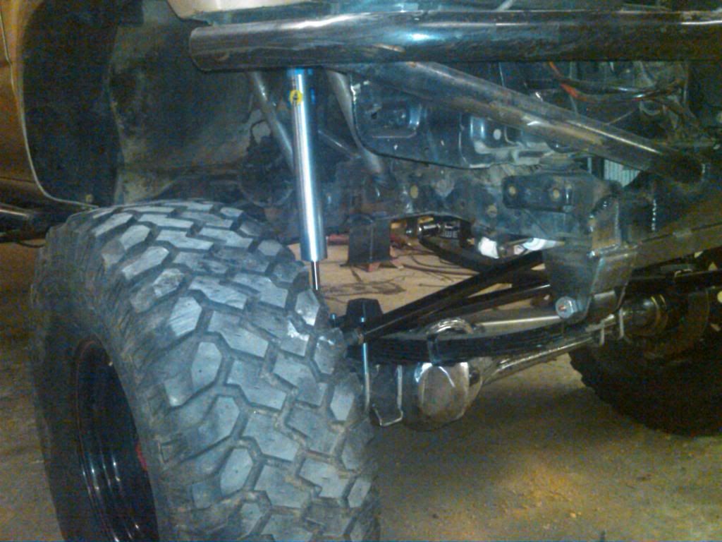

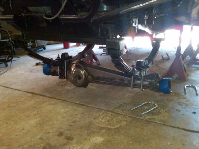

Front: 85 mini axle, V6 stock 4.56, Dirty 30's, Spartan locker
3" Trail Gear HD springs
15" es9000's
TG ball gussets
TG top truss
TG diff armor

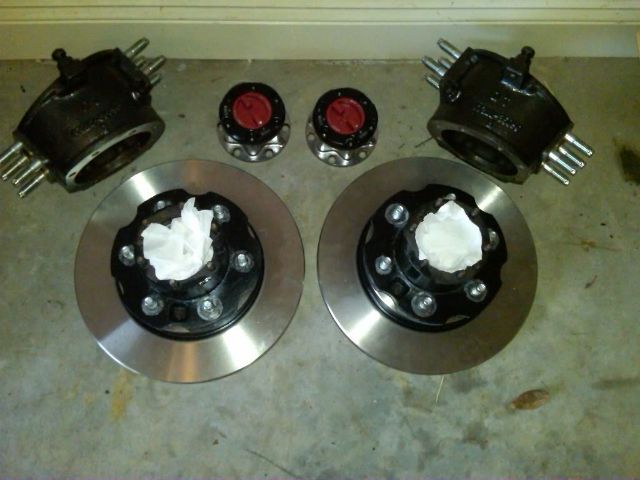

Aisin Hubs, Inner and Outer chromoly hub gears, Upgraded studs to button head bolt
Trunnion Bearing Eliminator
Square drive shaft
Diff stud eliminator

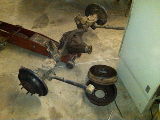

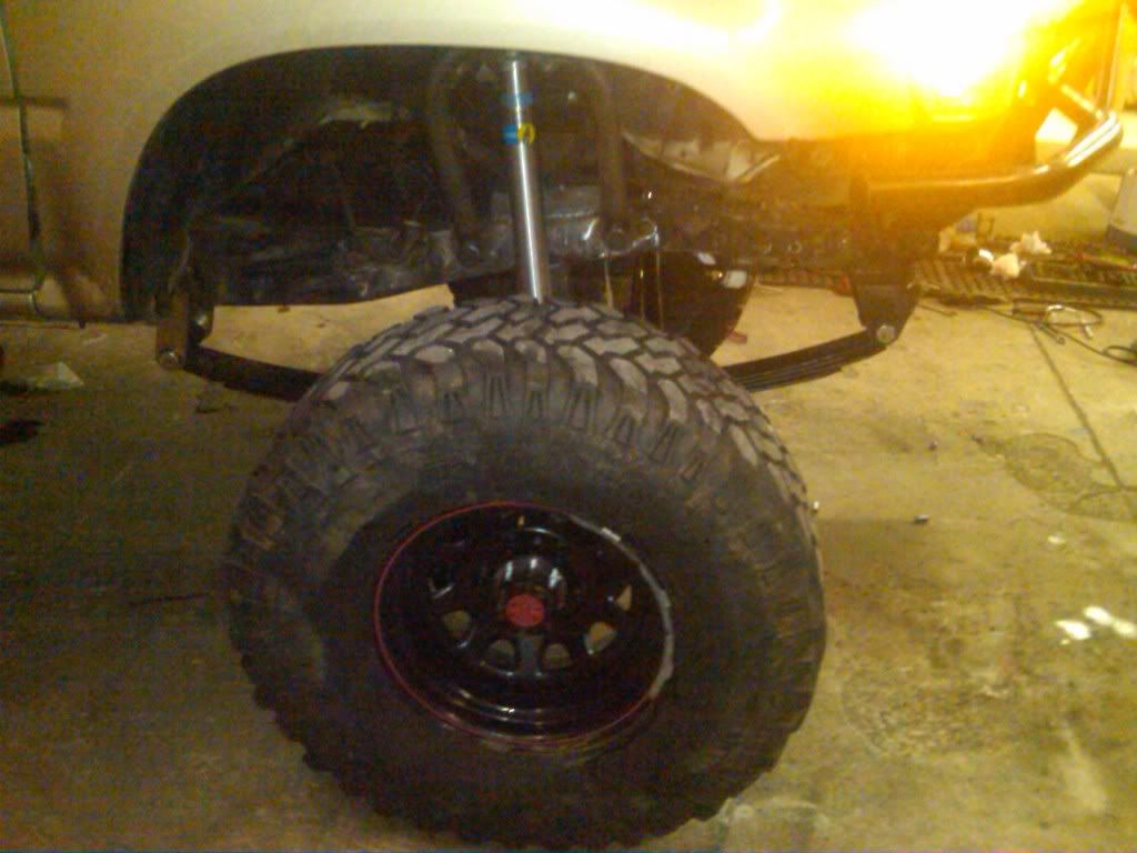

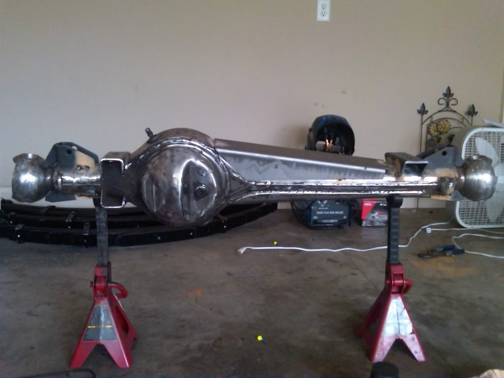

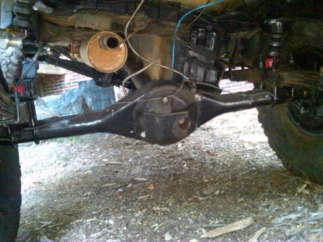

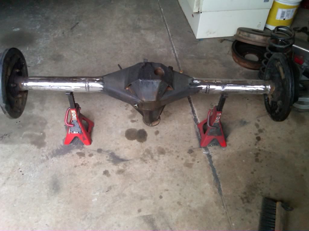

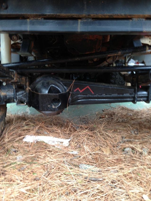

Rear:Stock axle V6 4.56, Chromoly shafts, ARB locker

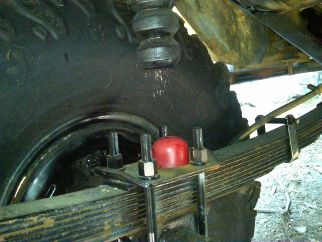

4" All Pro spring conversion
12" 5125's (supposed to be)
TG diff armor
Stock drive shaft

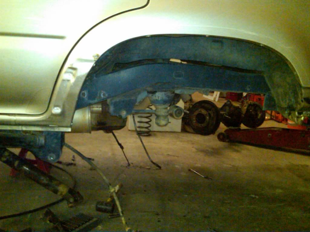

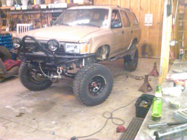

Wheeled it with 32's and one locker for years

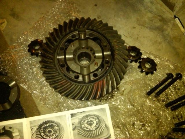

Then...
Front Spartan
Boom
Rear off
Rear bumps

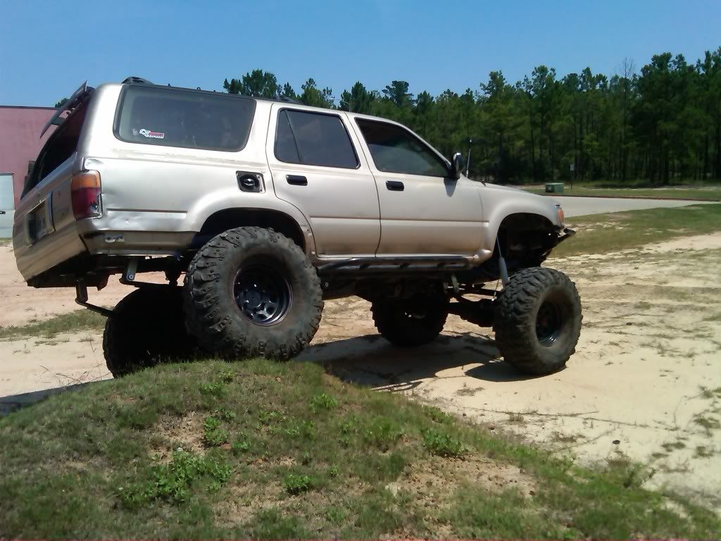

Finally

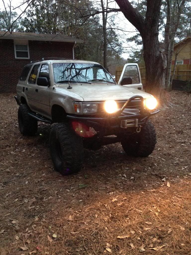

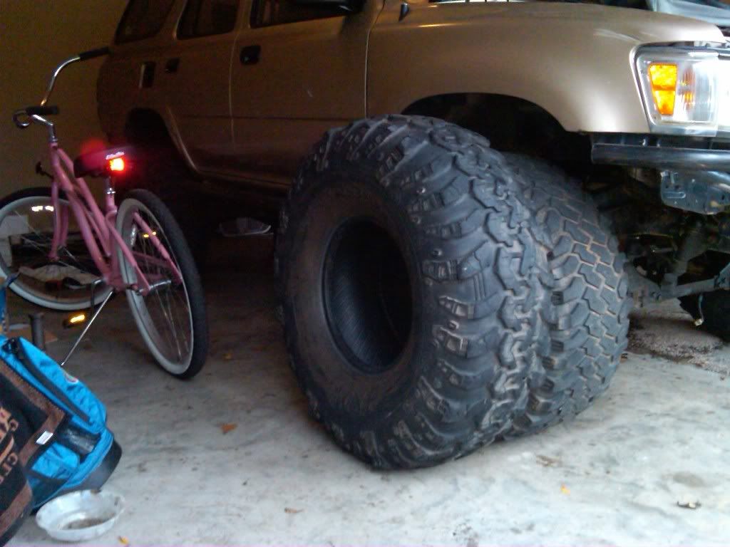

Picked up these 36x1350 iroks up on Craigs

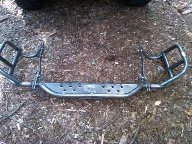

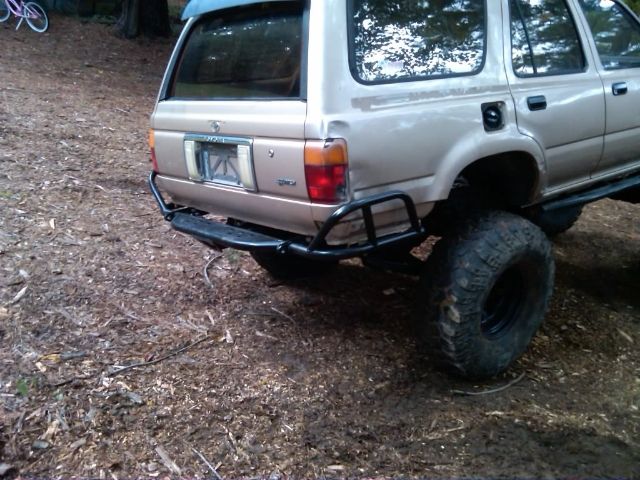

New Marlin bumper
b9a3-b0589093fbf5_zps332b4e84.jpg[/IMG][/URL]

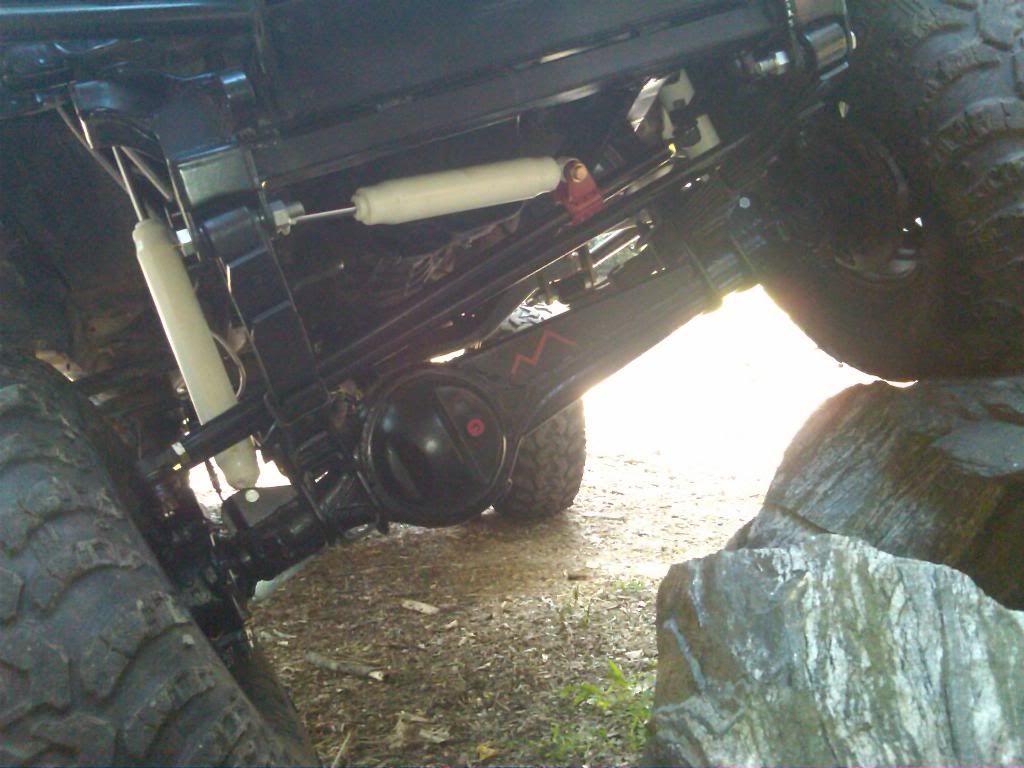

Have rear shocks that dont fit
IPF

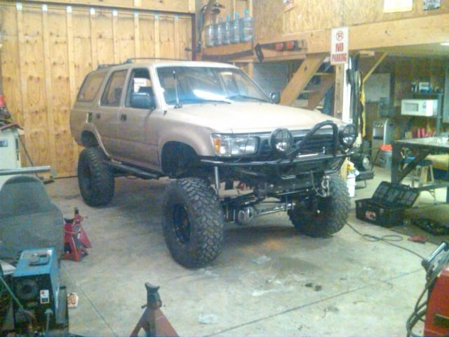

Shakedown run at Durhamtown, and then Morris
Things I still need to do:
-Move steering box forward
-Weld rear shock tabs so I can install shocks
-Trim rear fenders

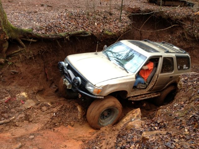

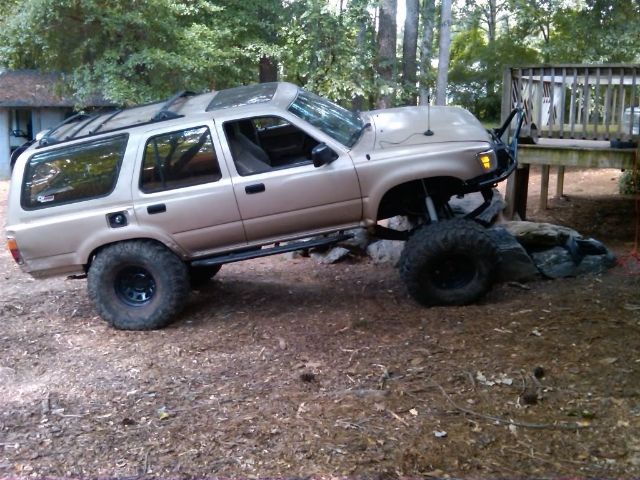

Observations after wheeling it for the first time...
-I need 4.7's asap
-Need rear shocks
-Tighten everything after each trip!
I LOVE REALLY WHEELING NOW, after doing what I thought was wheeling on IFS for years.

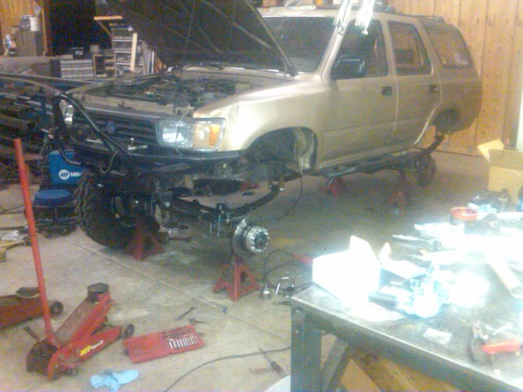

Discussion Starter #4

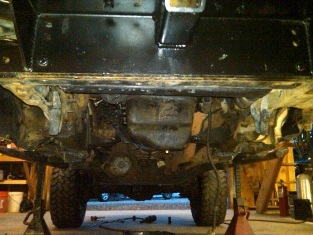

looks good!
how long did it take ya to complete it?

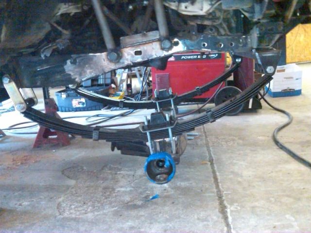

3 of us started on a Friday morning and I drove out of there Sunday afternoon. Worked till 2 every morning, having said that it was a bigger project than I expected. The rear took twice as long as the front did.
Also, my all pro springs our almost flat after wheeling only twice. They have sagged so bad I had to remove my rear shocks because they were going to get damaged. Would not recommend these to anyone
