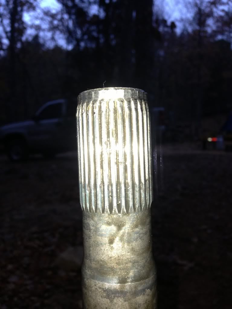

Going up boat ramp and I heard pow thought crap broke a Cv axle look at my front tires and both are still moving, then someone watching asked is your rear locker on, me yes... After getting back to camp I removed the axle thinking it was broken, then saw the shaft and knew.. It wasn't fixable until I got back to FL.

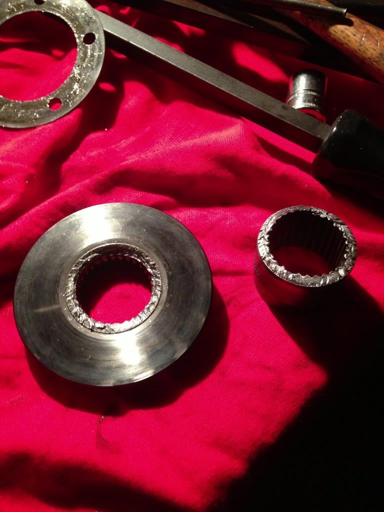

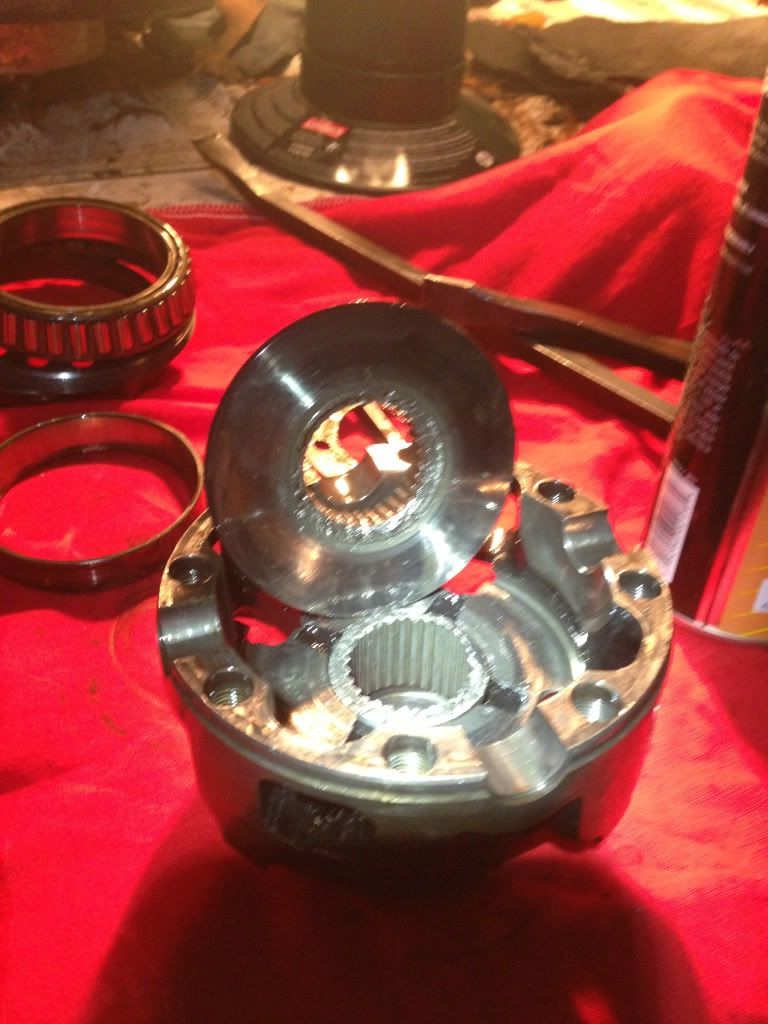

I took the passenger side out and reassembled it, locked the third and drove home one wheel drive, it got sketchy when the road was wet...

I took it back apart yesterday after work and installed my spare side gear back to normal for now.. The Fzj80 axle is getting some attention next weekend.
