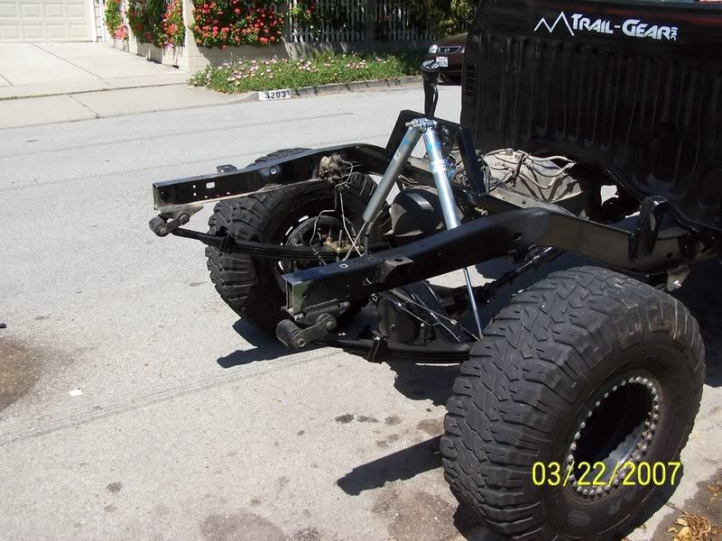

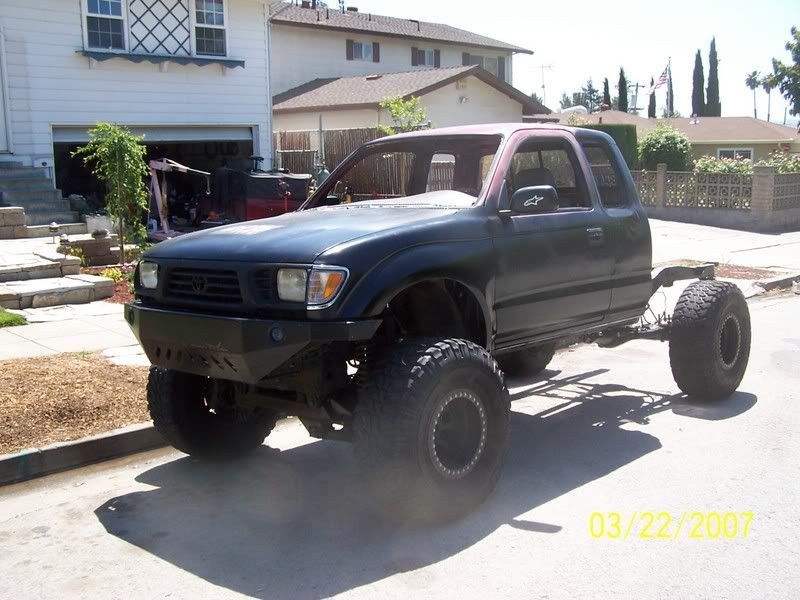

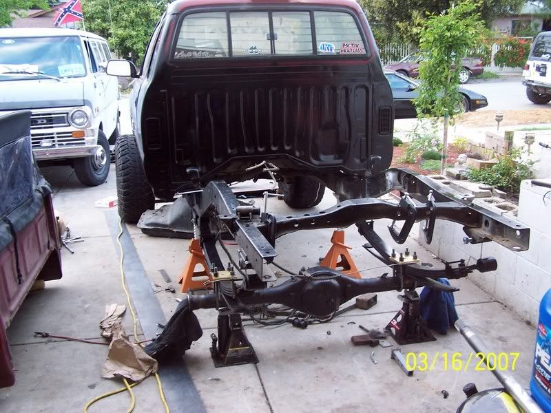

Just got the rear done sitting low now cause i have to get the salvage check so the i used the stock shackle and took like 4 packs out including overload

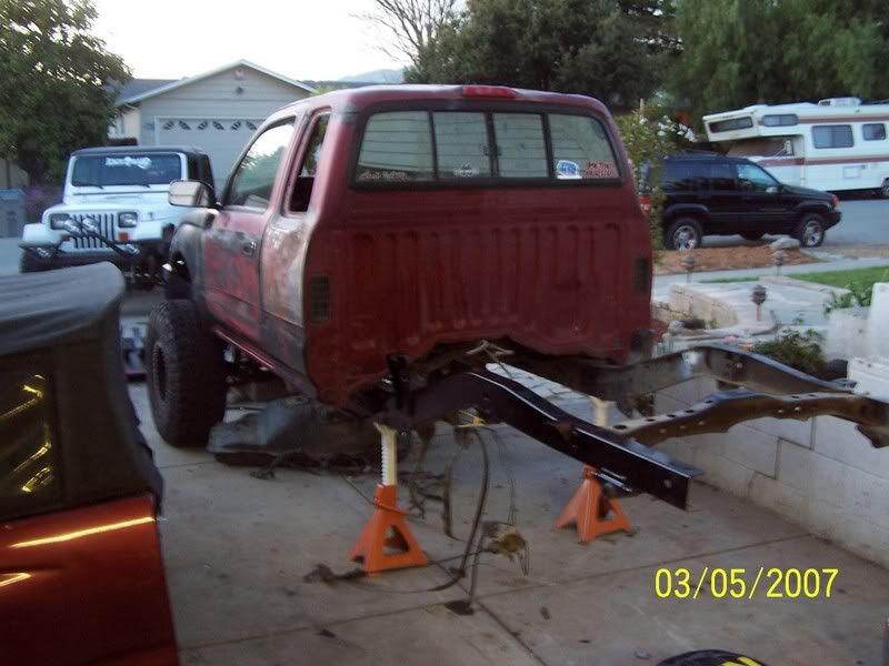

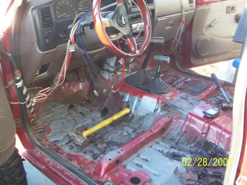

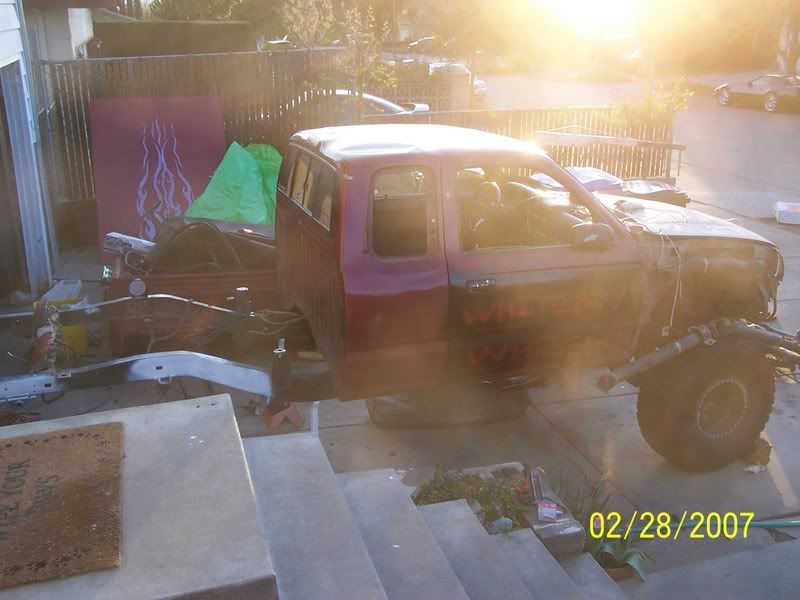

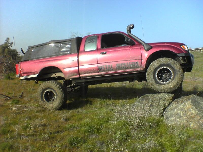

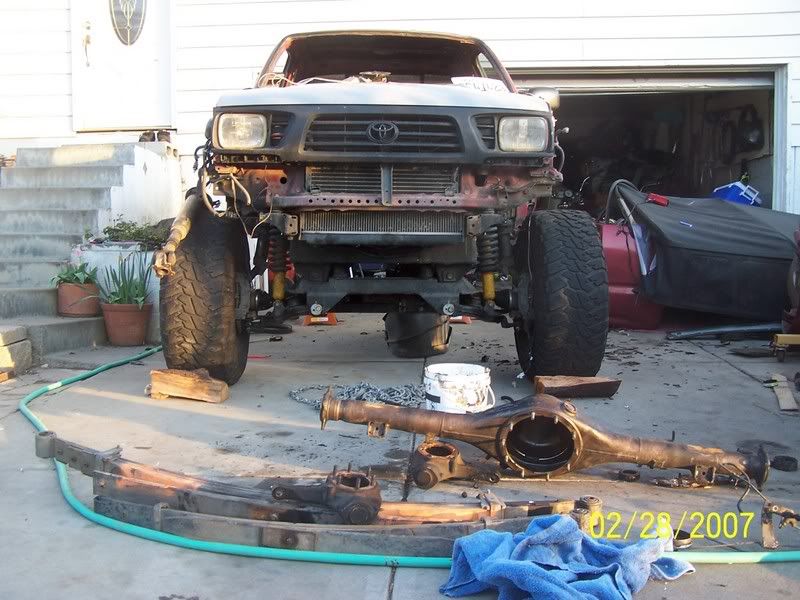

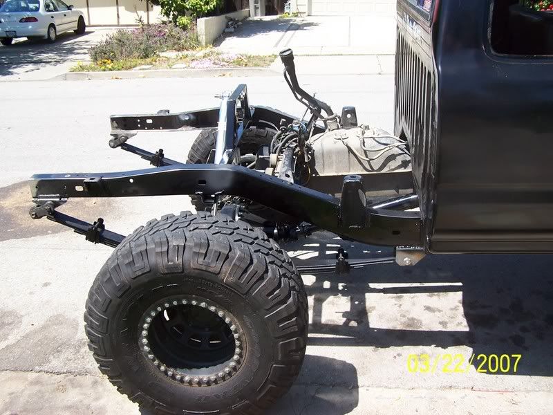

Pics of the build (Rolled it in pismo so rebuilding it now)
Before
Now Buildup Progress

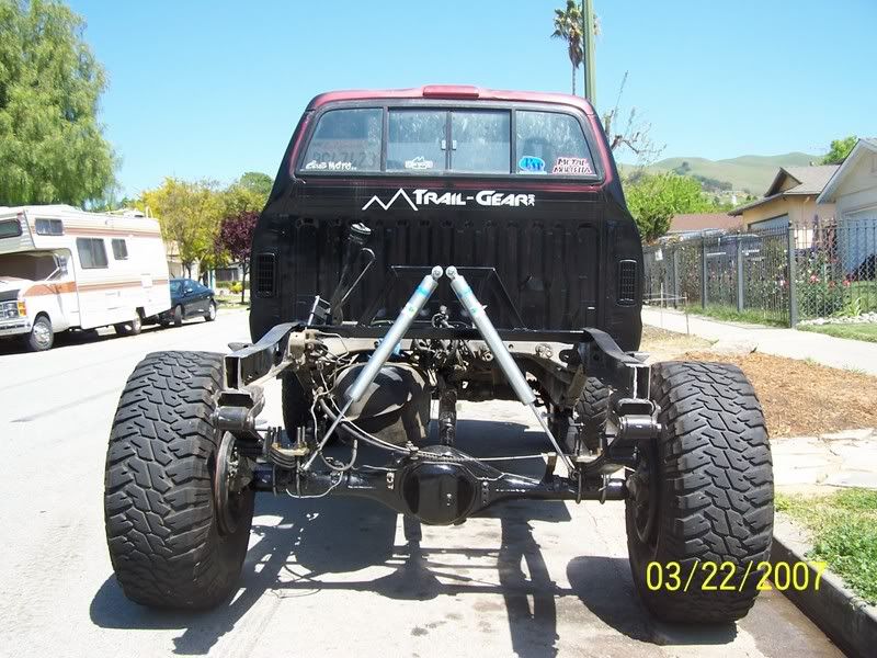

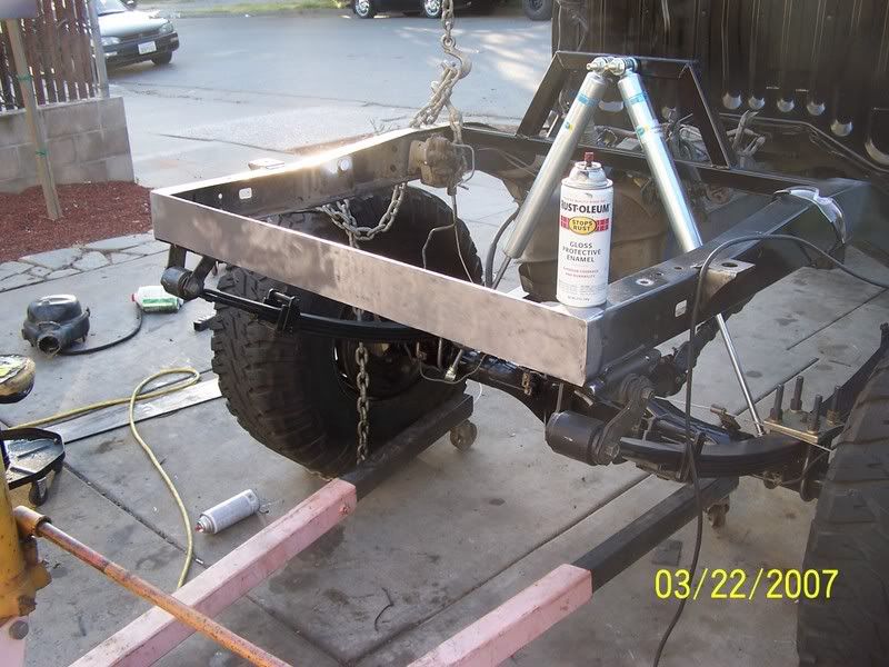

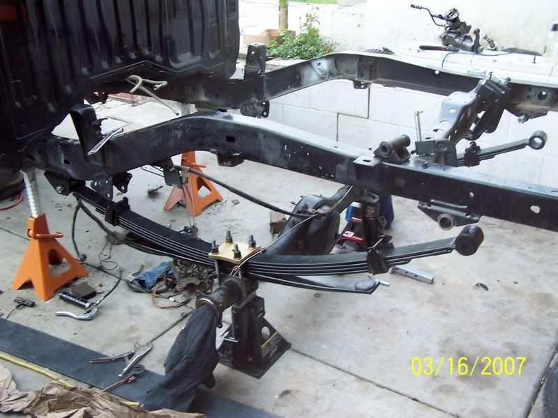

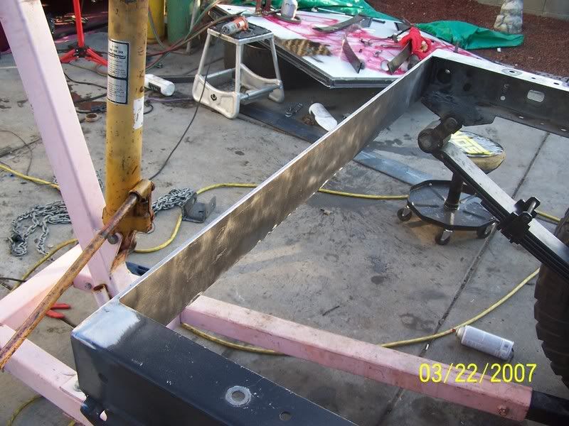

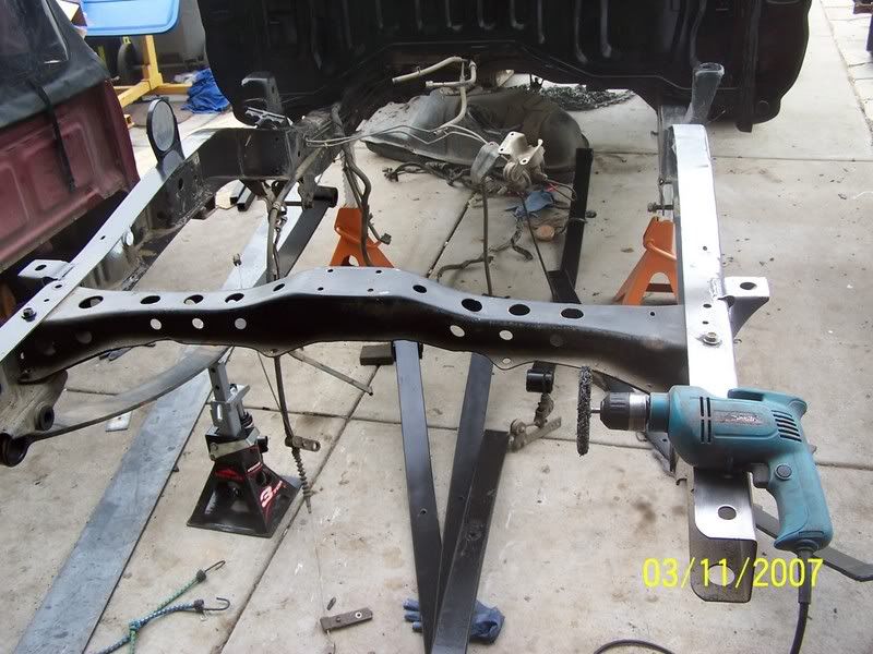

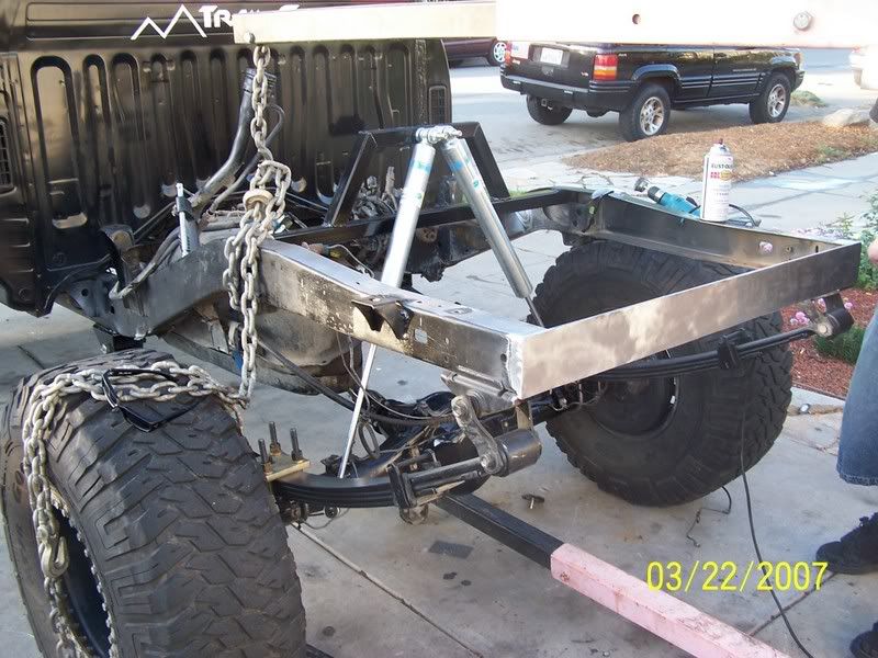

Couple things, your rear shackle is too short. You'll have to make longer ones. And why did you "box" the rear of the frame with flat bar? Probably would have been stronger to use box tubing.
11,173 Posts
I was wondering that myself, had me scratching my head.

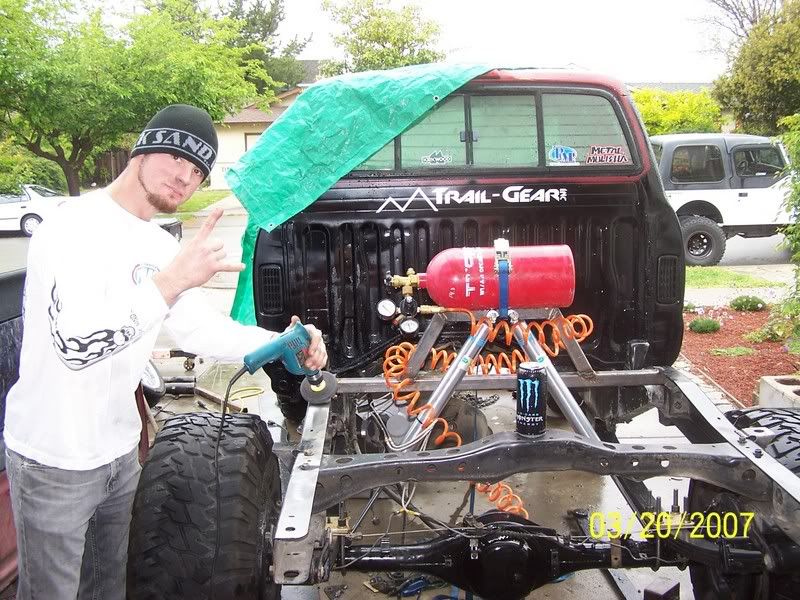

The list seems okay, was also wondering if that was a mock up for your Co2 tank or you just messing around with it. If that is what you are planning on doing, you will have to remove it each time you plan to use it.
I am not sure if this will help or not, but here is a link to some of my SAS photos http://www.imagestation.com/album/pictures.html?id=2117385294
If you notice in them, I have the same front bumper as you are using, mine was just "modified" beyond recongition.
Are you also planning on using that grinding wheel on the drill for the remained of the grinding? If so, I would suggest investing in a 4 1/2 " grinder or even a 7" grinder. No sense in creating more work and effort for yourself.

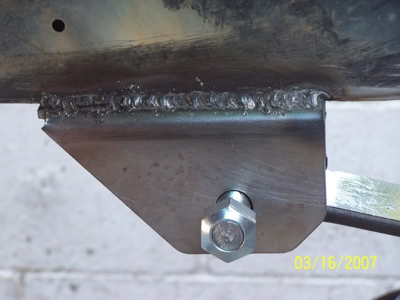

shackles are stock as of now cuz i have to take it to dmv to do a inpection because its salvaged now didnt want to build 2 sets of shaackles the rear i used 1/4" sheetmetal and am going to put another box that piece in that way the lighs will be easy and plan to still box the rear frame in i plan to bob my bed for now until i get a tube bender

hey bear lol yeah bro thats just what i used to sand off a couple rough spots i have my trusty harbor freiht 4" for the rest and hey did u rotate your knuckles yourself im thinking about doing the same any pointers?
