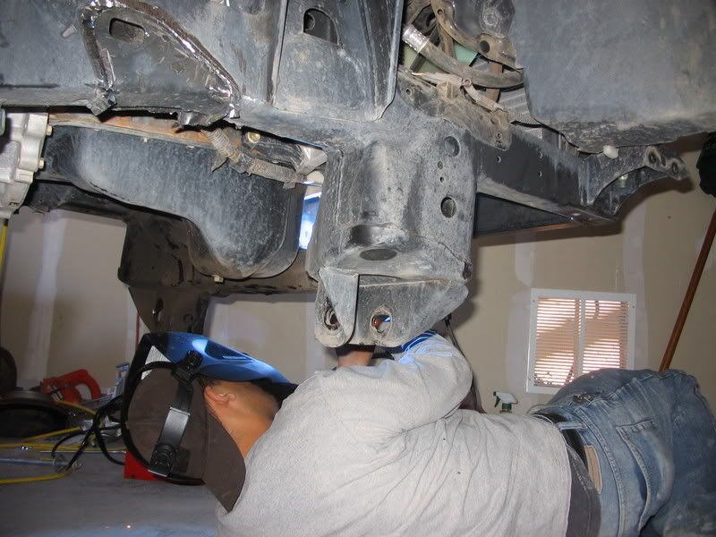

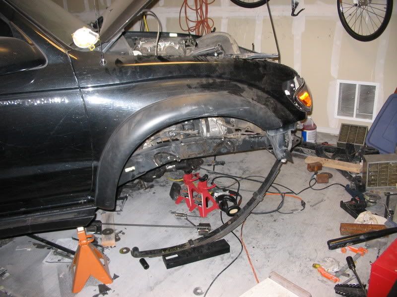

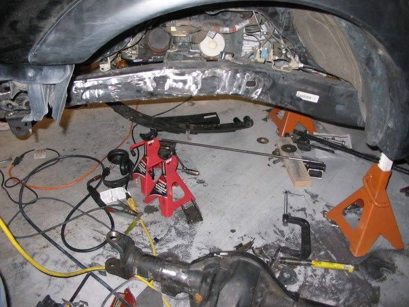

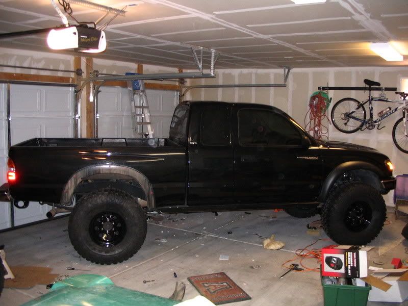

I had grand dreams of having a shop do a three link for me but then woke up and realized I owed a shit load in taxes this year. I had already re-geared the tail and had most of the parts i needed to do a leaf swap so I gave in and started cutting. HUGE thanks to wheelerjake for coming down for a couple of days and helping out with the cutting/grinding/welding. I should have her sitting on tires by this weekend and hopefully ready for kiddie trails at azrocks.

FROR kit minus the drop bracket to keep it low.
Marlin 4" springs, 14" bils 5125, used from taco1
35" maxxis bighorns on crager soft 8's

Before pic on 35's She measured in at 20 3/4" to the ground from the front body mount, 21 3/4" in the rear
Jake welding
Front hangers on
