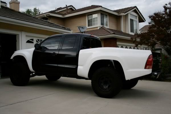

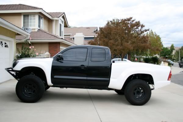

How she sits as of November 2008:
Specs:
-2005 Toyota Tacoma w/ 4.0
-Total Chaos longtravel kit
-King 2.5x8" coilovers up front (600lbs. coils, anodized black)
-Richer Racing 62" setup (17.5" of travel uninverted shackles)
-Richer Racing 100% bolt-in bedcage
-King 2.5x16" double bypasses in the rear (3.0 compression tube custom from Giant, anodized black)
-King 2.5x4" bumpstops in the rear
-Front/Rear bumpers by BBR
-Glassworks front fenders
-Fiberwerx TT bedsides
-16x8 American Racing Chamber Teflons
-285/75r16 Nitto Terragrapplers
