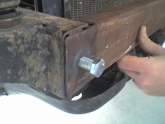

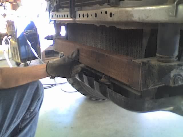

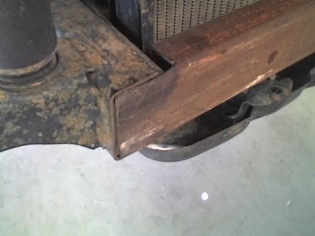

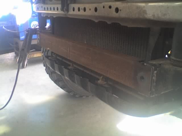

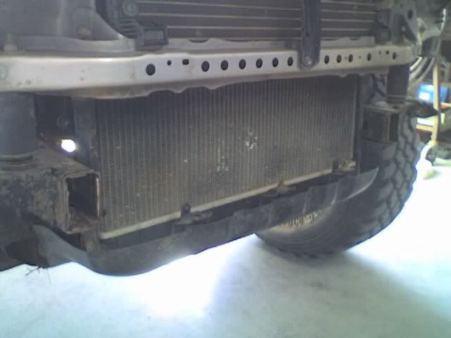

Well. I've been in the process of getting a bumper built over at JFab's shop in San Marcos but I've been super busy the past few weeks so it's been slow going. But I went over there today and got the crossmember mounted after being bumper-less for the past few weeks. ill add pics to this thread as we go along.

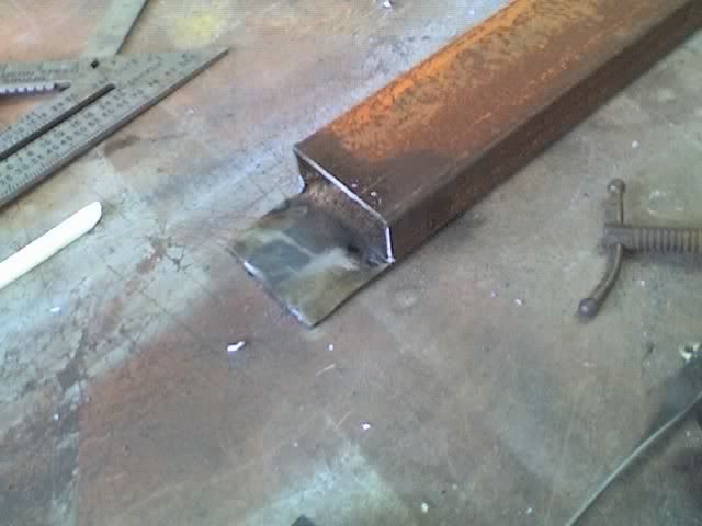

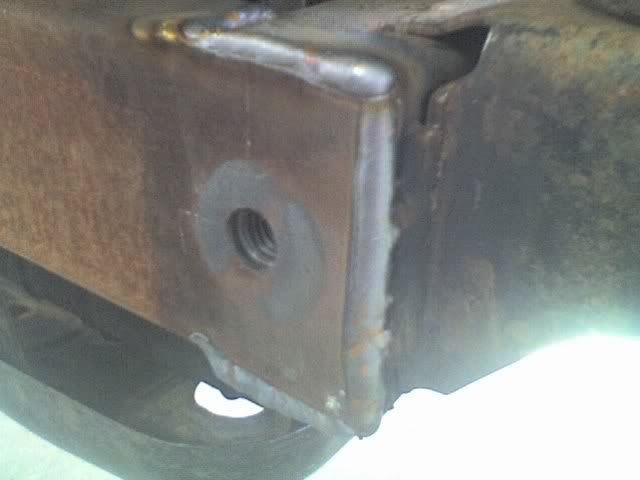

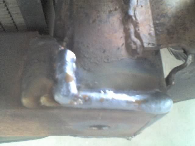

generalee7 said:
That's quite a gap you had to fill back there! :eek:
yea. the gap was pretty large, but Jayce didnt seem to think anything of it. he just filled it in and kept on goin.
3,388 Posts
Did he fill the back side in? I'd question the strength of that.

tube style bumper or plate?
57 Posts
To make this crossmember, it's better to use 1/8 or 3/16 thick square tubing?

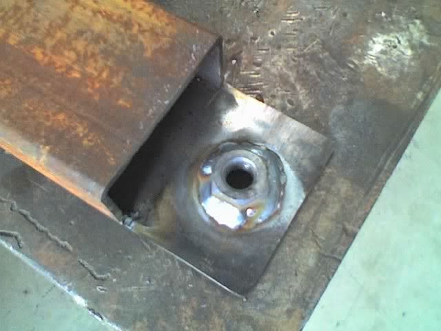

I'm surprised the threads didn't warp
Does the screw thread in easy all the way?
Hehe.....I know! I need to sharpen the 'ol soapstone before I mark things. ;) It wasn't any problem to take care of, one extra pass and all is well.
425 Posts
No, I only got the top and bottom and around the edges but it's not going anywhere. The bumper is going to bolt into the front, on the bottom where the factory tow hooks bolt, and we're going to add one more brace on the side thats bolted to the frame.
425 Posts
It went in no problem, it's a hardened machine nut. The bulk of the heat is on the tubing.
888 Posts
That looks like a pretty good solution to the weak endplate. I'll probably do that when I take my bumper off to line up the other holes. It has to be stronger than the original mounting. What size square did you use?
3,596 Posts
the xmember pictured is 3x1.5 but they are probably going to cut it off and re-do it with 3x2 square tubing and will look similar to the one in my build thread

should pull the radiator and finish the job - my .02
what wall thickness did u use?
1,452 Posts
3x2 aint square tube... :slap: :flipoff4:

1,349 Posts
filling in large gaps like that will create a huge HAZ which will make the already thin frame shit. I dont think it will hurt anything or the bumper is going to fall off, but if he does go to a solid front axle I would defiantly plate the frame all the way to the end.
1,754 Posts
