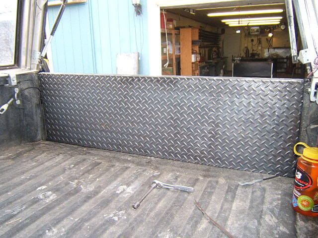

I got my buddy who builds tailgates to build me one for my Taco since I recently did a number on my stock one with my 4wheeler. I wanted something that would be strong to handle easily loading and unloading my 4wheeler and also could handle taking a beating in general. Here is what we came up with, I really like it and it is beefy as hell. These pictures are with it not painted as we were making sure every thing works and fits good, it will be painted black to match my truck. This gate uses the hinges from the stock tailgate. Anyway enjoy our creation.

So show me a strong custom taco tailgate that looks good in your mind.....I would be happy to see what someone else has come up with for a tailgate that looks good. Personally I think it looks fine and it will be better once it is painted. Plus if I was worried about the looks of my taigate I would paint some sweet graphics on it, then signup on customtacos
Yes I was using the cheap straps that came with the ramp and didnt have them as tight as I thought. Ramp came off the tailgate and the whole weight of the 4 wheeler was resting on the tailgate. Once it was crunched up a bit, it lost any strength it had. I now use my tiedowns hooked to the hitch to hold the ramp to the tailgate.

Actually, looking at that design, it gives me some ideas...
Have the latch bolts come out of simple slots in the back there, something you can grab but the holes are relatively small. On the inside (backside), weld on a couple of stout tabs with holes drilled about 1/4in or so, for a padlock. Have a couple of "keys" made out of plate steel that fit into a vertical slot and have a hole that match the padlock hole, and have a notched bar inside that will hold the key, but also allow the handle to slide back and forth.
Look at the pic. You'll need a notched bar after the key, to keep the key in place when locked, but that would allow you to lock from the inside while still maintaining the same functionality. Just a random thought.
I thought about doing something like that but didnt like the idea of tabs sticking out on the inside. Plus I really dont have a need for it to be locked. If I have my topper on and have the back folding door locked it wont let you put the gate down without breaking the latch system on the topper. Plus if the topper is off I dont think having the gate locked would prevent something from being stolen, when they could lift it over the bed rails.
One thing I do like is that the latch pins are spring loaded which I think is a nice feature.
I do agree though I would have like to have seen the openings for the latch pins to be a little smaller, we are thinking of maybe making some spring loaded covers to go over those openings to keep road grime and such off the latches and to cover the openings.

how much weight did that add to the rear? did you reinforce the frame?
If I remember right when we weighed the thing is was about 50lbs more than the stock one, so its got some weight to it thats for sure.
Its not on yet as the paint needs to dry but I currently do not have the rear portion of the frame reinforced but it will be getting Frame Plates on the 6th of April at CBI in Idaho Falls. I already had the plates planned to go on before I messed up my stock tailgate. I saw a completely stock taco here in town that had some small cracks in the rear portion of his frame so I have been planning on getting CBI to put their plates on as an overall preventative measure to hopefully keep frame crack issues at bay in the future.

Well good for you that you have never had trouble. I only did once and it was my stupid mistake to use the straps that came with the ramp. They were not tight enough and the ramp slid off the tailgate and the 900 lbs of me and my sportsman were balancing right on the end of the gate, it ended up bending the crap out of it. I thought of reinforcing the stock one but figured once it was bent that it was pointless to to beef it up once it was already messed up. Plus the price I paid my buddy to help me build this was cheaper that buying a new stock one.
