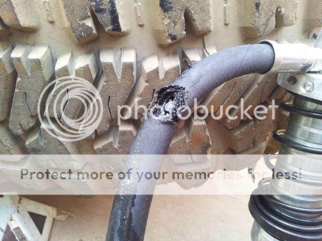

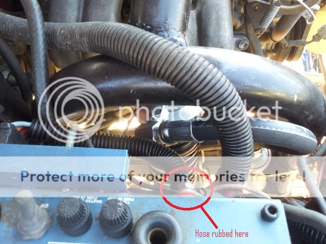

I got the head gasket done and took the rig out to Butcher Jones to check for any issues with the suspension. I'm hoping to have it dialed in before the season starts again. Everything was working great until I had the front passenger tire stuffed and something exploded under the hood. Turns out the reservoir hose on the coilover was rubbing on the positive terminal of my welder when the tire was stuffed.
I ordered a new hose with a 90* fitting from FOA and they sent me a brand new reservoir as well, free of charge! Kick ass!
This should do the trick.
