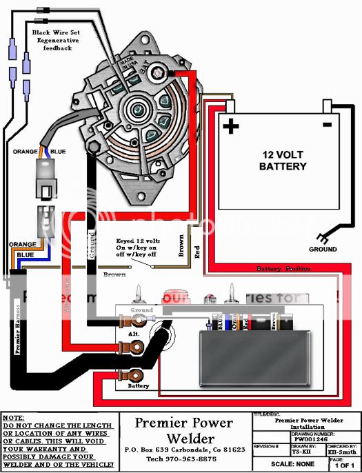

hey nate, if you get a chance could you explain how you wired your gm alt to your 22re? ive followed a couple different ways that i found on pirate, but not sure if there correct. if i pull my charge fuse under the hood my parasitc draw goes to 0, but with it connected its constantly drawing .5

My setup is a little different. I have a Premier Power Welder and run the alternator that came with it instead of the popular one wire. It's wired like this:
I have a parasitic draw too, that I haven't got around tracing yet. I was following your battery thread with my fingers crossed, hoping that you've solve both of our problems.

forgot you had a premier power welder setup i just remembered you saying you had a gm alt as well.
ya its kind of frustrating, im determined to find it though and will post up.
