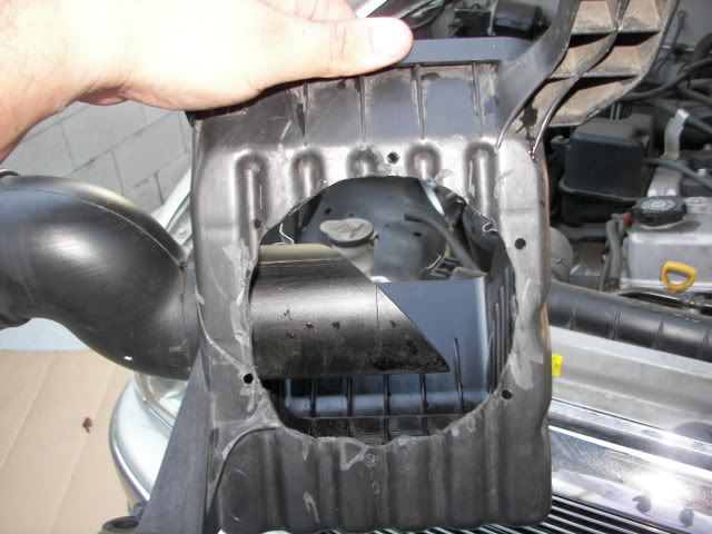

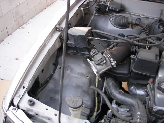

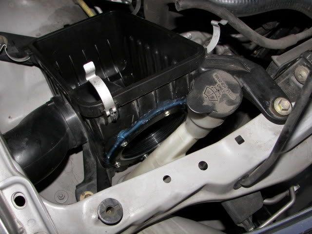

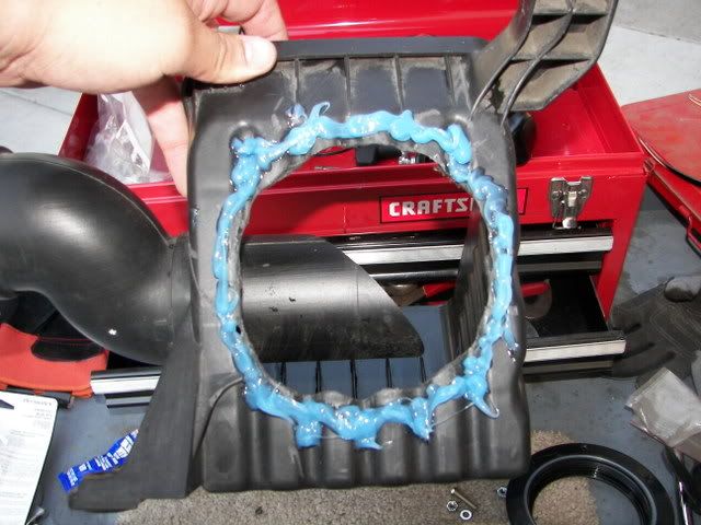

I've seen quite a bit of conversation on here about the DECK PLATE MOD. I'm a member of the WATTORA chapter. There's a write up on the WATTORA site about the 3.4 V6. For those 2.7 folks out there here are some pics I snapped when I did it for my 2.7 I4.

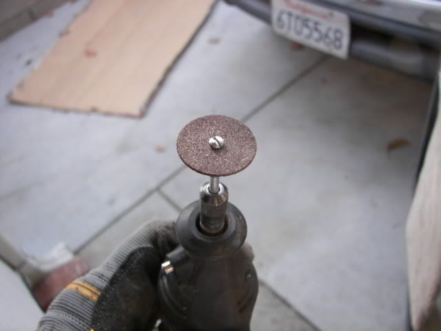

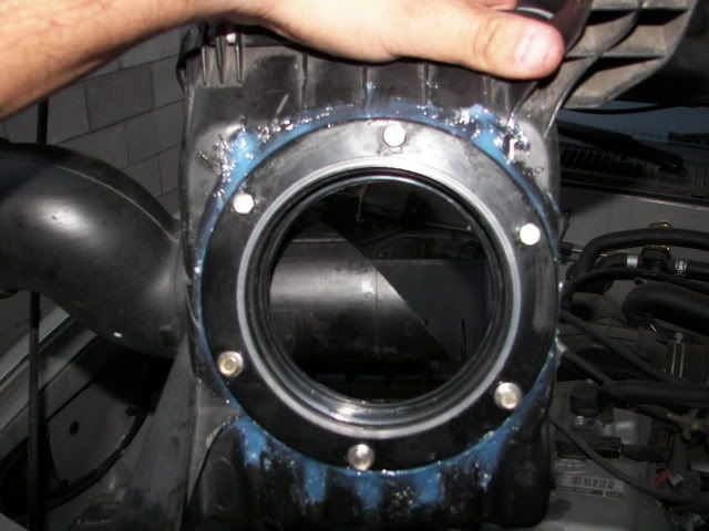

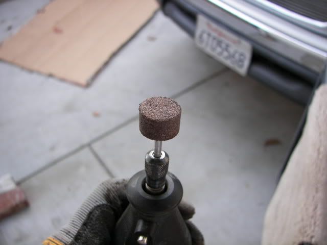

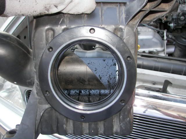

Here's the Deck Plate mod for the 4 banger for people out there wondering if it is doable and what the heck it would look like. I did it in about an hour... Pretty easy. I used a double sided rubber tape to help fill the ridges, and used sensor safe silicone around the edge. A dremel tool makes it an easy job but it can get kinda messy with all of the plastic flying around.
After doing this mod I am definitely a believer... You can feel noticeable gains..
Dremel tool, 4" deck plate(my local boating/marine store...Also on ebay), sensor-safe silicone (auto parts store), and double sided rubber tape to help fill the ridges in the housing.(HOME DEPOT painting section).

I actually just did that to my 2.7 yesterday and I spent several hours searching everywhere for pictures and could not find any. I'm sure there will be those who appreciate your photos. I used a jig saw on mine...kept the saw lifted off the box so that the blade wouldn't hit the pipe inside the box though. Worked good...

I don't see a problem with just using the silicone to fill the ridges. My thought process was that the double-sided tape would create a better seal in the event that the silicone gets old and weathered... But probably not necessary.

ok i have a 2.7 liter and i really want to do this mod (mainly cause its cheap and i love doing stuff to my truck, and if i dont like it ill just screw the cap on) the only issue im looking at is that i have a snorkel hooked up. do you believe that the screw on cap gives a good enough seal to keep water out cause it will most likely see some?

Yes the cap will keep water out. These are deck plates (inspection plates) for watercraft made for that very purpose. If you've got a boat boneyard near where you live you can take one off of a decent junker and use it, but they'll only set you back about 10-15 bucks new. Just make sure you seal with silicone around the outer edge.

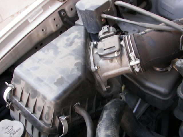

Well Finally got off my butt to do mine!!
I've noticed a little bit more pep and it does seem to hold speed better on the interstate. While this might not be for everybody It was definately worth it to me and was fun to do!!:thumbs:
