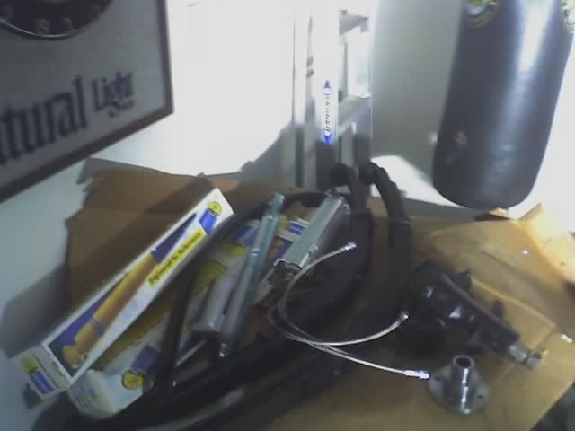

:p I'm a lil premature but I'm too pumped to contain myself- Since last August when KSTACOMA *Jamie* Swapped his truck and I saw the night/day difference in performance b/t a SAS taco vs IFS taco I was hooked- Ive had my '01 for a lil over a year and it was only by sheer coincidence I stumbled onto TTORA when researching headers for my *new 2.7 after totalling my '97 reg cab after hitting a dear; 2 1/2 months after geting my truck it had a 3" toytec lift with chevys in the rear and sittin on 33's- Now on the 1 yr anniversary of my first IFS lift its going under the knife again for the SAS- By Friday I should have the last of my parts- :cool:
ProComp AALs, 14'' Bill5150s, PSC ps cooler, all pro brake lines, tg springs, inchworm tapped hyrdo asst ready IFS box, d44/taco d/s flange, *friday arrives hardware and sky pitman

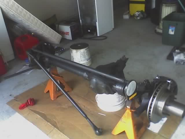

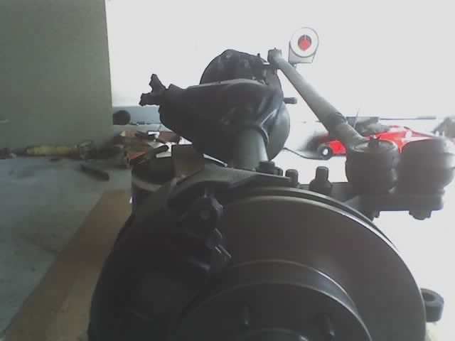

D44 all cleaned up ready to go *Warn Premium Hubs, chromolly shafts, lockrite, 4.88's, 1 ton ends, all new bearing/seals/hubs/rotors/calipers/brake pads:

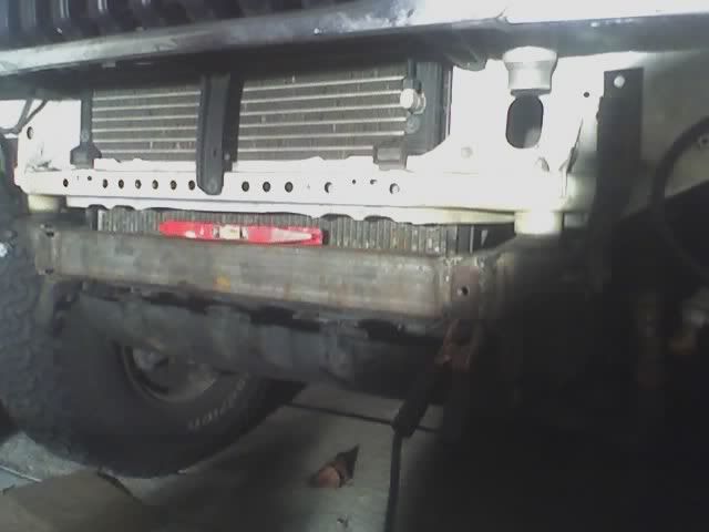

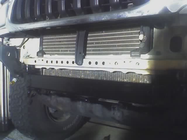

I made trip to the metal yard and picked up my front crossmember and welded it in last night to save some time on friday:
I gave it a quick coat to prevent rust since its been raining off and on here after i got done:
