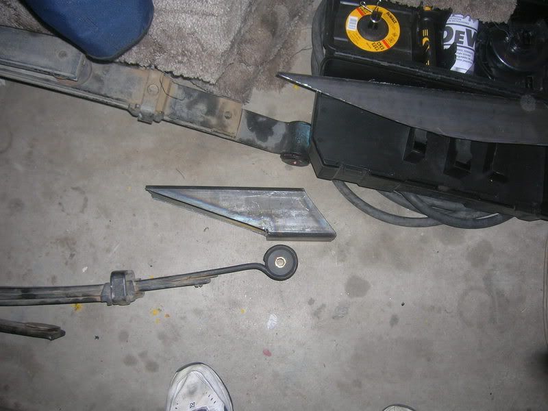

Forming the box frame support

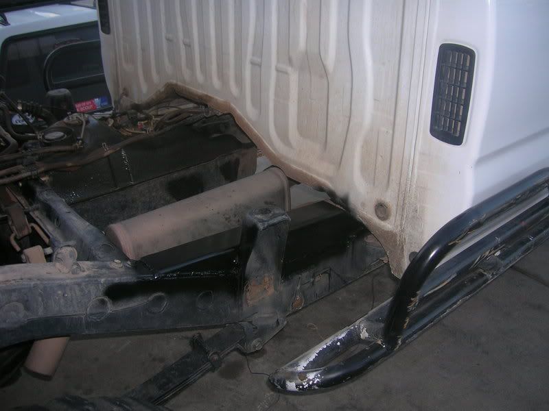

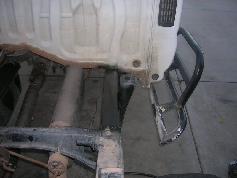

Done with pass side

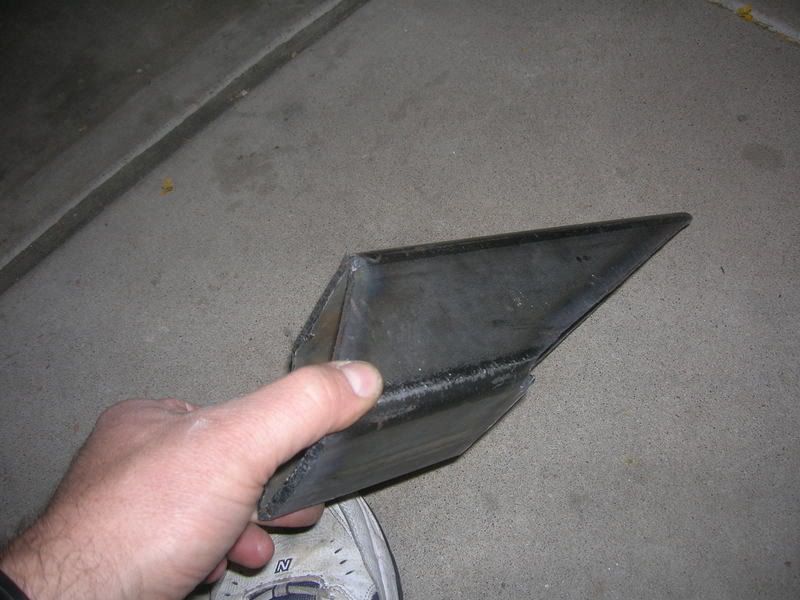

A look at the front mount that will be frenched into the frame
More pics to come - Top shackle will be mounted to a JJ. Will also add plateing once the front mount is put it.

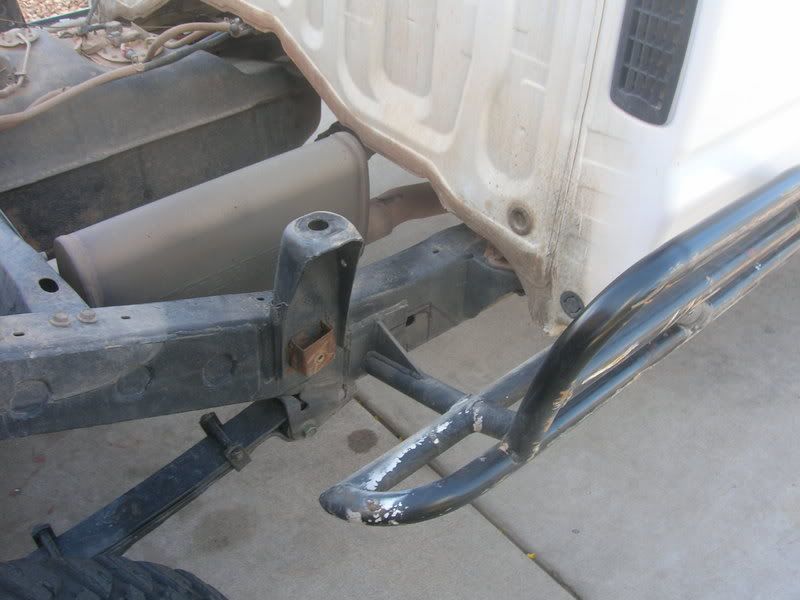

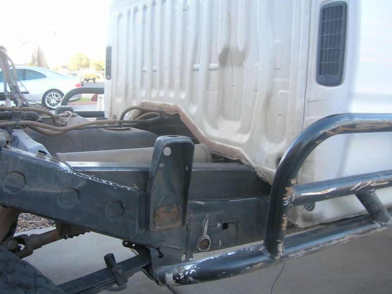

few more pics - got a touch of food poisoning this weekend so progress wasn't the best but I got the 2 rear hangers done

made 2 metal straps drilled at the proper length to serve as a template for locating the new front mount. Deside it's best to cut the new front mount in 1/2 so I can keep the stock mount for locating purposes.
This was the new front mount that I'm gona cut where the marker is
Here are the template bars mounted on the front mount
The cardboard template will be the first cutout on the frame once that section is located I'll cut the rest of the frame and add in the other part of the front mount.
