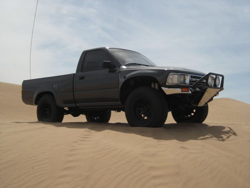

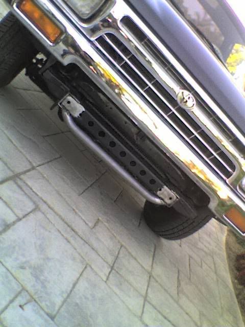

Been working on this little daily driver project for a little over a month. 93 2wd with 22re and 5 speed. Had a chance to run it in Glamis last weekend and was very pleased with the performance. Truck sucked everything up very well and was not bouncy at all. The only issues I need to address are related to tire clearance. Need to cut the large lip out of the inside of the front wheel well and push the rear bedsides out a little more. How have others addressed the issue with the lip inside the front wheel well? Anybody know how far I can push out the top of the steel bed sides without causing damage?:saw:

Nice truck you got there :) Front tires should just self clearance. If you feel the need, hit it with a hammer a few times, lol. That's what I did. Toyota bedsides do not respond as well as ranger's do to being pulled. You're better off just leaving them alone and saving up for bedsides.

You can pull them like 1-2 inches, any further it'll crease most likely which shows more on darker color trucks. I have no idea what color yours is (colorblind) but it definitely qualifies for dark.

Yeah, they already did a lot of self clearancing, but the what is left of the lip cut a pretty nasty groove in the front tires. I'll have to bang on it a little more with the hammer to see how much I can flatten the lip out.

as far as the front goes your suck beating on them with a sledge hammer. if you cut it off your gona be screwed with out an engine cage because that pinch weld supports the radiator support.
