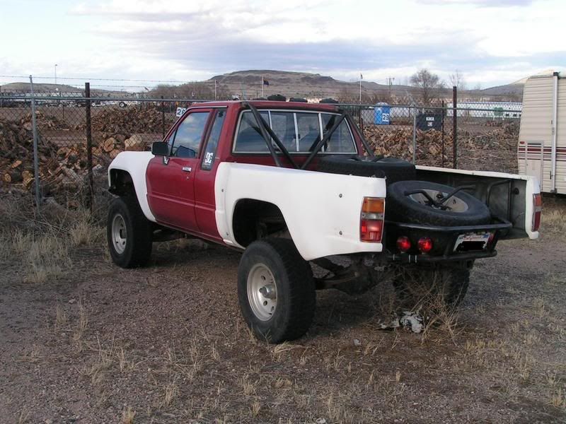

Basically Ive got a 87 Xcab 4x4 with the 22r powerhouse and a 5spd. This is my first ever project. I also have my 95 Taco which is my DD. I thought about building it but would rather start out on a piece of shit. So I bought this for $1500 after it had been sitting in an RV lot for 3-4 years.
Im doing mine a little differently than most. Starting with the cab cage, then doing the rear suspension and bedcage, than the front suspension and engine cage.
On to the build...
This is where it had been living for a while:

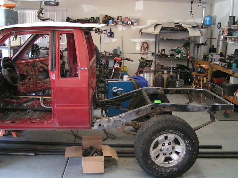

So I cut all the old junk out and ripped out the interior to start again. This was all in July/August:
http://img.photobucket.com/albums/v440/RideTrials/Beater Toyota Project/toyota008-1.jpg
A pillars and dash bar:
http://img.photobucket.com/albums/v440/RideTrials/Beater Toyota Project/toyota004.jpg

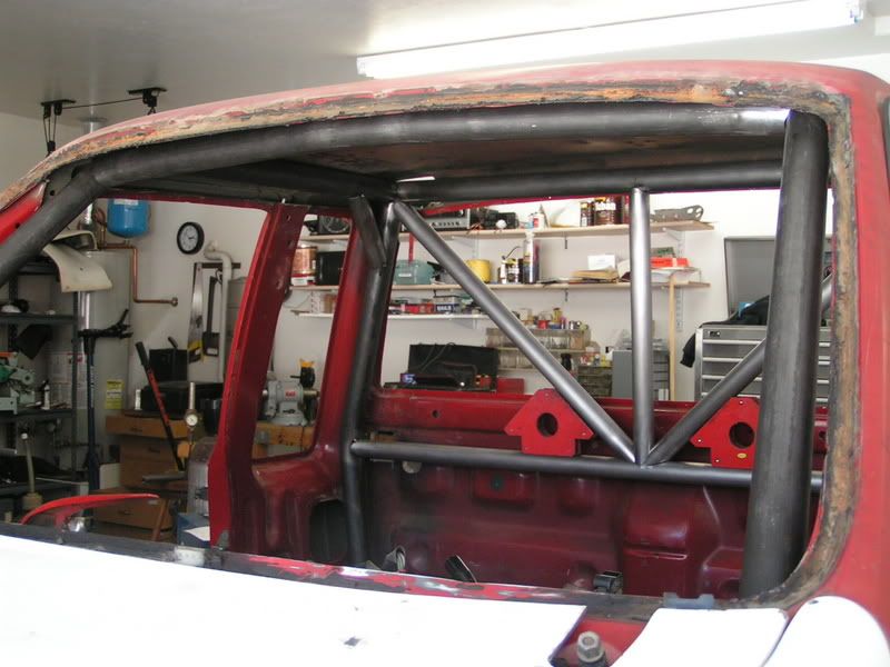

Added the roof tubes and dropped the cage. I built a subframe that it attaches to, no pics though:
http://img.photobucket.com/albums/v440/RideTrials/Beater Toyota Project/Morecage001.jpg
http://img.photobucket.com/albums/v440/RideTrials/Beater Toyota Project/Morecage005.jpg
http://img.photobucket.com/albums/v440/RideTrials/Beater Toyota Project/Cagedropped001.jpg
http://img.photobucket.com/albums/v440/RideTrials/Beater Toyota Project/Cagedropped002.jpg

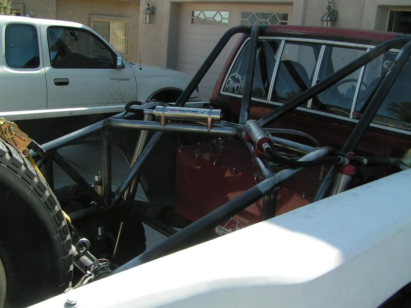

So for the rear I picked up some Deaver 62"s with 12" shackles, 18" SAW's, Fox bumpstops, and a 32gal Jaz cell. The shocks and Bumps will be mounted outboard iof the frame.

what do you plan to do for the interior once the cage is all welded up? I've seen plenty of cab cages built, but i've never seen what people do for the headliner and what not. Just curious.
Who needs an interior? Honestly, all I plan on doing is an aluminum dash, aluminum door panels, Mojave heater, coat the floor in bedliner, and bulid a center console for switches/storage. Plus as you can see from the first pics, the truck didn't have much of an interior to begin with. Its not my DD so I don't care.

4
Got my bedcage near completion. More importantly I can drive it around now and get it out of the garage:
