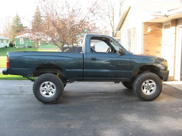

after dicking with the rear leafs for what seems like forever its finally done, sort of. the back is a bit higher then i wanted. i have ome 881's with ome front and rear shocks and i custome built the rear leafs with 4 leafs and an overload. i still have to install my rear brake line but thats next weekends project.
before
new tires
lifted

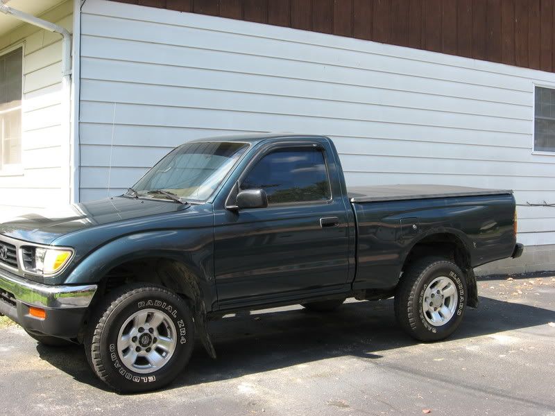

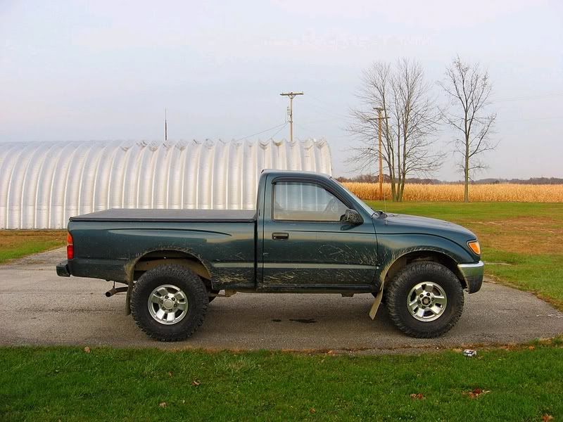

before
after

it has a serious rake to it. i am hoping the back settles a bit. i want a slight rake, normal truck setting. there will be more dents added soon.

For something like that, take your overload out. That should drop the back some and has the additional benefit of more flex ;)
2,364 Posts
Throw a few bags of cement in the back. It will settle them out a bit faster. Gotta work those springs a bit to soften them, up.

What kind/size tires are those? (My micro-film vision isn't working, or else I'd try to read the sidewall in the pic...)
-Radar
324 Posts
Discussion Starter · #13 ·
-Radar
cooper stt's 32x11.5
