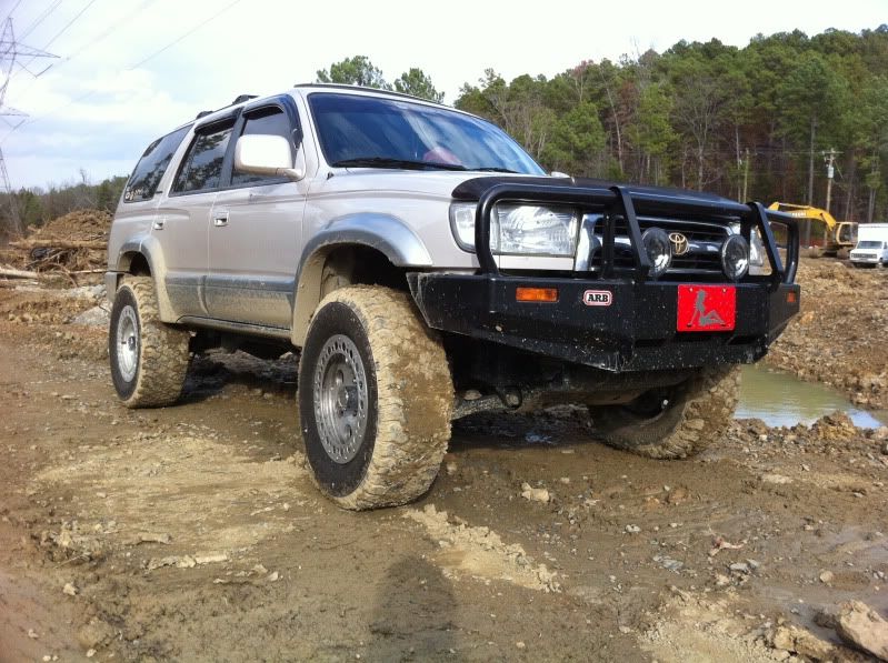

Finally slapped one together. I posted it up on another site and figured I'd bring it over here as well. I know it's a little past due for it, but oh well.

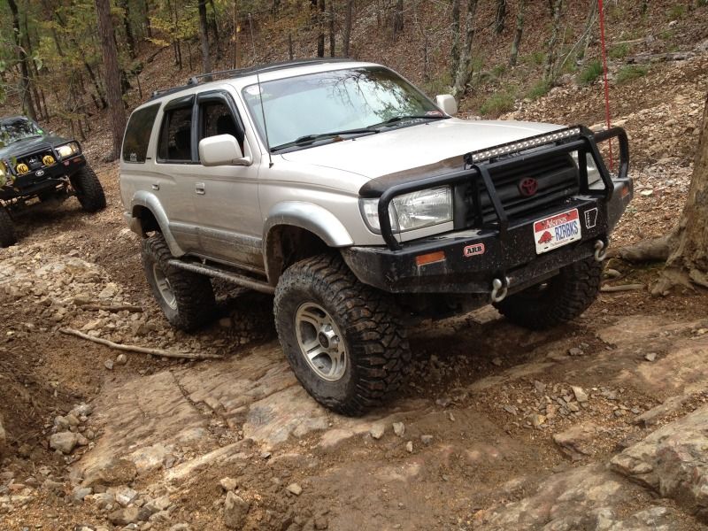

I don't think I'll fit in the garage anymore..
315/75-16 ProComp XTerrains
2,256 Posts
Would the light bar mount on the bottom of that top bar, between your other lights?
1,066 Posts
Discussion Starter · #16 ·
I tried but it's too wide. That and there's no way of mounting it centered up. So, even if I moved the Hellas up top there still wouldn't be a place to mount it. Is this your way of saying it looks funny/dumb lol.
1,501 Posts
x2 on Josh's comment. Looks kinda bad on top of the bar. Just my :2cents:
With those tires and locker in the front, I hope you have saved some money for some spare CV's. Ask me how I know :)
1,066 Posts
Discussion Starter · #18 ·
I don't know where else to put it really.. It would look equally as goofy with the Hellas up top.
Advanced Auto lifetime warranty lol.. I got two spares already. I only plan to use the front locker if I have to, that's the benefit of having a selectable.
1,501 Posts
Haha! Well, "only when you have to" will be most of the time :)
Not sure the quality on the Advance CV's, but if they are anything like the crap O'Reilly has, then stay away! I had the best luck with OEM's, and they are around if you look around the various boards...
646 Posts
Looks good man. Drill some holes a little farther out to mount your hellas and then build a mount if need be to flip that light bar over like josh was saying. It'll keep it from getting knocked off and I think it'll look pretty slick. And seriously would you paint those freaking sliders black already haha.
