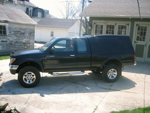

Up front I went with the TRD Tundra coils, Bamachem's spacer and some OME N91S's. In the rear I installed Wheelers Offroad 5 leaf replacement springs (made by Deaver), Daystar Shackles 1.25" lift shackles and OME N85's. This combo gives 2.75" over stock, but it looks like more cause my springs were wasted.
Pics
Before:
And After (there's a bit of weight in the back already):
With my cap back on:

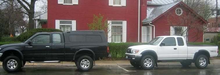

And just for fun, parked in front of a stock Tacoma:

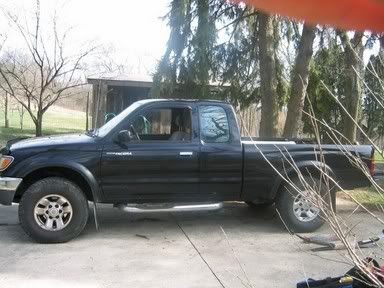

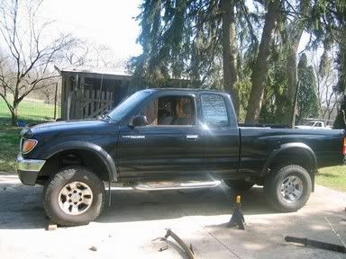

Front before:
Front After (I was worried that I had gotten too much lift and I would damage my CV's, but it looks like stock front height is 35 to 35.5", so I think I am right at 3" of lift. Diff drop on order):
And the back before:
And after:

lift
Truck looks good. Now for the black steelies and 32's. What lift do the coils and spacer provide - respectively.

Close to 3" total, over stock, I believe. In the pics it looks like 4", but from what I've read, my trucks coils had settled at least an inch.
I believe the coils are worth 2.5" and the spacer anthoer 1/2"
