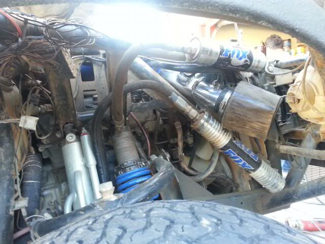

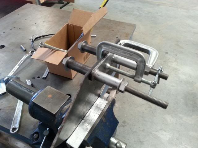

I forgot to update that I got the supercharger installed. It was a pain to piece together the kit from buying it used but it's all done. I made my own tensioner bracket using my buddys as a template
It's def a night and day difference. I'm still working on tuning the 7th injector. It's running on the rich side which makes it bog down under high loads. I can't load it up enough on the street so I've only had limited time to tune offroad.

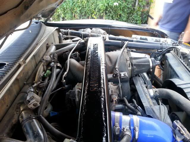

When I got the supercharger I set up my intake like this
From what I've read you need about a foot between the throttle body and MAF. as the throttle body opens and closes it sends shockwaves backward to the MAF messing with the reading. I was having problems tuning the 7th injector and I was getting some CEL regarding the MAF so I redid the intake to look like this
Hopefully that does the trick.
I redid my exhaust with some ultra high flow cats and changed the tailpipe to just have a quick turndown instead of up and over the axle. It's super loud now, borderline too loud. I may end up getting a new muffler but we'll see
I finished my engine cross member finally as well. Sangel Motorsports lol...
