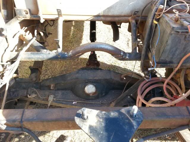

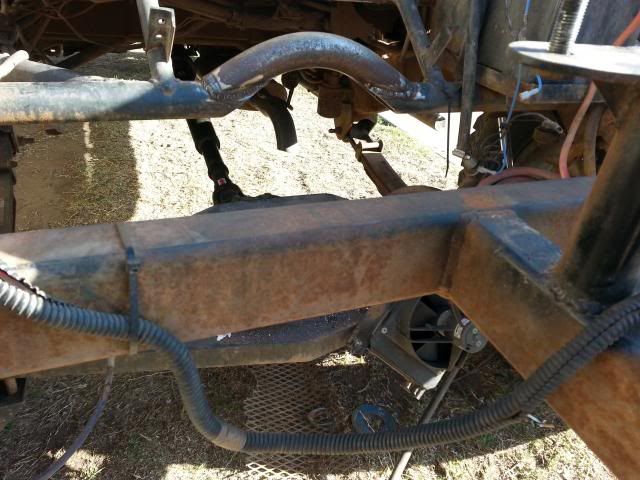

When i orginally cycled the rear the axle cleared the crossmember fine. Later on I added a fill/inspection plug to it and it bashed the crossmember every time i bottomed out. you can hear it in the tuff truck videos. final took care of it.

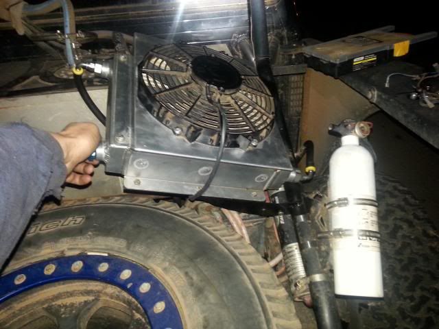

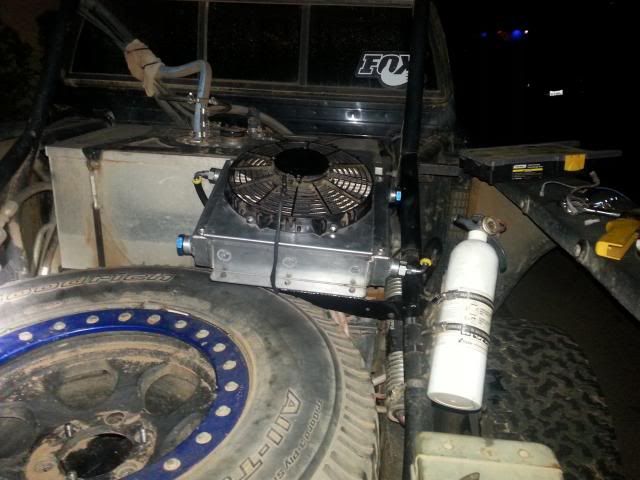

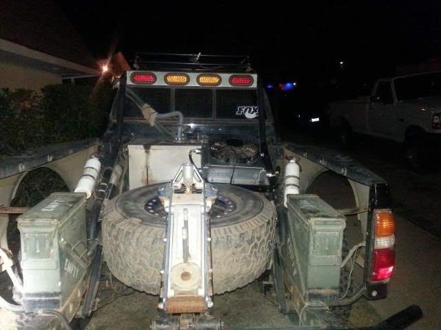

I upgraded the transcooler to a massive fluidyne one. After I got the supercharger the truck runs hotter and the old cooler couldnt keep up. the new one works awesome. It's kind of temporary where it is now. i plan on redoing the bedcage when i link it. it has to swivel to get the spare tire out

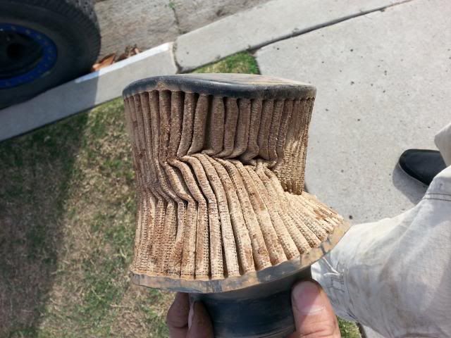

at the meet my truck was running like crap. i wasn't getting any power and i wasn't getting any boost. i immediately thought it was a supercharger problem. i was dicking around with it today and noticed when i twisted the throttle cable and revd the engine the silicon elbow on the intake would collapse. well I felt the air filter and it was collasped. here's what i found
fuck me...I had a prefilter sock over it and had no clue it was that dirty. i only had 3 trips on it since i cleaned it last. i had just relocated it to the wheel well and havent had a chance to make a shroud to keep some of the dirt out. its crazy how much faster it gets clogged in there. I ordered a new filter but im pretty confident that will solve the whole problem
