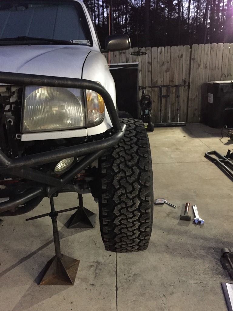

Yes, the axles will be wide. I chose 67" front because I think the long term goal for my 4Runner is a long travel front and triangulated 4 link rear. It seems like most long travel kits have an overall width of 67", so this will keep both vehicles the same width.
Here's some early pictures of the axle width.

These are pictures with the suspension set at the expected ride height. I expect the frame height to be 23" w/ 35s. Originally I was hoping for 20-21", but I quickly realized that wasn't happening once I set the axle under the truck. With the 4WU kit, any ride height lower than 23" on 35s will put the lower links at a negative angle without major bracket modifications.
This is with the angle finder on the bump pad at ride height. About 4°.
This is with the angle finder on the lower link at ride height. You can see that they are almost parallel with the ground.
Here's a couple of the driver's side.
And the passenger's side.
Front.
This is the steering to full passenger at ride height.
Running flat steering arms with the 9.5" diff required notching of the panhard bracket. The diff is too large to run the tie rod under the steering arms.

After too long of a break due to holidays and bad weather, I finally managed to get more accomplished.
Starting with the bumper clearance issue.
I decided to cut out the two tubes on each side that were causing problems and modify them to make room for the tire.
Here they are cut out.
In those pictures the center tube has already been cut down for clearance.
The top tube was sleeved where it was cut and both tubes were re-notched to fit where I needed them.
The bumper was due for paint, so the majority of it was stripped, prepped and it was repainted. This is the result.
For the fenders, I tried to clearance for 37s. The largest tire I have is a fresh Q78 which runs about 35.5", so I used that and cut until a piece of pvc with an outer diameter of roughly 1.25" cleared with no interference.
This is the driver side.
From the inside.
And the passenger side.
It's difficult to get decent pictures of the clearance, but here's a few of the passenger side at full articulation. At full bump the tires don't come close to anything.
For the fenders I drew a 20" radius on wax paper and cut it out for a template. After some trial and error on the driver side I found a height I needed and used the radius template to lay out some curves. The center section at the top is flat because I didn't need any more height. I marked it out with grease pencil and ended up with something like this.
The bottom 2 lines were from earlier estimates, but they demonstrate the next step. I used electrical tape to follow the original line and offset it for the actual cut line. I cut the fender at the lower offset line, then cut perpendicular lines up to the original mark to create a bunch of 1/2" wide tabs.
The tabs were then bent under to finish the clearance.
I'm hoping that this method will add some rigidity to the fender as well as prevent sharp edges in case I do get rubbing.
