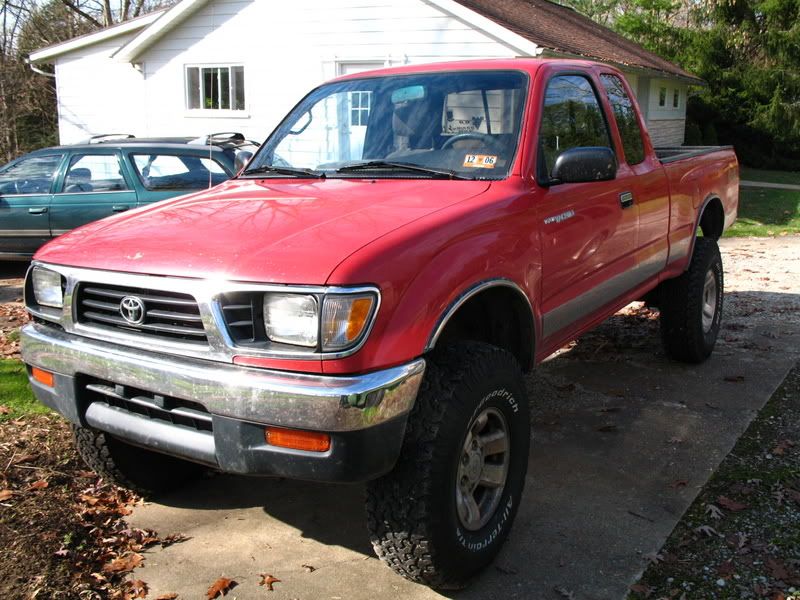

Well I will start out by saying I do a lot more reading on here than I do posting. The factory red on my truck was slightly faded when I purchased it 3 years ago and well time and paint restoration products as well as rusted rear fenders didn't do it much good. Upon seeing the results of others from the roll on paint thread I figured I would give it a shot. The before pictures are from last fall when I had a lift and 33's on my truck. Oh yeah I think I had the vivid effect on my camera and the truck was recently waxed so the red looks more red than it actually was.
Before:

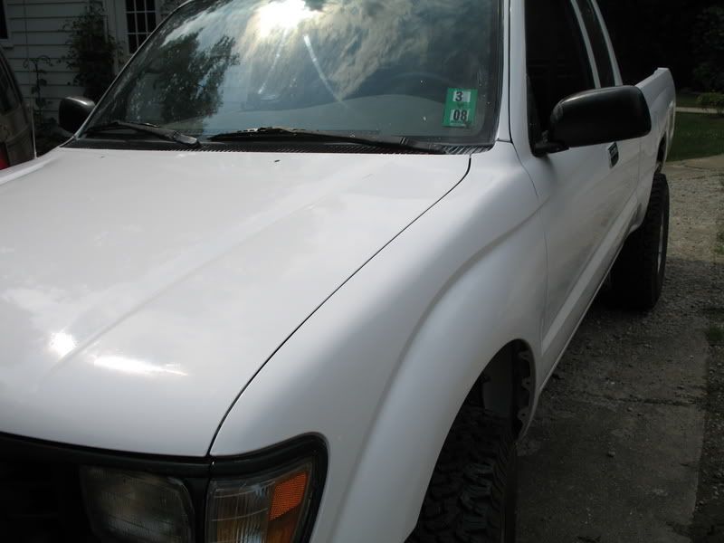

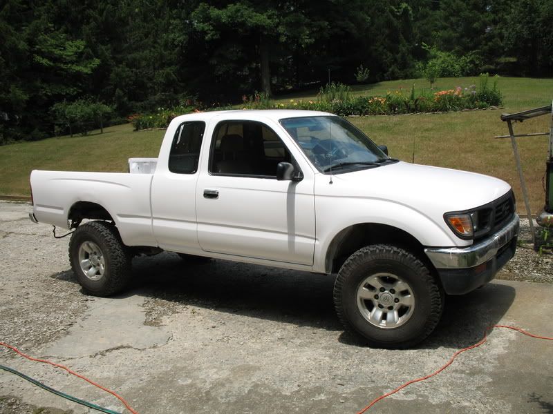

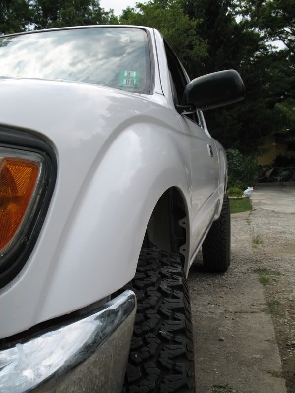

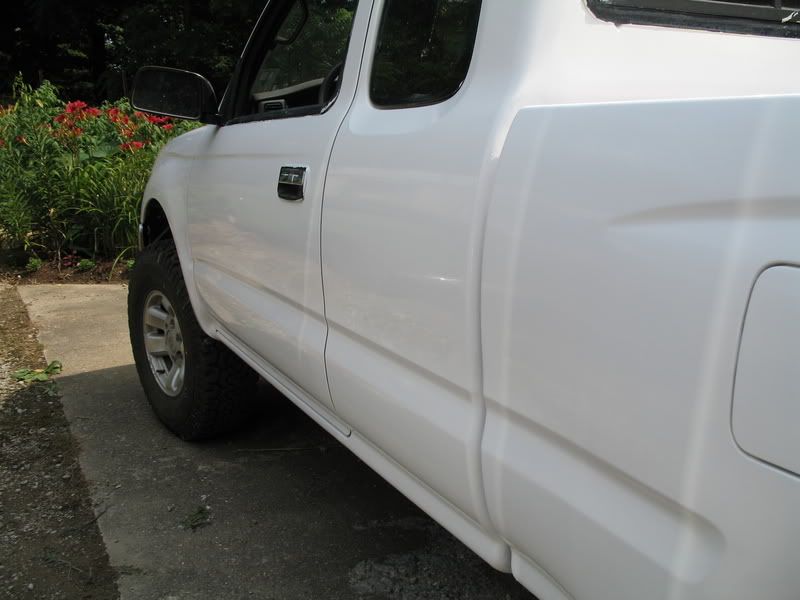

After:
Please excuse the rear fenders they were my first attempt at body work. Had to chop out some rather large sections and weld in new sheet metal. The bondo doesnt look all that great but I have some fender flares which hide it pretty well.

Looks awesome man! Some black flares would really make it complete.
1,252 Posts

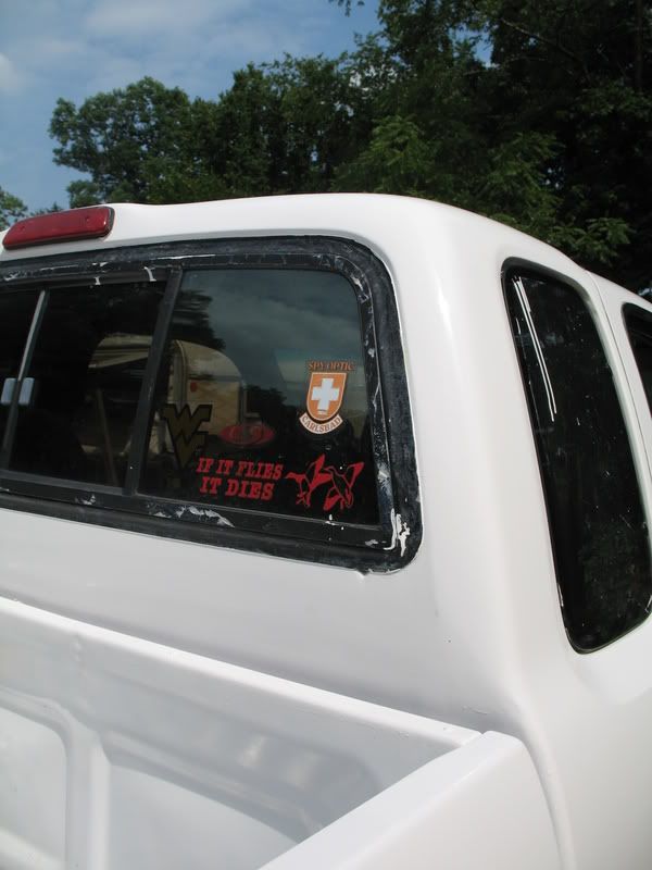

looks like a pain to get all the paint drips off of the moldings! good tip for glass is to use 000 grade steel wool, i use it to get primer clear and base off of windows also works good for metal spark marks
looks like it came out pretty damn well, although great choise in color for a roll on paint job white shows nothing!
1,501 Posts
Damn, that looks sweet! Nice work!!

I just finished cleaning the windows about 2 hours ago. I used steel wool on the windshield and main windows. I used this spray paint remover stuff on the extra cab windows and the back glass it worked really well. The steel wool seems to work on the rubber trim as well. I need to get some goo gone for the rubber around the back window. The masking tape I used left a lot of residue. Thanks for compliments.

wouldnt it have been easier to remove the glass?

Oh yeah I did have the extra cab windows out to spray paint around them. I was driving it in between coats so I didnt really want to leave my windows out for the 2 weeks I worked on it. The runs on the glass cleaned up fairly easy.
