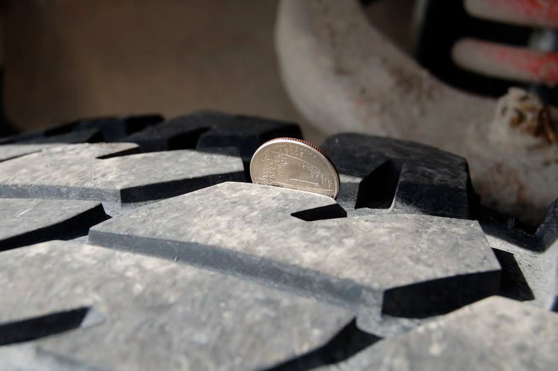

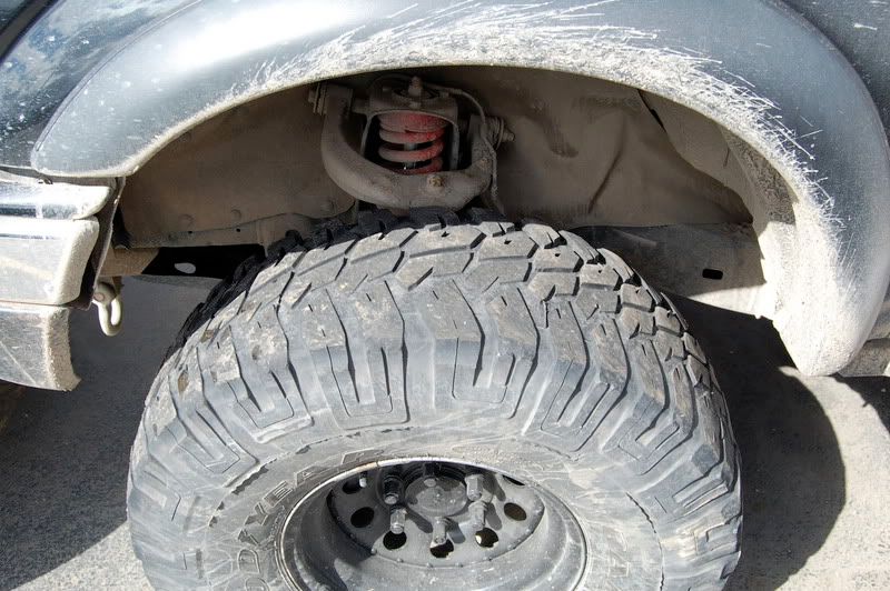

I am new to having mt tires on a vehicle so I have a question about my Goodyear MTRs. My front tires are worn pretty uneven as far as my newbie eyes can see. I thought I read something on here about the mtrs having a problem with this but I could be completely wrong. It is only the front ones that are like that. The tires were on the truck when I bought it and I dont remember when the guy said he put them on. All of the tires are at least 50% worn if I had to guess. Here are some pics, maybe one of you guys could say what would be best to do; rotate tires or replace them.

get an alignment, it looks like you have some alignment wear on the front tires. your close to needing new tires, i would say not to rotate your tires just becuase it is good to have the best tread on the rear axle. but if you feel you must, you can rotate the tires to geat a little more use out of them.

If it were me I'd just go ahead and get an alignment and some new tires and be done with it.

I'm thinkin' new tires. An alignment with tires in that bad of shape isn't going to help.:2cents:

You are certainly going to need an alignment sometime, probably after new tires. Youa re getting uneven wear up front, sitting on the outsides of your tire.
