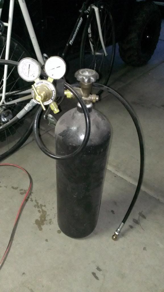

I have a CO2 setup that I was thinking of converting over to Nitrogen. Doable do you think? I know I'd have to revalve it for filling with nitrogen. It's a steel tank so I don't see why it wouldn't work. I won it in an AZ Rocks raffle and have never used it. Carlos even customized it for me.
Bottle, regulators, hose, ends, etc...I built my own using top quality components. Virtually new with full tank. $300 obo
Example, though my tank is bigger and no case.
Tanks should be identical, the regulators would be different due to much higher pressures with nitrogen I believe. .02
CO2 and Nitrogen use different CGA fittings for the regulators. Just get the right tank and reg.

Primarily, CO2 obviously shouldn't be used on shocks, in addition, Nitrogen molecules are bigger, meaning they leak down slower if you have "imperfections" from wheeling.:D

Well the first regulator stage will be, that's fer sure. However, I've been known to cobble those too. I took and old welding regulator and changed the spring for use with a nitrogen tank. I used a chevy small block valve spring that I cut down to fit. Yeah I know it may have been shade tree but it did work. LOL
The tank fitting on both sides will change too.
