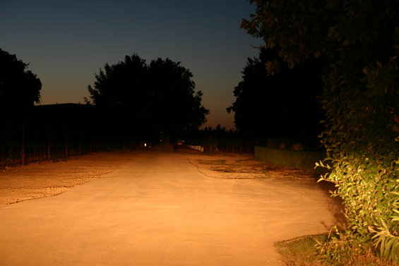

low beams
high beams
Pair of IPF 968 converted to 50 watt HID
Me likey!

Front view
First I had to make a little room for the bulb. I made a notch with my dremel for the bulbs rigid wire.
Then I had to make room in the back of the light.
I mounted the balasts under my rack.
I got these HID conversions off ebay from Blinglights. Just search for 50 watt HID. They are pricey but much cheaper than the Lightforce 50 watt HID lights.

I also have some hella lights on the way to be converted too. Both flood and spot. I will have 3 pair of lights (spot, driving/spot, and flood) in front with 50 watt HID in each and a pair of flood lights in the rear converted to the normal 35 watt HID.

i gotta tell you guys.been friends with this fucker for years.he does some good work when he puts his mind to it.the pics dont do these lights justice.bright as hell.now im going to do it to my hella 500 spot/driving lights.doubt ill do the 50watt,probaly the 35 will be good enough.

What are your thoughts on water resistance with that kit and the whole conversion process? Are you planning on doing some extra waterproofing or do you think it's pretty solid as is?
I would love to convert my IPF's to HID, but I'm worried that the balasts will be destroyed at the first serious water crossing (I have my lights on my ARB).

I was wondering the same thing about its resistance to the elements. Are they waterproof or resistant? Do you think they can be modified to have longer wires to relocate the balast to a remote location?

I have VisionX HID replacements for my headlights and the ballasts are mounted right behind my grill. They are constantly exposed to water in the rain and on the trails and they have not failed me yet. They have been on there for about 3 years going strong.

im pretty sure hes going to silicone the holes to prevent any water getting in.
