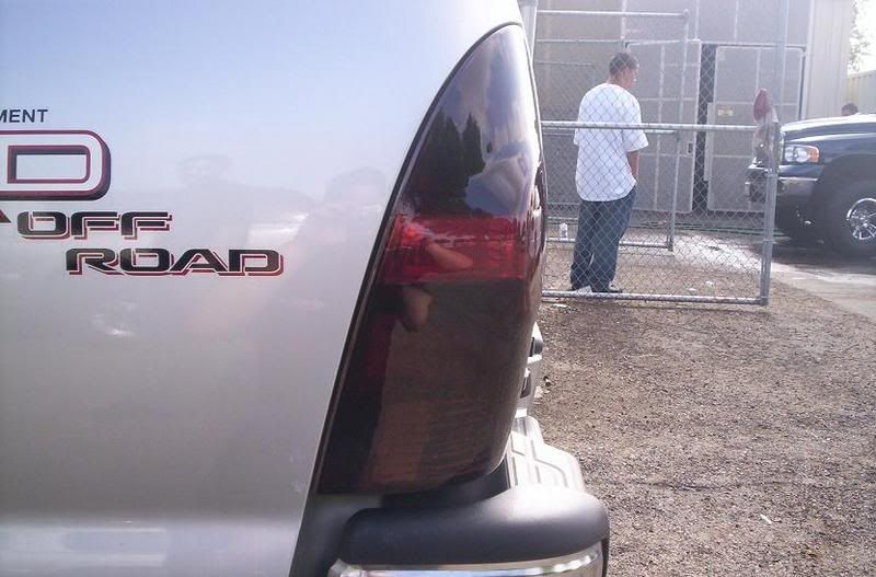

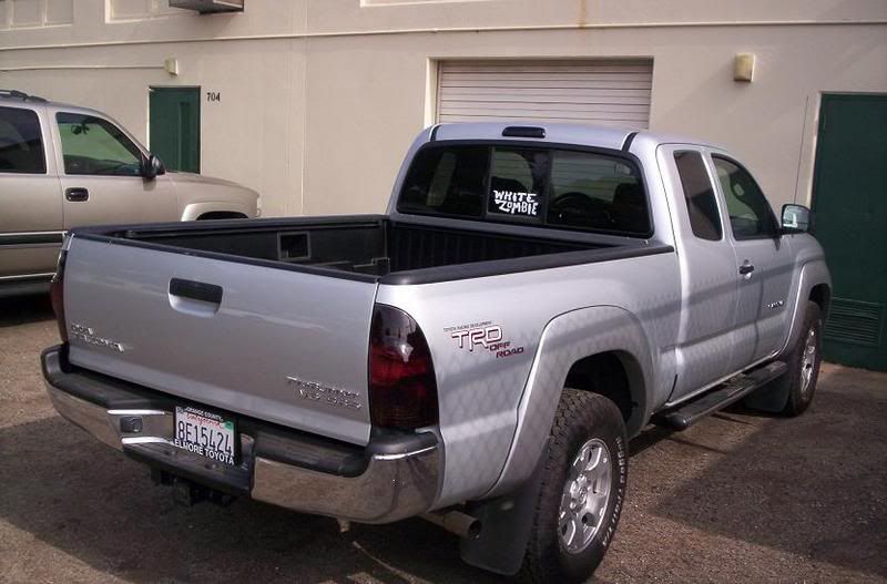

for those of you who saw and red my last post about my tinted tails, they came out good, but not glossy, and while trying to wetsand them/buff them with my new buddy Tim, it went right through the little clear coat. so we decided to sand off all the tint, and do it the right way.
for most of you people, you would have to do it the way i did before, but just put on the clear coat wetter and thicker. but we sanded the tails to 1500 grit. masked off the center, just like i did last time. and used automotive clear, mixed with a bit of black toner. (all of this was in a paint booth, so it sped up the process). here are some pictures
new
old
the rest
in the paintbooth

you could wetsand them down, no more then 800 grit i would say. and work your way up to 2000-2500, and clear coat them (heavy and wet) wetsand again, and then buff/polish
